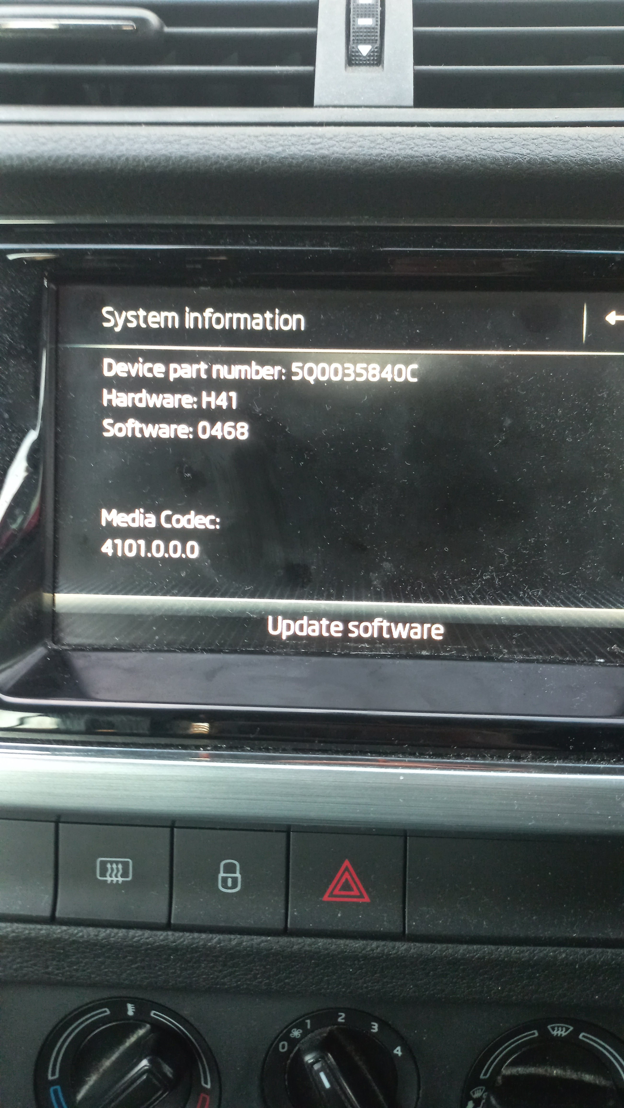

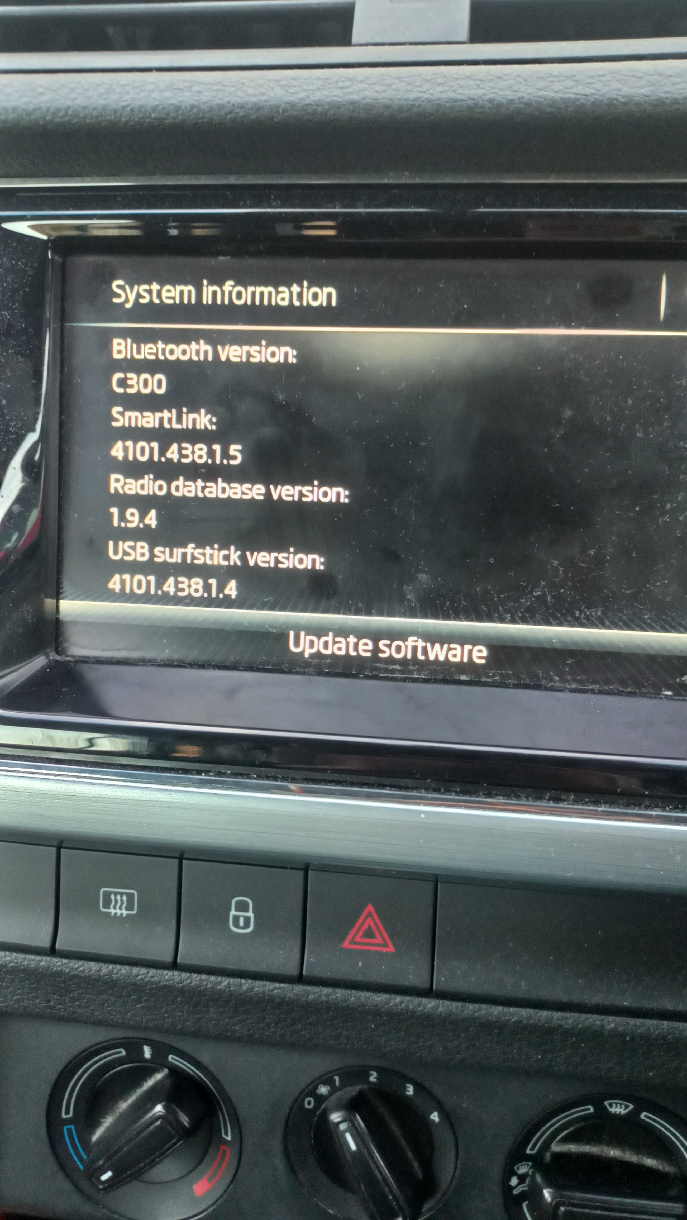

Pls share either part number and current SW version (can be checked in menu SETUP then SYSTEM INFORMATION) or VIN (so I can check part number by myself).
Sorry for taking so long to get back to you!
I sent you download link for MST2_EU_SK_ZR_P0480T in PM.
