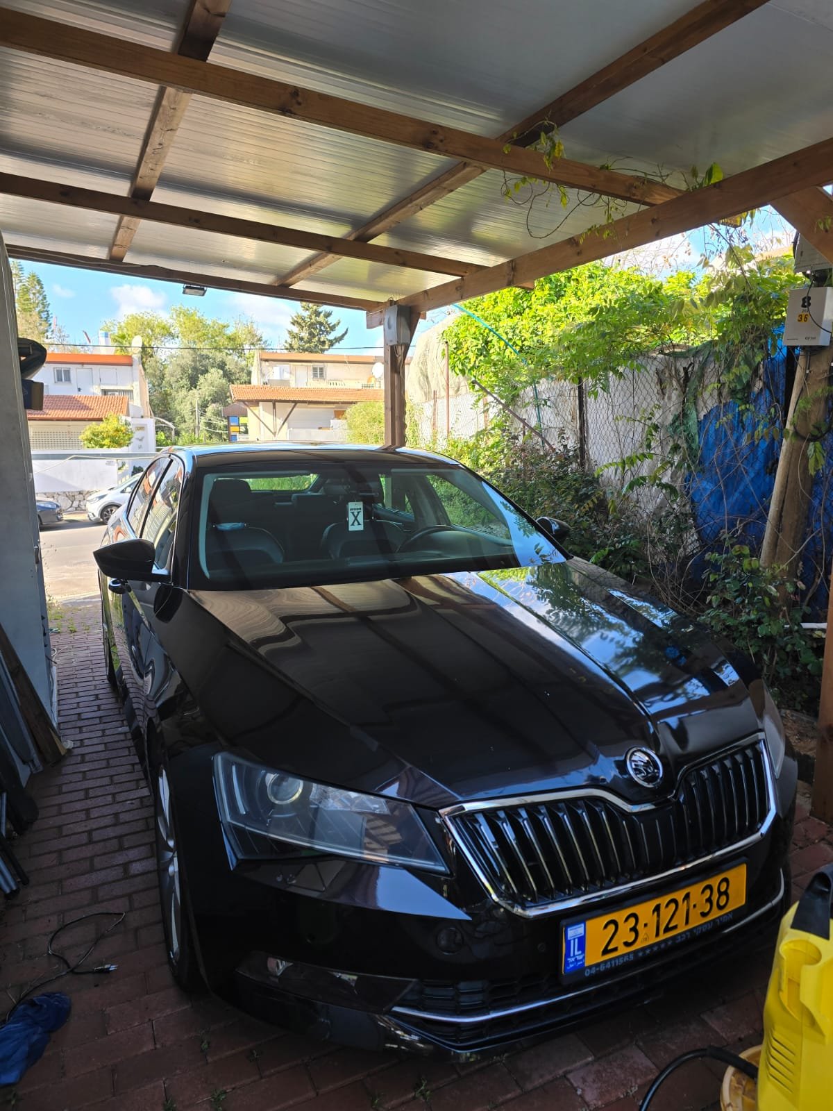

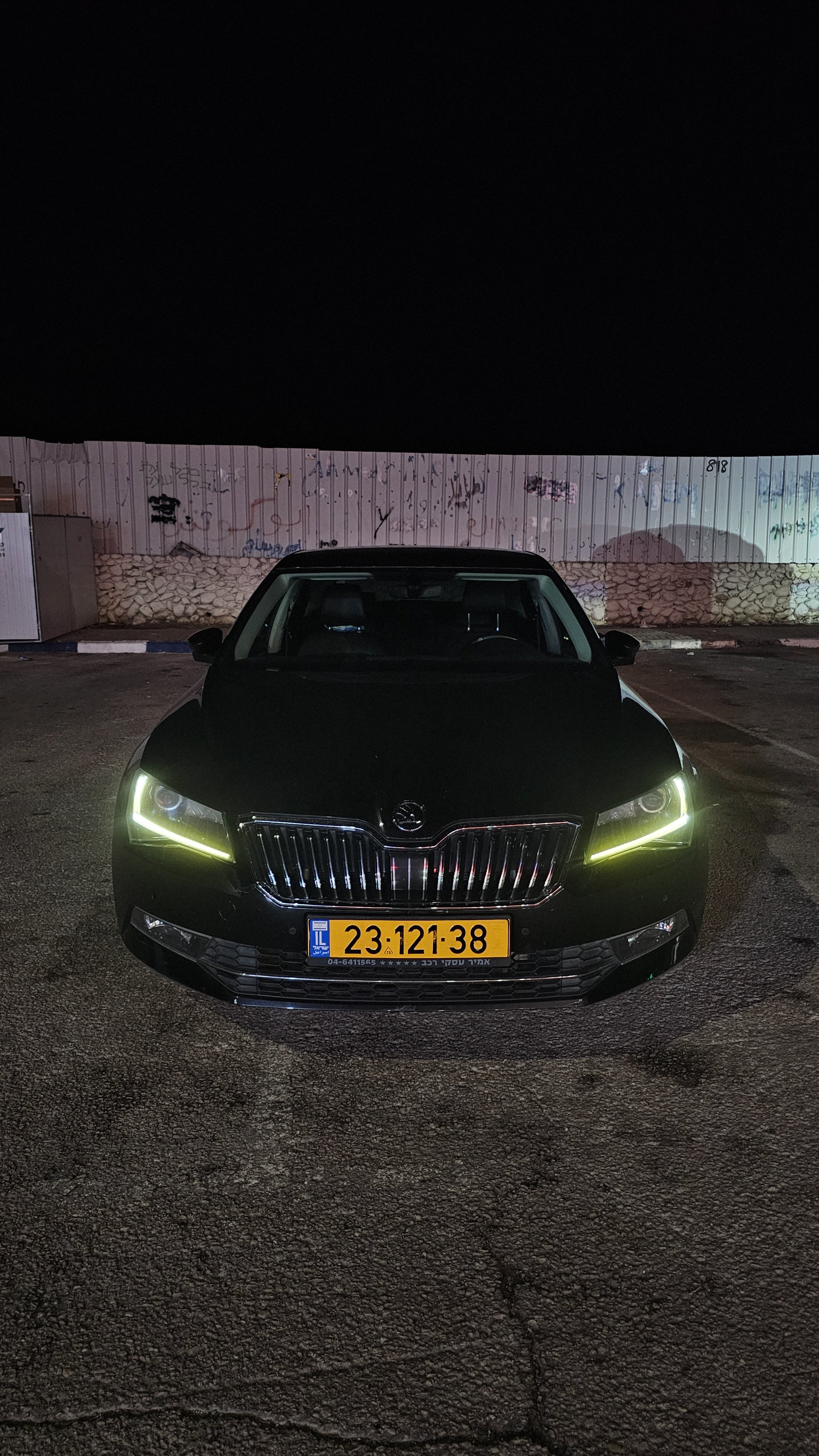

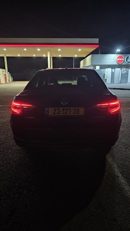

I have the skoda logo and not the lettering, also here is some pictures it might help
@LinoTheFox - as @travs indicated - urs is a mk3 pre-facelift Superb. MY15 to MY19.
mk3 Facelift arrived MY20.
mk4 Superb has just been released.
MY15 to MY17 can't do easy entry.
U need MY18 onwards for that.
