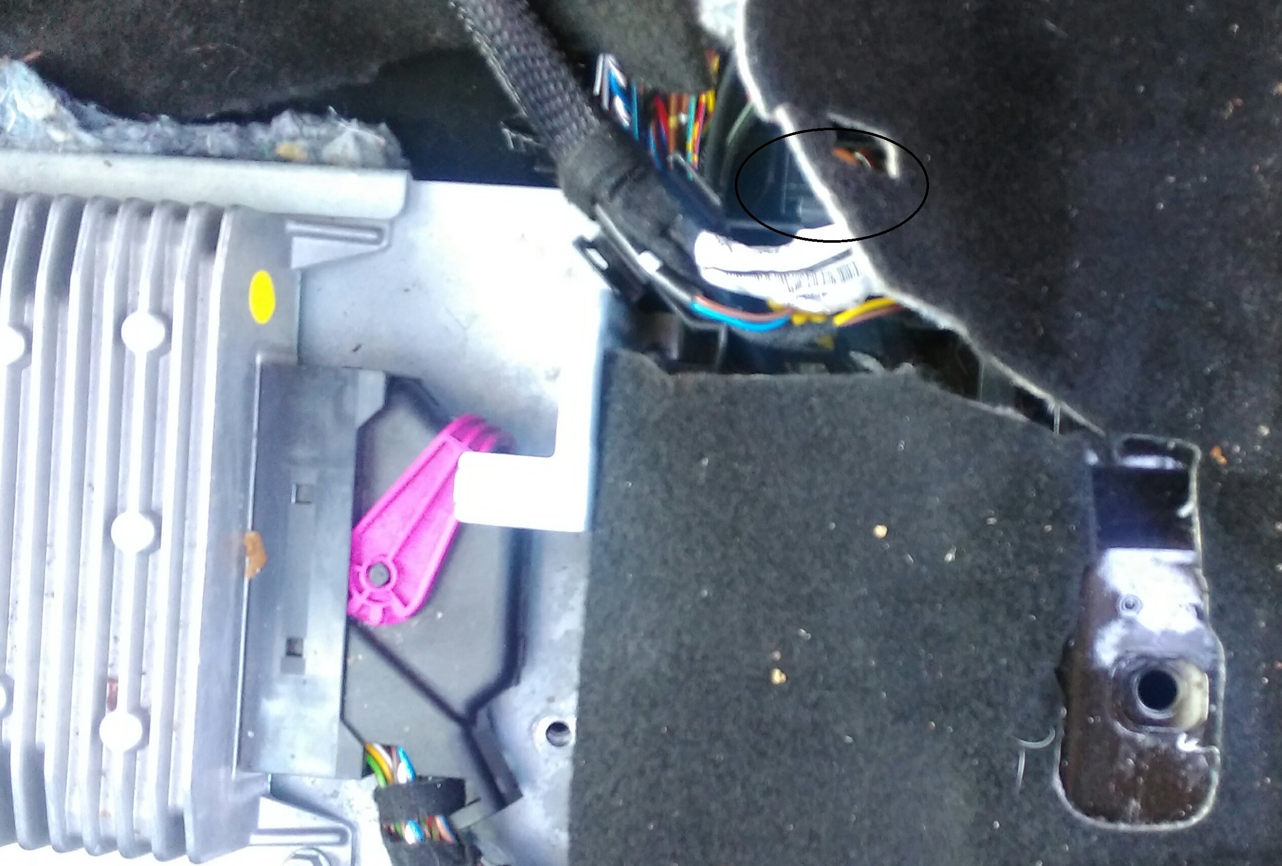

Affirmative, I had mine replaced because it was fried after water had come in some years ago. I paid about € 20 for it back in 2017 (a Chinese one still functioning today) See here

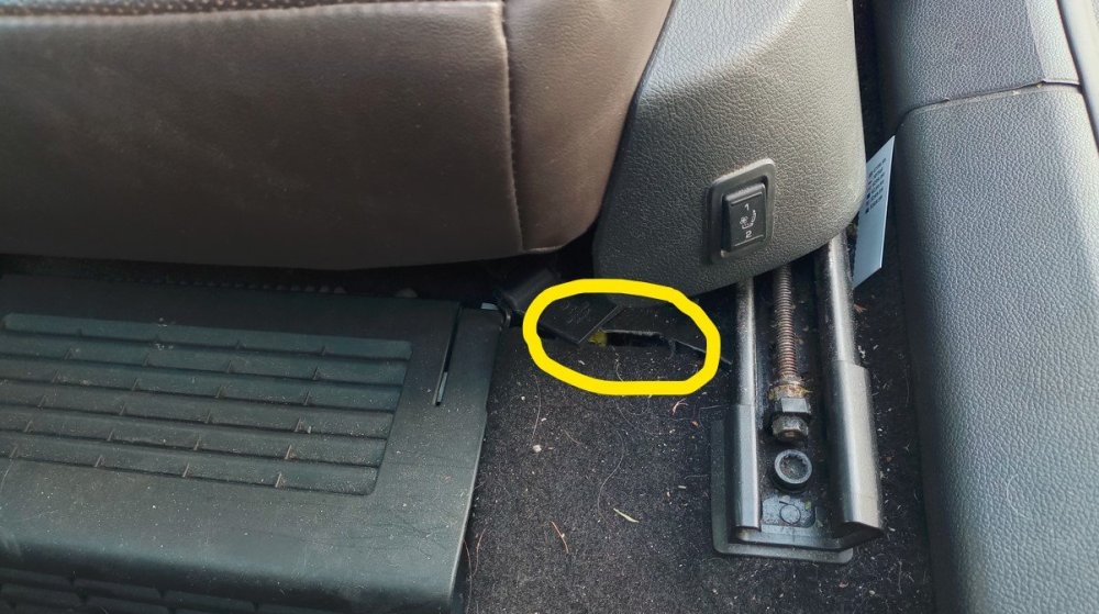

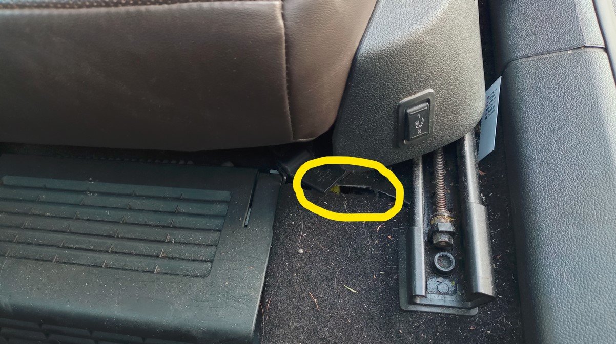

Hi and thanks for your interest in this, I have been told that on my model this item may well be under the carpet on the near side (UK MODEL) passenger seat. So can you tell me where your unit was placed and did you have to cut the carpet to fit it?
Many thanks D4KGP.
It is located where the wire loom of the seat vanishes under the carpet. just move the seat to the end rear position and dig it out 😉 FYI, my car is LHD
