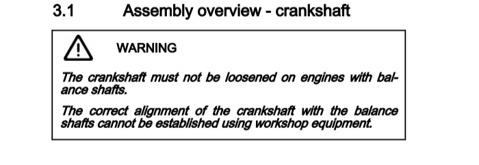

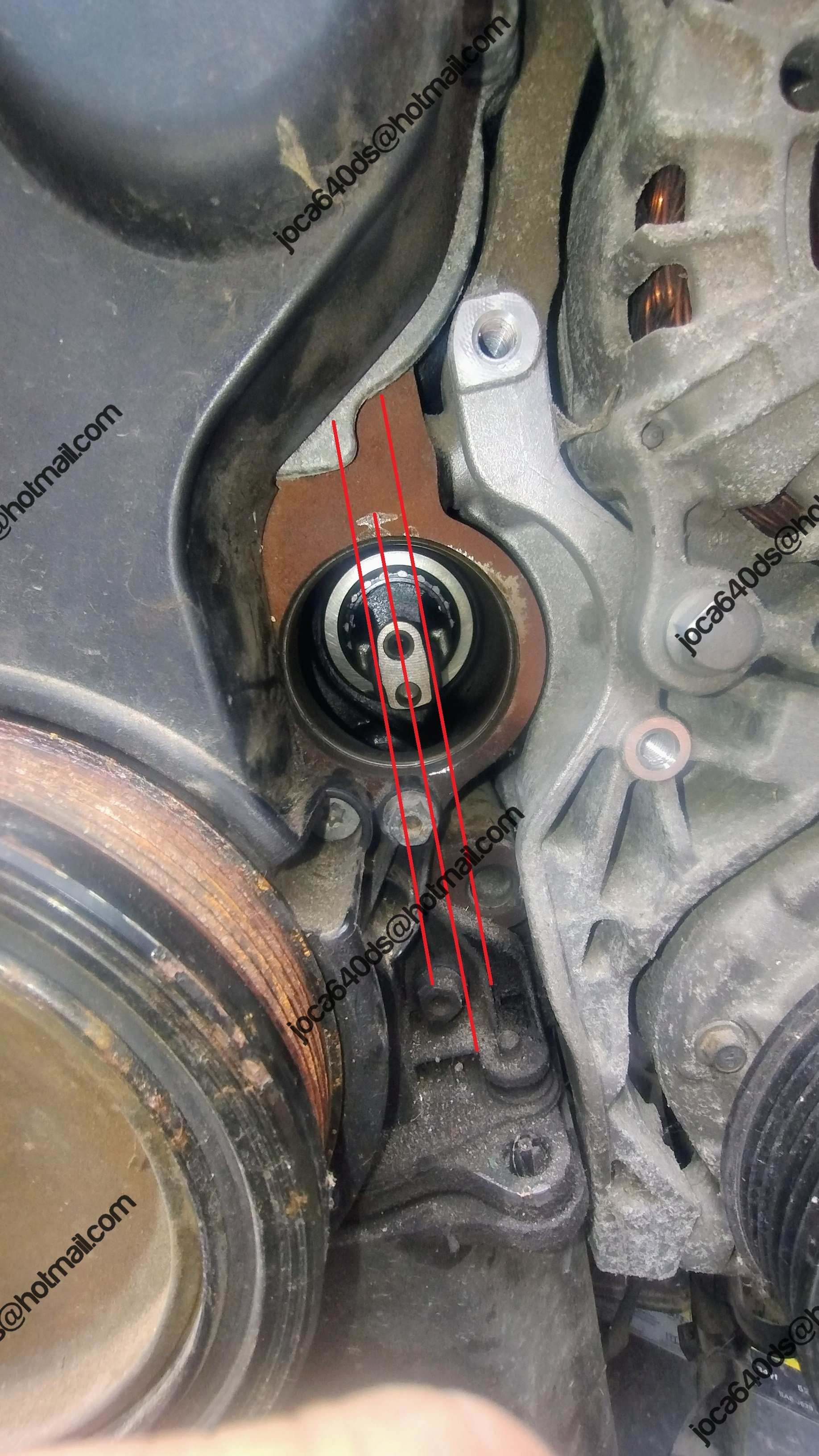

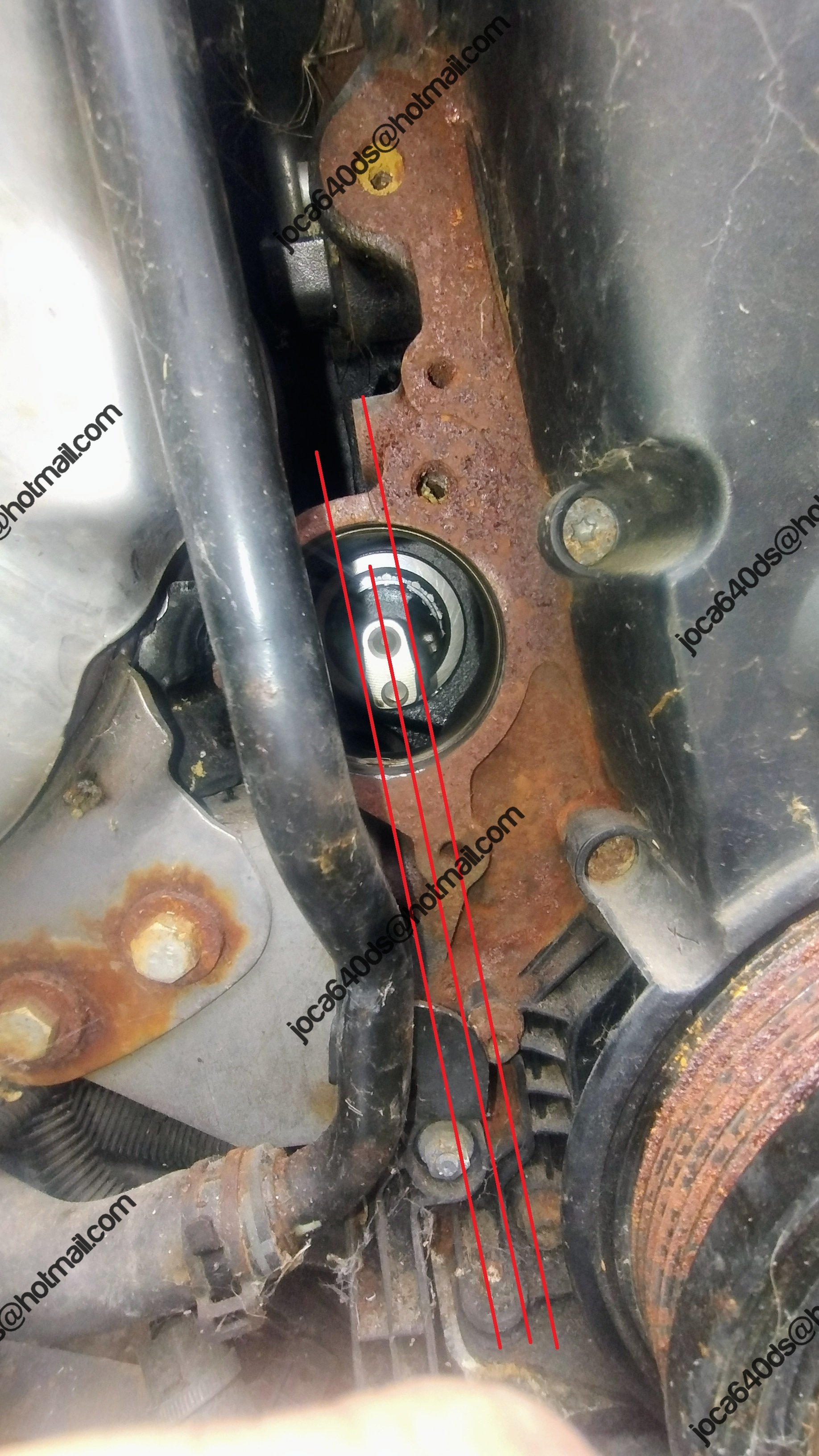

I had a lot of trouble finding this info that im sharing, i spoke to 10 mechanics and vag specialist no one had this info.
This info is from car that has 150k km and engine has never been dissasembled, every 2.0 tdi passat, arteon, audi is the same crankshaft and balancer shafts

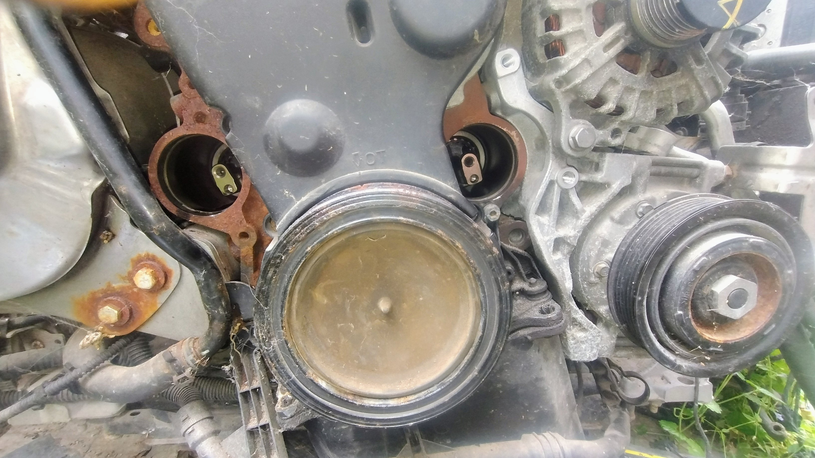

I setup crankshaft exactly the same as on photos, if you cant put balancer with 2 sprocket exactly just lift crankshaft and turn it 360 deegres till you put it at exact position
Cap oe number 04l 103 113 a
Engine at tdc marking on cover
