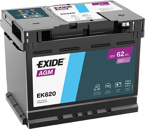

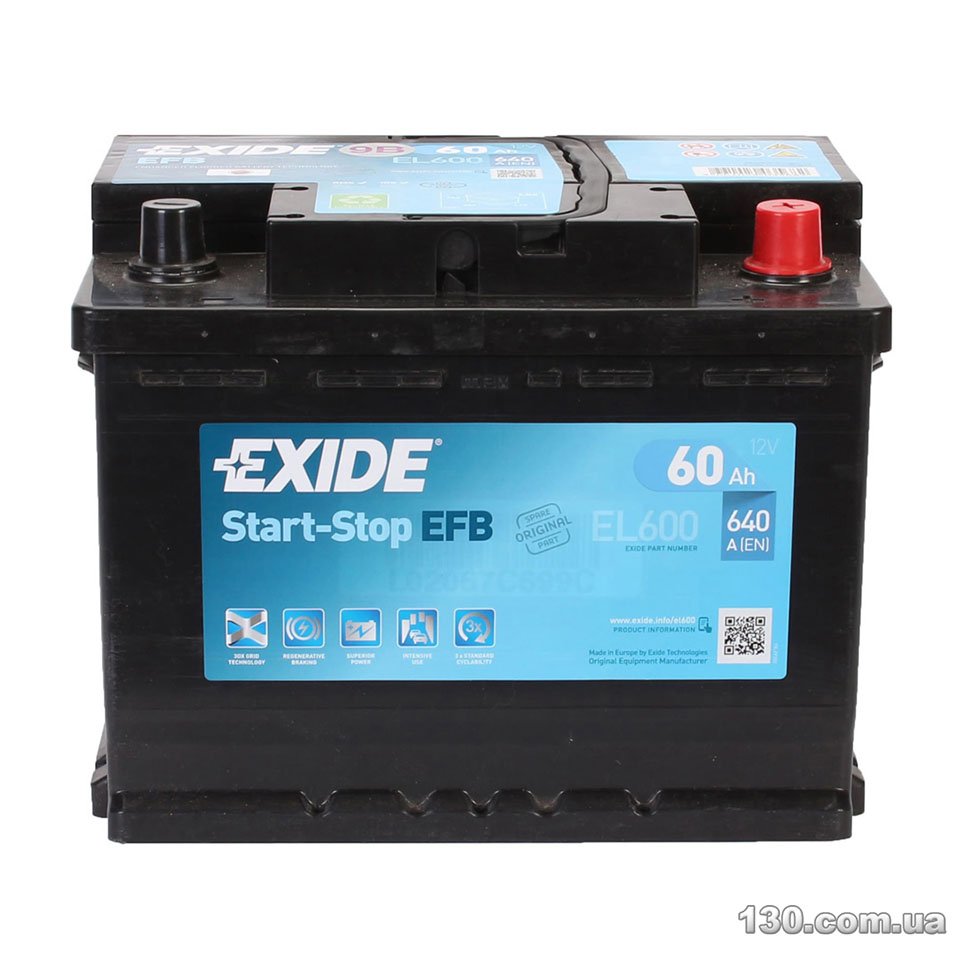

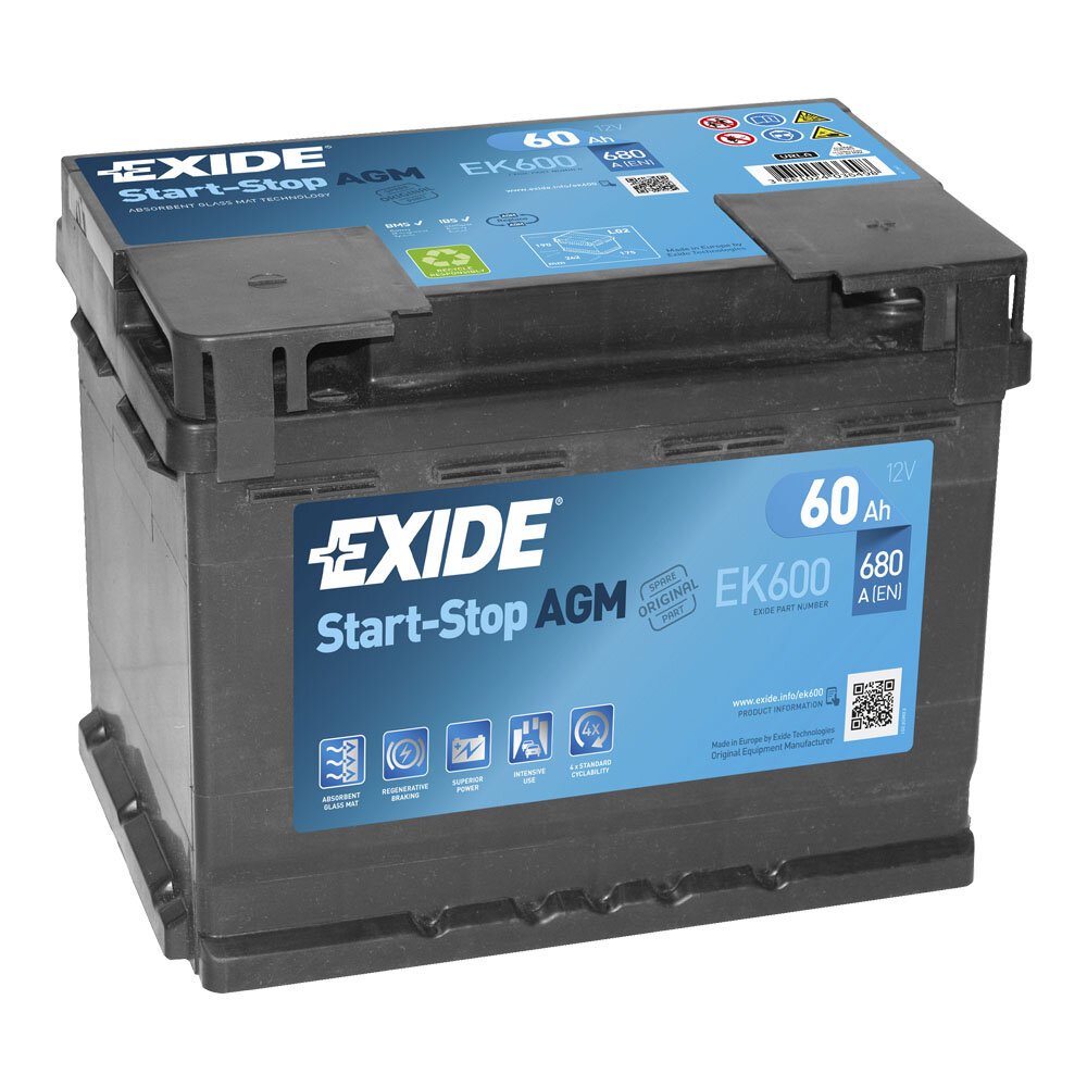

exide efb for my car is 130€ in my country.. AGM is 160€. takling about 60 Ah
maybe i put AGM next time. what do you think. ofc decoding in odbeleven.
or this, 62 Ah thats with new stickers
Edited by imart143
We see very few EFB + battery here I have no idea if VW even have a coding for such, OBDeleven might but that is not the same thing.
