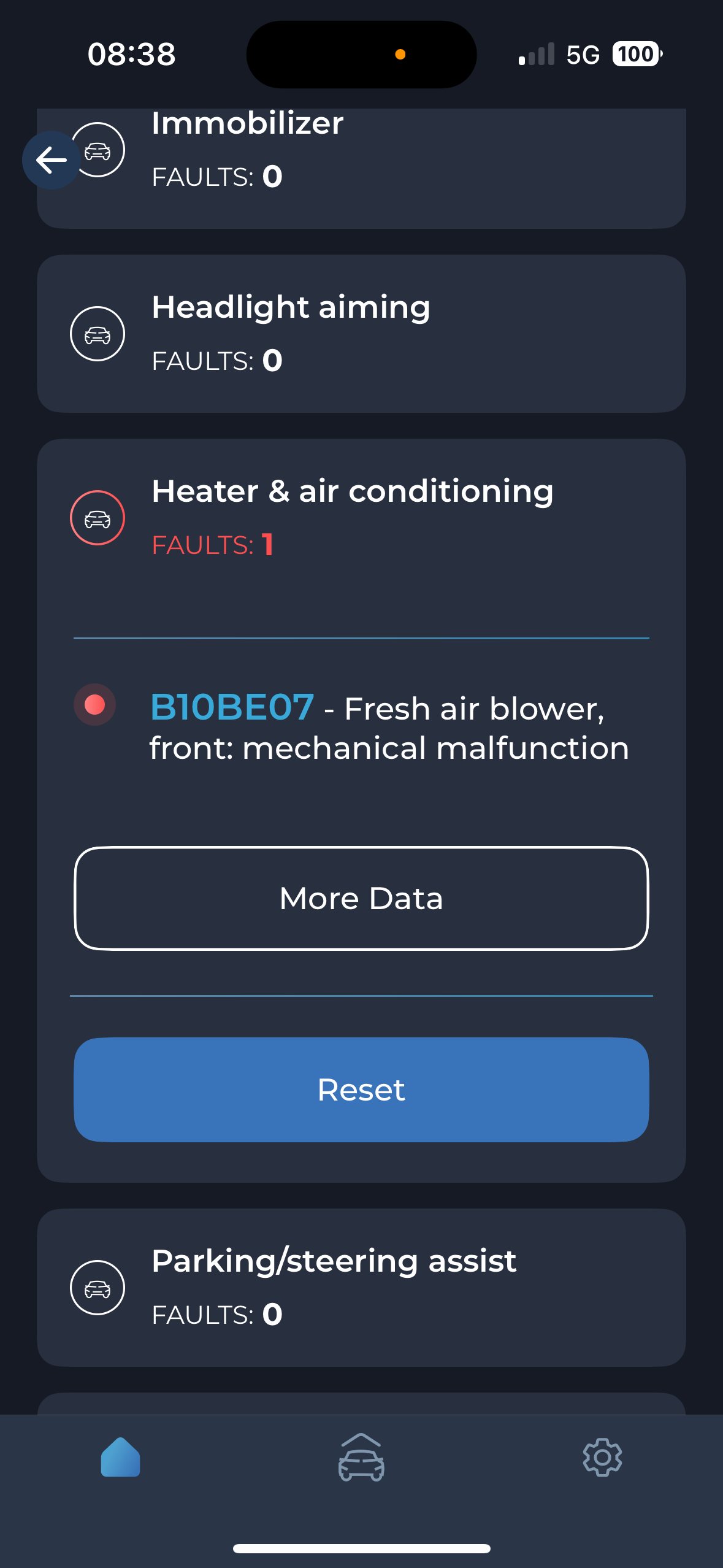

The air conditioning on my 2013 Superb diesel estate suddenly stopped working yesterday. I’ve had a look at it this morning and the issue seems to be the heater fan not working, as Carista reports:

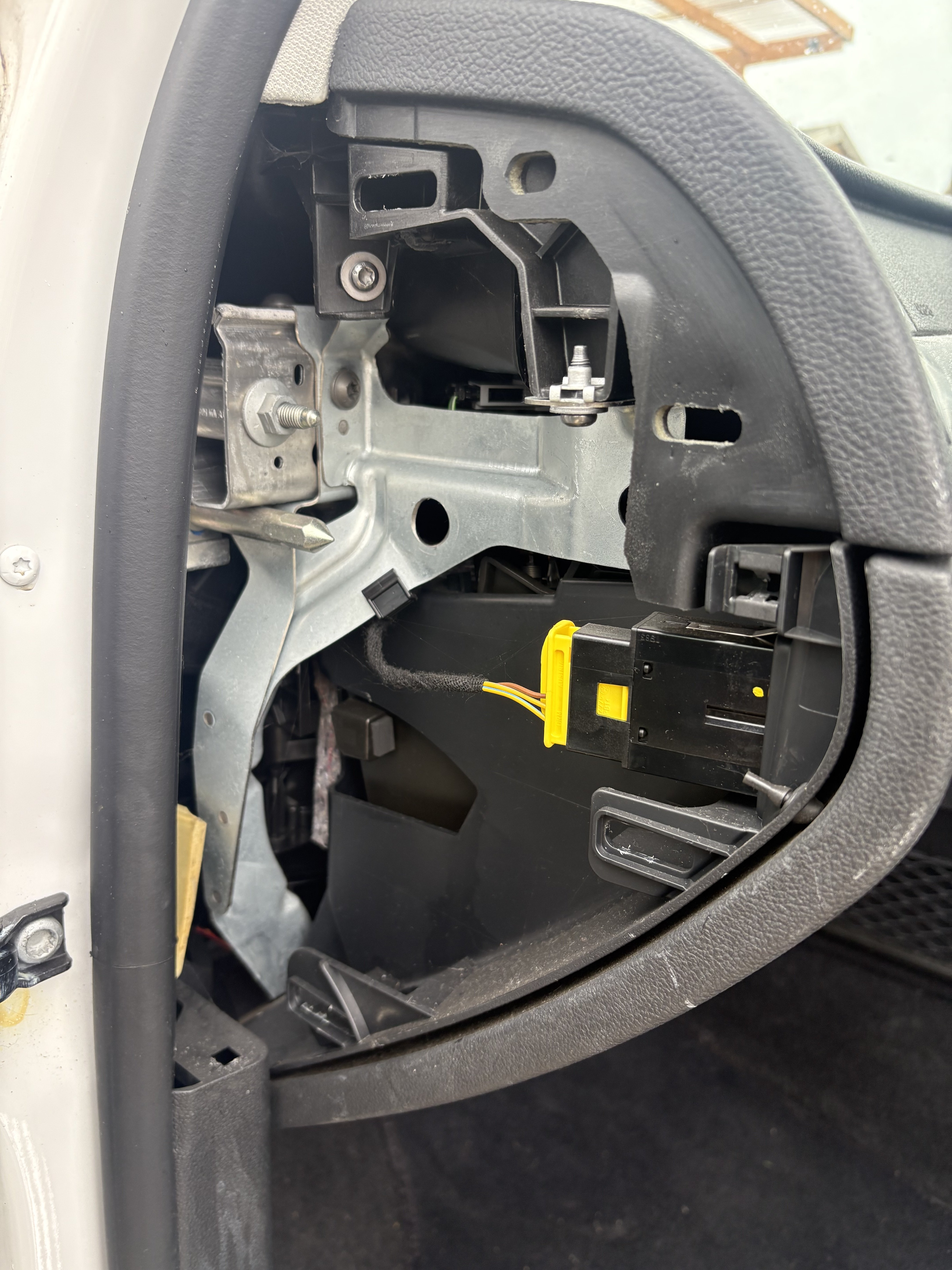

… the first thing to check should be the fuse, the handbook says it is #22 and situated behind a panel at the left side of the dashboard. My problem is the fuse box doesn’t seem to be there on my motorcar:
… am I being very dim, or has Mr Skoda changed the location for the fuse box but not updated the handbook? This is probably a really simple issue, is anyone able to assist?

Try the other end. Possibly a LHD-biased handbook.

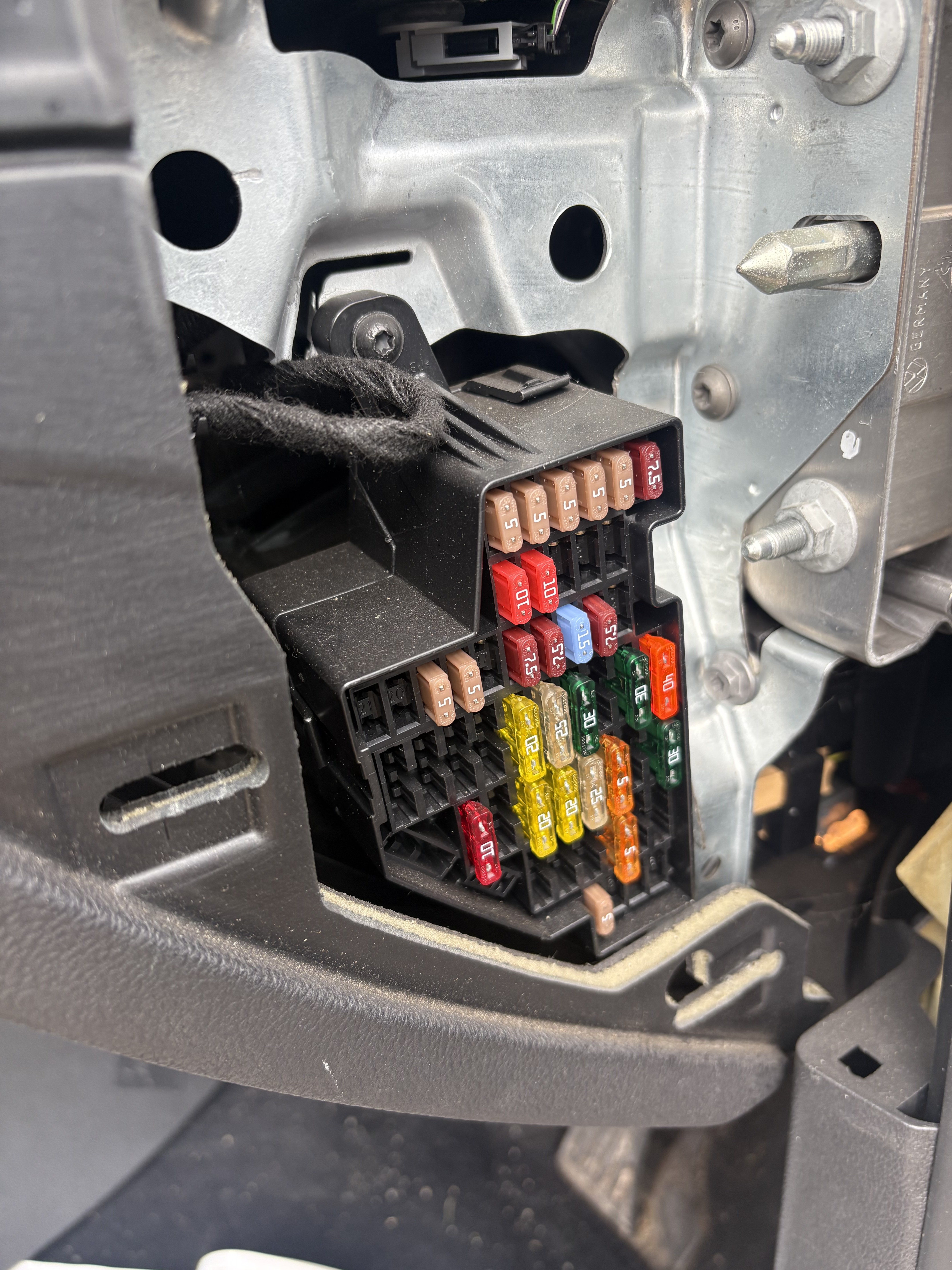

Many thanks - you are exactly right. I was dubious about opening that end because it has an air bag warning on it, but gave it a go and hey presto:
… I’m guessing the fuse layout is a mirror image of the diagram in Mr Skoda’s handbook, so fuse #22 is that solitary 40A at the front on row #4?
I’ve checked that and it is fine, so the next suspect is the motor itself. Does anyone know where I may find it (I don’t have a workshop manual, only the handbook)?
Yes.
