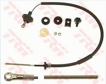

By the way: the first years of Εbay.cο.Uk here in GR many start buying items without paying attention to this, the first ''Oh No'' came from the guys which bought hadlights.
OE/OEM Part Number 6U0721335
Manufacturer Part Number 6U2721335D
The weird think is that they give some other codes for Skoda as
008 039 260
008 039 415
8039256
8039415
Mhe most expensive are sold as ''set"
The D of 6U2721335D doesn't tie in with Papez RHD 6U2721335A/E/G - the D still maybe for RHD I've no idea it's just about double-checking and cross-referencing aftermarket parts manufacturers and suppliers databases.
I've previously found with parts for my old cars that when databases are merged errors and omissions are not only merged but more errors and omissions from the merging.
As was put in the earlier days of eBay UK one supplier would just copy off another and so the inaccuracies grew, things are much better now but even car parts (and car manufacturers) databases had errors and omissions so nothing is perfect.
Often or usually things thing don't matter much until such as now you can't source the part or you are at the point of fitting the wrong part or have fitted it without knowing until something plays up again later. A parts manufacturer using the wrong material for an O-ring seal (2 in 20, units over 20 years error) can mean engine and/or gearbox out, again, guess how I know.
