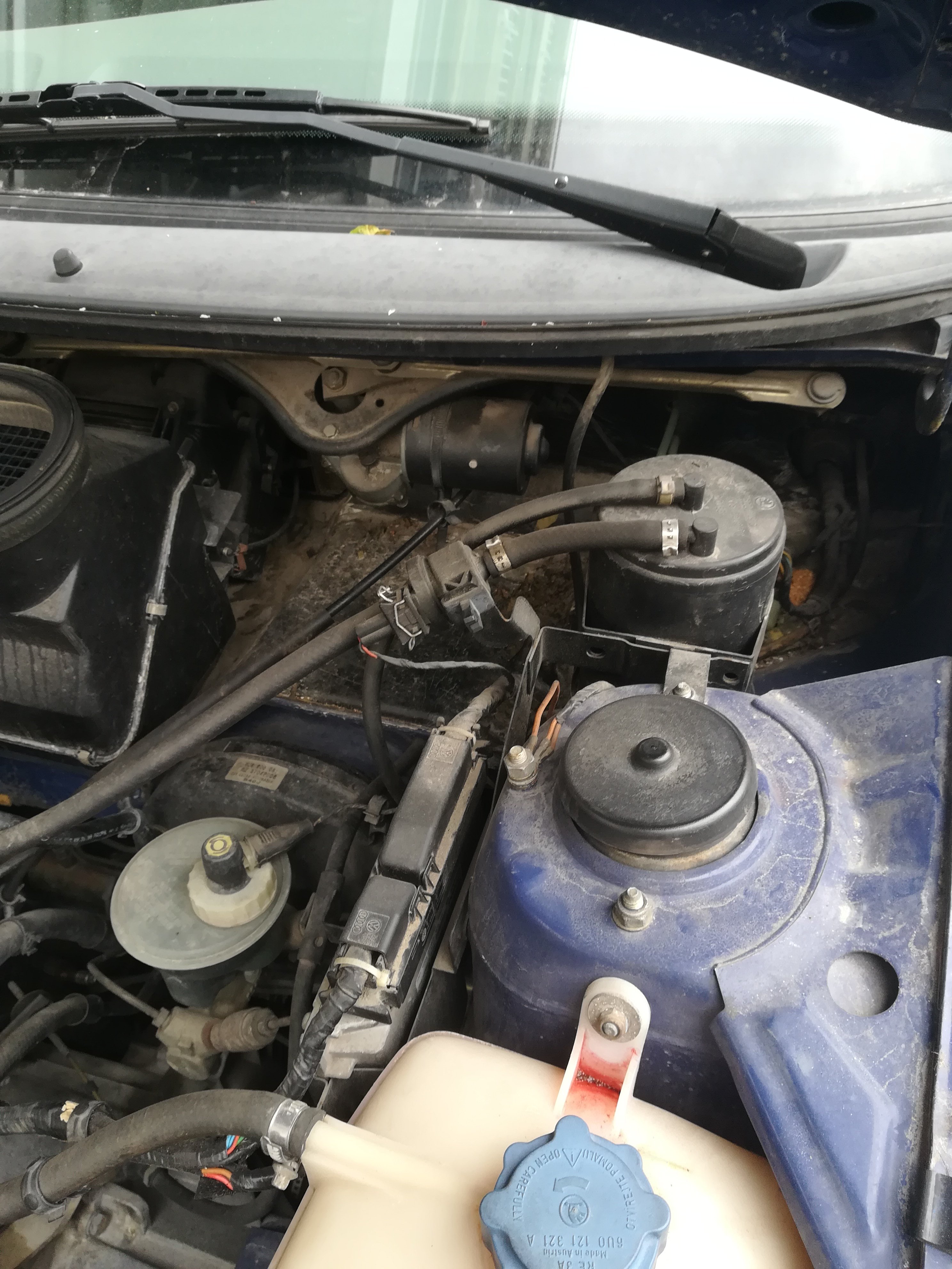

A) The first are behind the regulator pressure,i show them to you few days ago,easy access inside the engine bay.The others are metallic and beneath the car, you can't see them from above,you need a lift jack.
B)The charcoal canister, also known as a vapor or evaporative emissions (EVAP) canister, is a crucial part of a vehicle's emissions control system, particularly in gasoline-powered cars. In Skoda Felicias, it's designed to capture and store fuel vapors that evaporate from the fuel tank. These vapors are then purged back into the engine and burned when the engine is running and the purge valve is activated.

Here it is in Felicia,check all the connections.
So how would i know it's the canister?? Thats a silly question also the fuel pump gauge does the fuel pump when submerged have a locating point of just flaps around ?? Hence why gauge is odd ??
It's extremely difficult (almost impossible) to be the canister the culprit for the smell.
