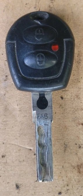

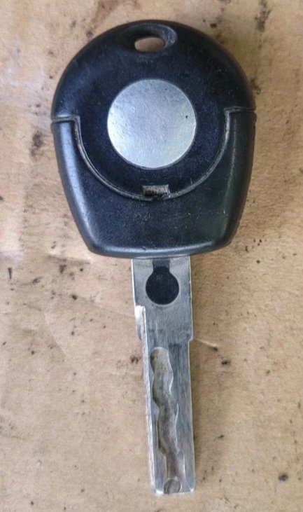

I've looked at the fabia keys on fleabay and all seems to show a rectangular key fob where I have a oval one. (Pic attached).
