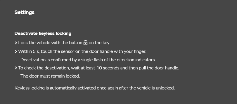

So I'm off to Silverstone for the F1 Thursday. We are camping so clearly I'll be next to the car with the key in my pocket for at least 4 days without starting the engine. How do I stop it 'waking up' everything I go near it? Thanks!

Thanks for the replies. I'll be constantly in and out of it so the Faraday has been ordered. Easier option that disabling each time!
