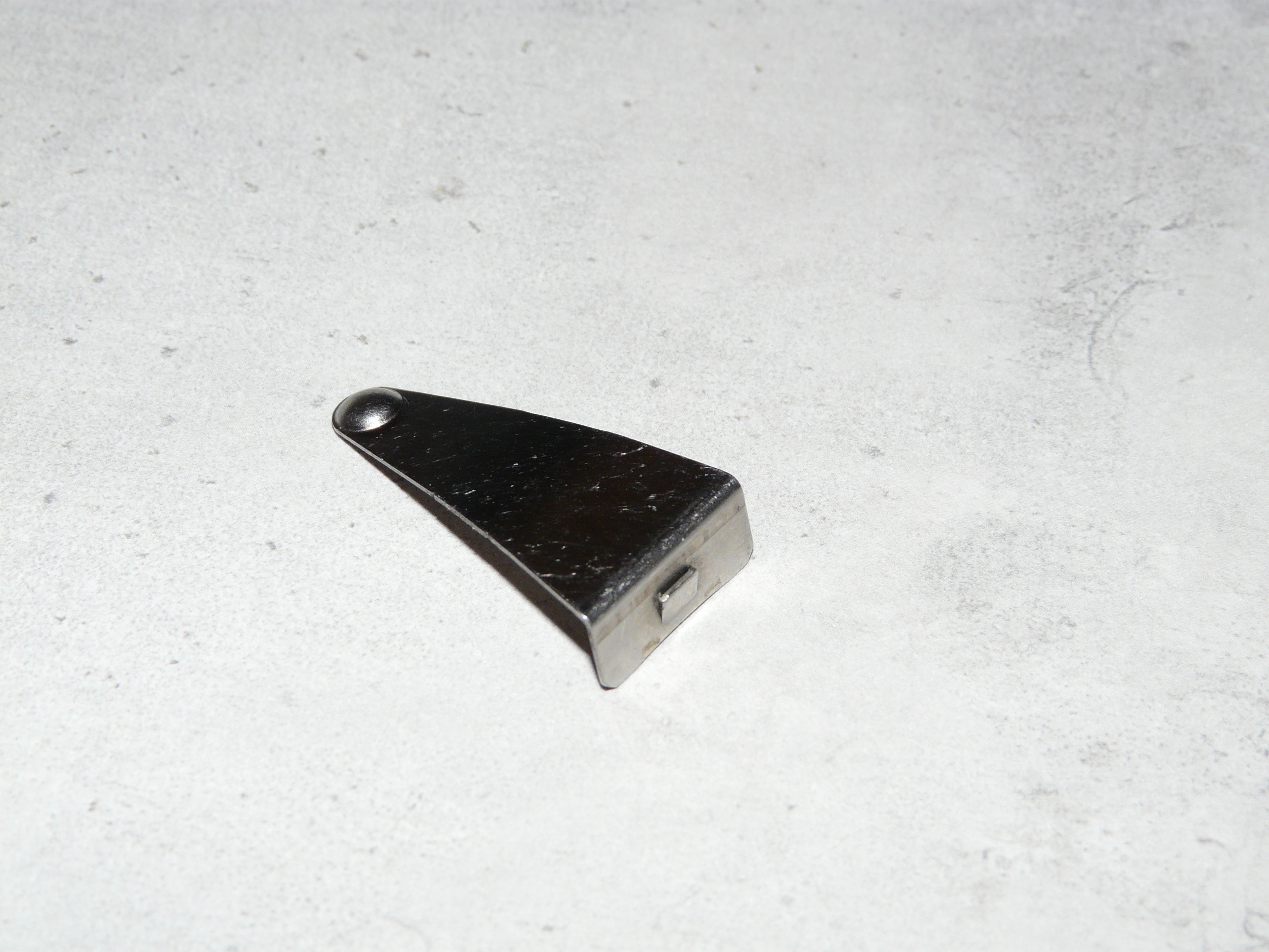

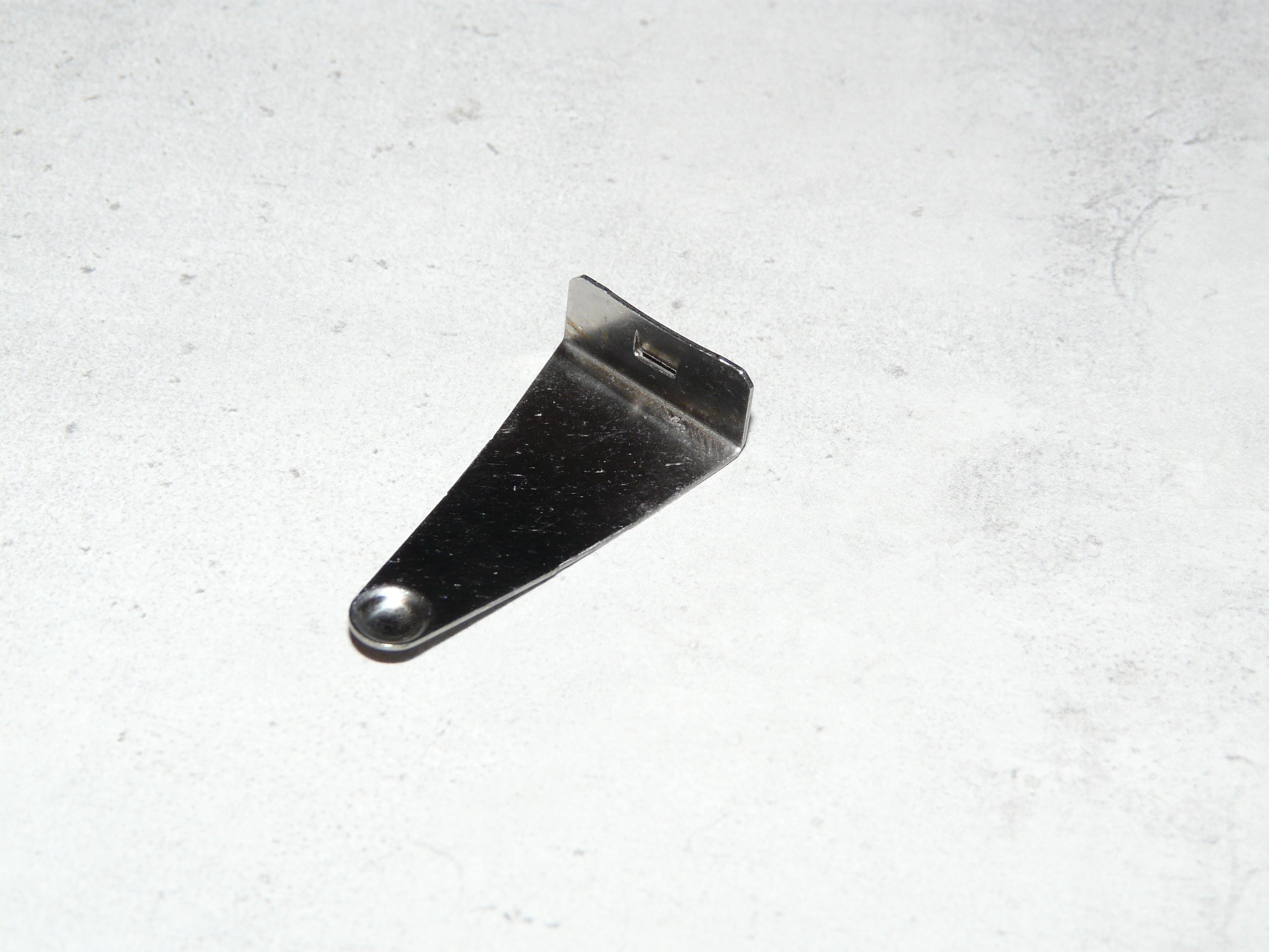

This morning, whilst driving, I spotted the drivers door mirror was vibrating and the image was a bit blurred.
On feeling the glass it was obvious that the glass had partly come adrift from it's backing pad, or mount or whatever it's fixed on to. It was loose and at speed the wind was causing it to shake/vibrate.
I've prised the glass away a bit ... enought to allow me to sguidge some clear silicone sealer/adhesive behind the glass, between it and the backing pad.
That's fixed it - hopefully for good. But in adjusting the glass left and right and up and downh ( using the internal electric motor control knob ) it revealed an errant object within the housing. It's a stainless steel clip 32mm long x 18mm wide with aun upturned lip about 7mm high. See photos.
Now that I've looked closely at the left hand door mirror it looks like the same clip is loose in there too. Although not as totally loose as the right hand one.

I just had better look on t'internet and can see mention of the clip but haven't been able see what it actually does.
Given that the mirrors both work and are in one piece I'm thinking it might be best to simply keep the clip in a plastic bag, somewhere safe, and carry on as we are.

Did you ever get to find out out what it did though?
It may well be damping the movement of the mirror, that would tie in with the issue that you were having - that is just an maybe logical,guess.
The issue I was having was fixed by my squidging sealant/adhesive in between the back of the glass and the pad that would originally had an effective self adhesive surface. By doing that it solved the wobbling issue when driving. The silver clip would seem to have come adrift and dropped to the bottom of the housing when I operated the motor adjustment knob and adjusted it up, down, left and right to the maximum travel ( something I don't usually do. If I hadn't done that I suspect the clip might not have come loose.

Just went up to ask my trusted indie man. He knew straight away.
It's just a stabiliser to stop any vibrations. Nothing to do with the electrics.
Maybe I'll try to remember to get him to replace it next time he has the car.
