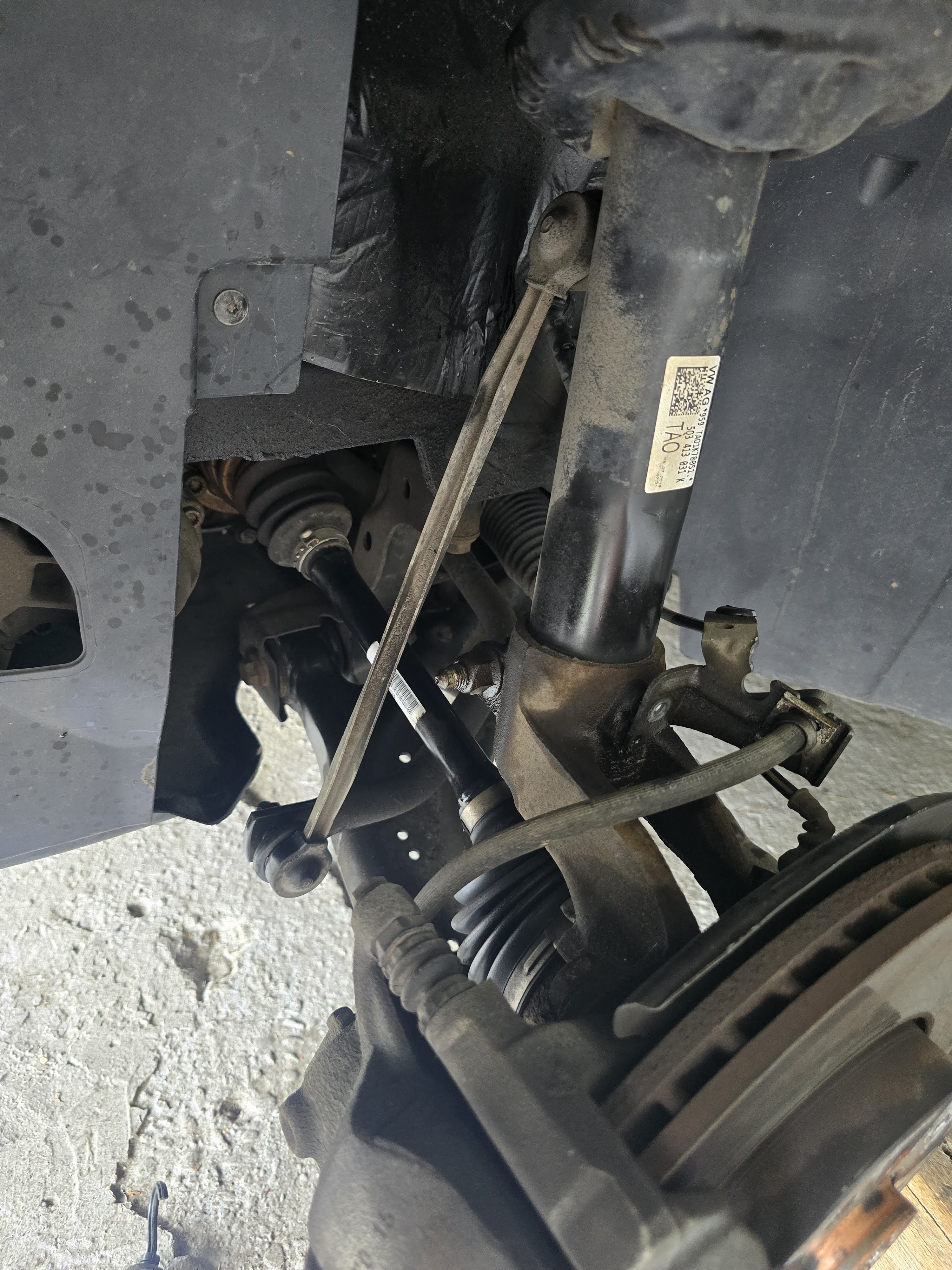

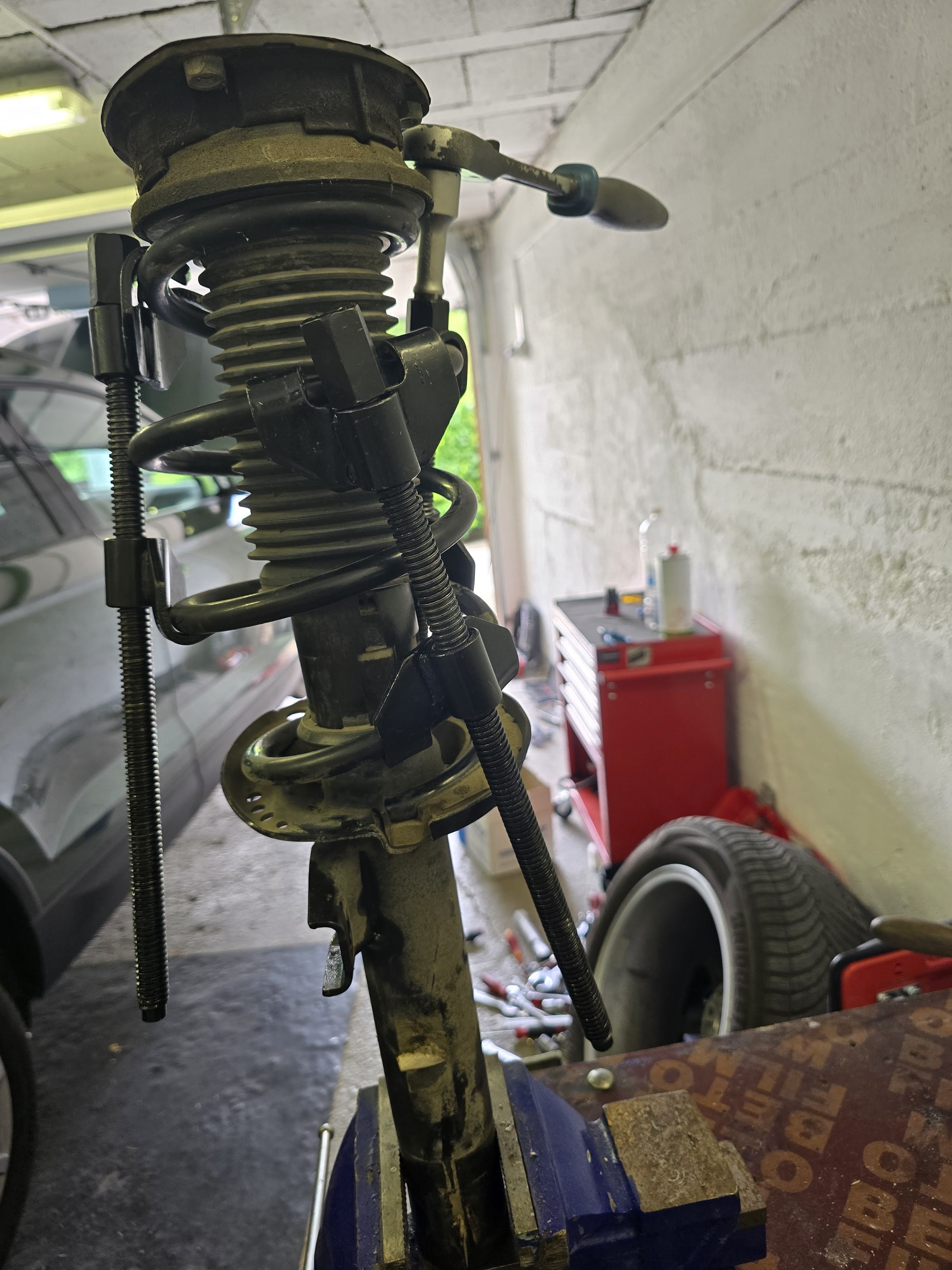

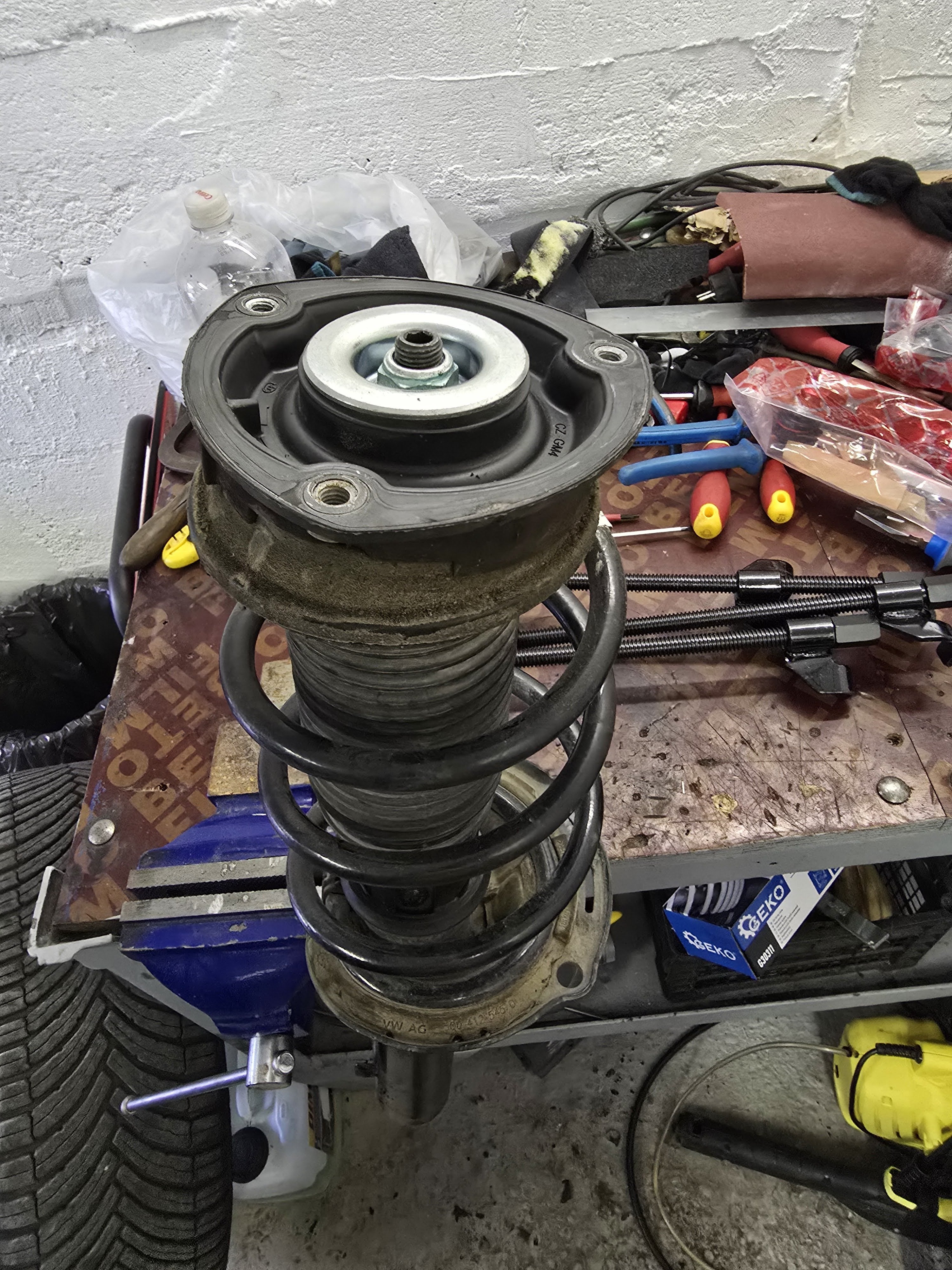

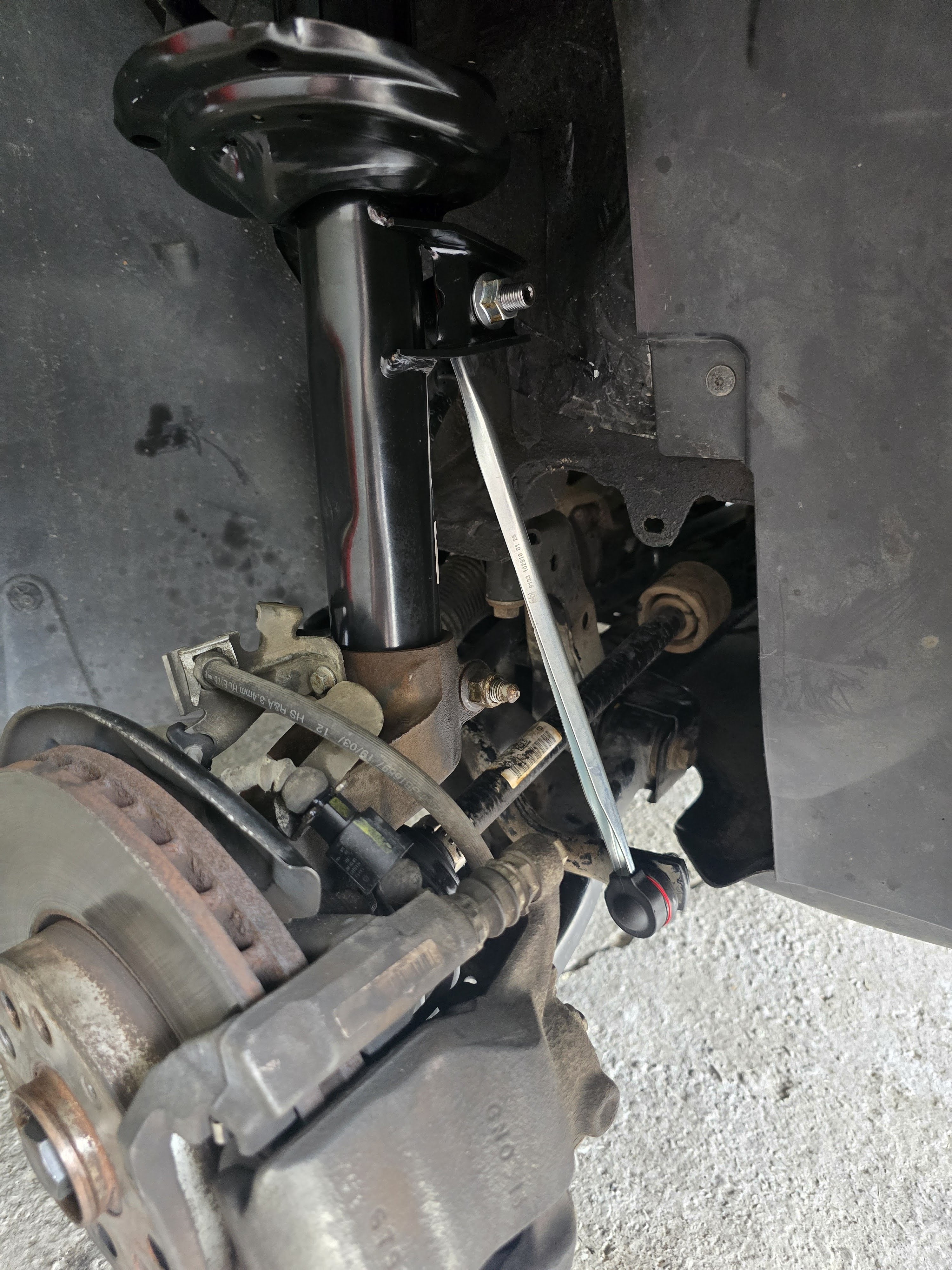

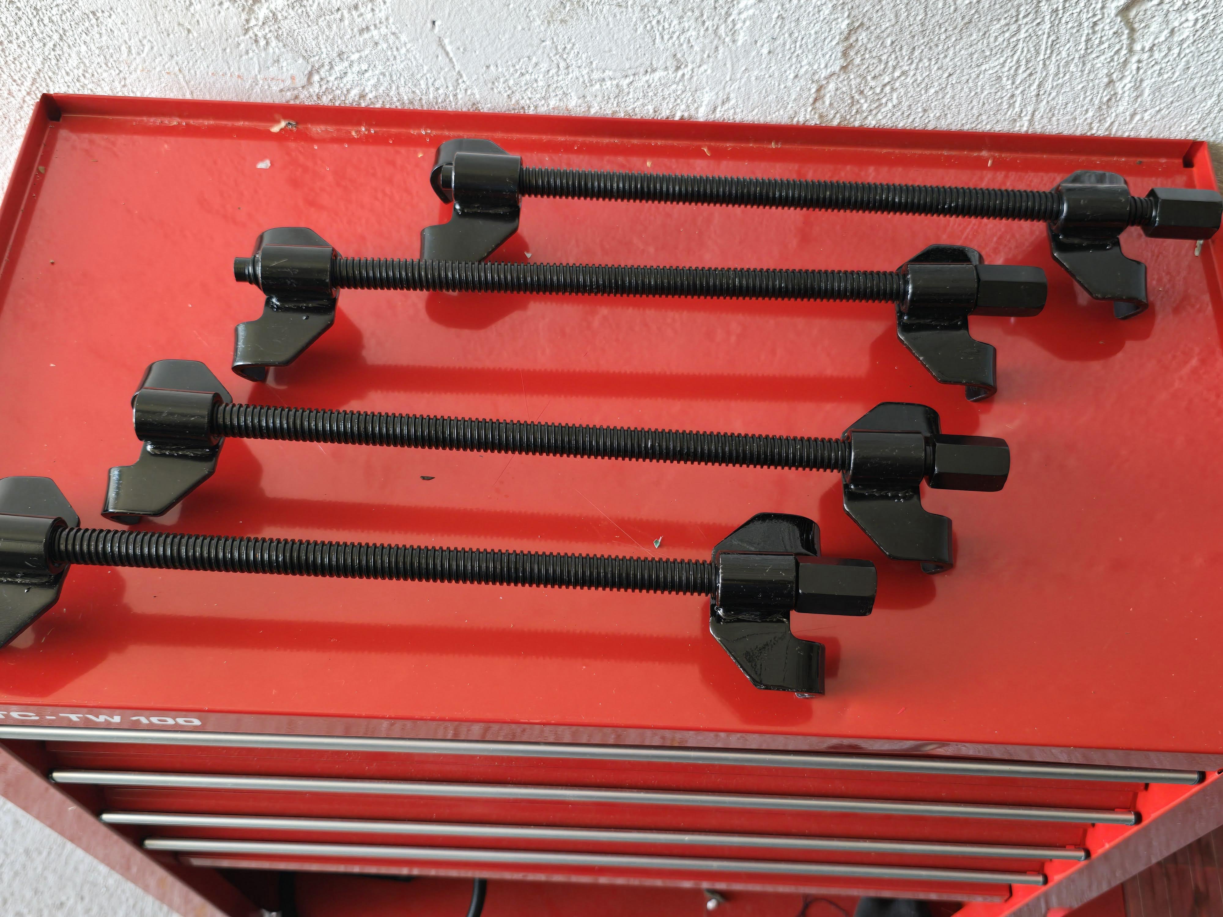

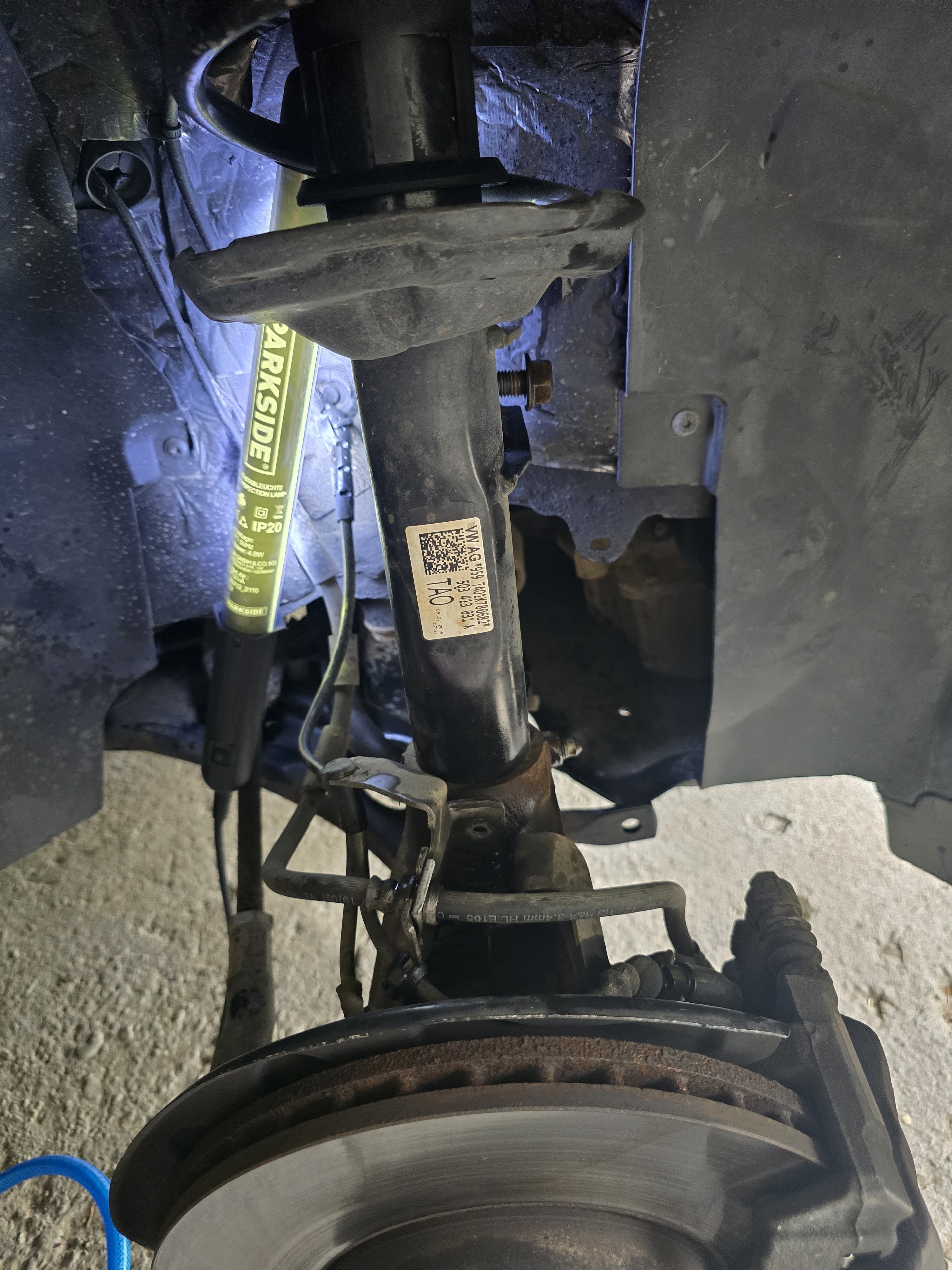

i did replaced shock absorbers, bearings, dust protectors and rubber upper parts connecting shocks to body.
i also replaced those tiny connection torque bar links. i didnt see noticable play but as are them half disasembled i put new one looks like original (Febi bilstein)
all shocks, bearings and rubber holders and other stuff are Sachs.

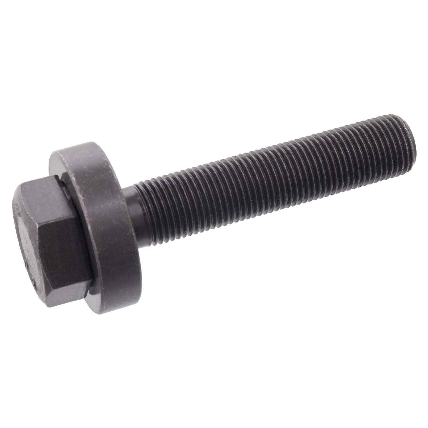

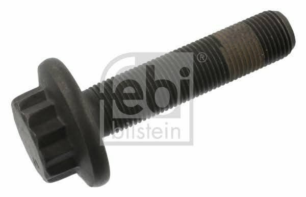

replaced driveshaft big bolts from trilesquare to normal 6 square bokts from vw transporter. bolt quality is same, 8.8 lenght little longer, from 70mm to 75 but it does not matter.
i dont have dedicated triplesquare socket so i use regular 12 square 24 socket to release bolts and regular 27mm 6 square socket to tighten new bolts. they have same purpose, put a loctite blue on thread and torqued to 200 Nm. after all was done, i put wheels on ground, torqued rim bolts with 120 Nm and on driveshaft bolt added 3x45 degrees, i have not more strenght in muscles and in my ower back that hurts, somewhere i have some a 1 meter long steel pipe to extend handle with an inner diameter greater than 1 inch, which is the diameter of the handle of a 3/4 inch lever, 455 mm long, an impact socket adapter to 1/2 which sockets I have all of medium quality brands (some Hazet but mostly Unior, LUX, Proxxon, Stahl, not Stahlwille, I don't know if this tool still exists.)
After the complete assembly of the front suspension, the car no longer rocks, doesn't bang or drift, doesn't dance in the corner, except that I hear a slight metallic scraping sound, I think I bent the front disc's protective sheet a little so I still have to straighten that out. One driveshaft bolt went 180 degrees and stopped, no matter how much I jumped on the lever with all my body weight, it didn't go even 1 mm while the other one could go further, but I don't think I reached 180 degrees, probably 160. But I think it's all holding up well, because it's really tight. Now I'm planning on rear shock absorbers, because they're from the same era, there's no Sachs replacement OEM but there are Bilstein B4 which are like the originals. It's interesting that the current Sachs front ones are a little longer than the OEM ones that were factory-fitted on the Azjuta, about 1 inch higher, although it's not visible either optically or behind the wheel. piston is longer, or it goes more up, lower black tube body is same.
