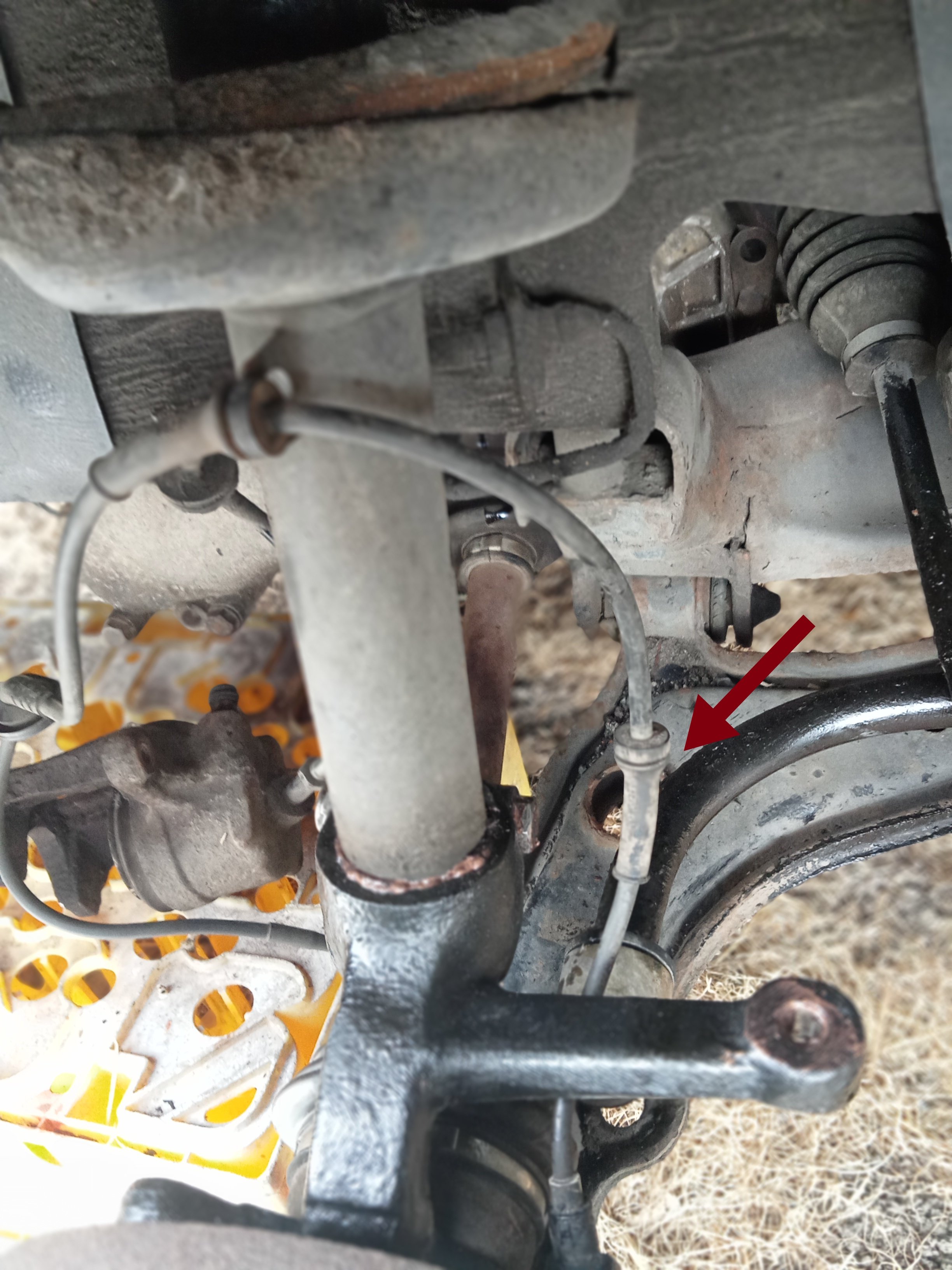

Can someone post a pic from under under the front wheel arch on a ABS model.
Trying to work out if the ABS cable at this point needs to clip onto something. Maybe I'm missing a bracket, or it's possible that it's like that because it's just a generic ABS sensor.
I assume the photo just shows a trial fit as the grommeted sleeve isn't fitted into the circular bracket on the damper. If the steering turns fully both ways without touching the lead I think same as you that the second grommeted sleeve isn't needed. It might be a photo but the second grommeted sleeve appears (to me anyway) to have a smaller grommet part so perhaps is to make the generic sensor fit a range of cars with different size circular bracket(s?).
I don't know with the ABS but other sensor can be very particular about having the exact correct sensor - IIRC I saw a Merc owner had fitted generic ABS sensor to an older model and it worked fine.
Obviously current Felicia owners will know better or for sure.

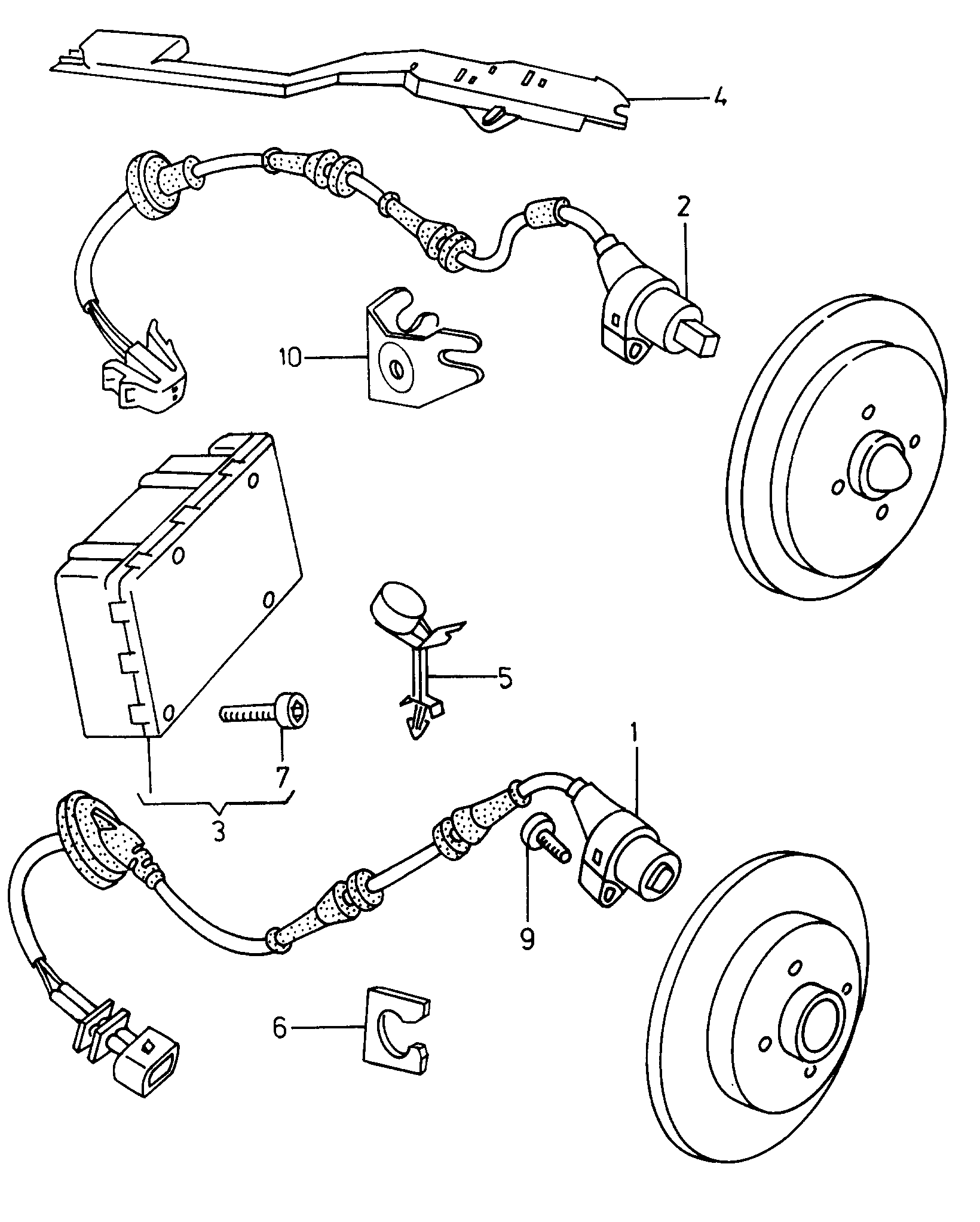

Spent ages findIng this, I seem to be missing a bracket, part 10 in diagram.
Looks like it's held/clamped in place by the strut pinch bolt.
No chance of finding one of these, so looks like I'll be having to manufacture one.
