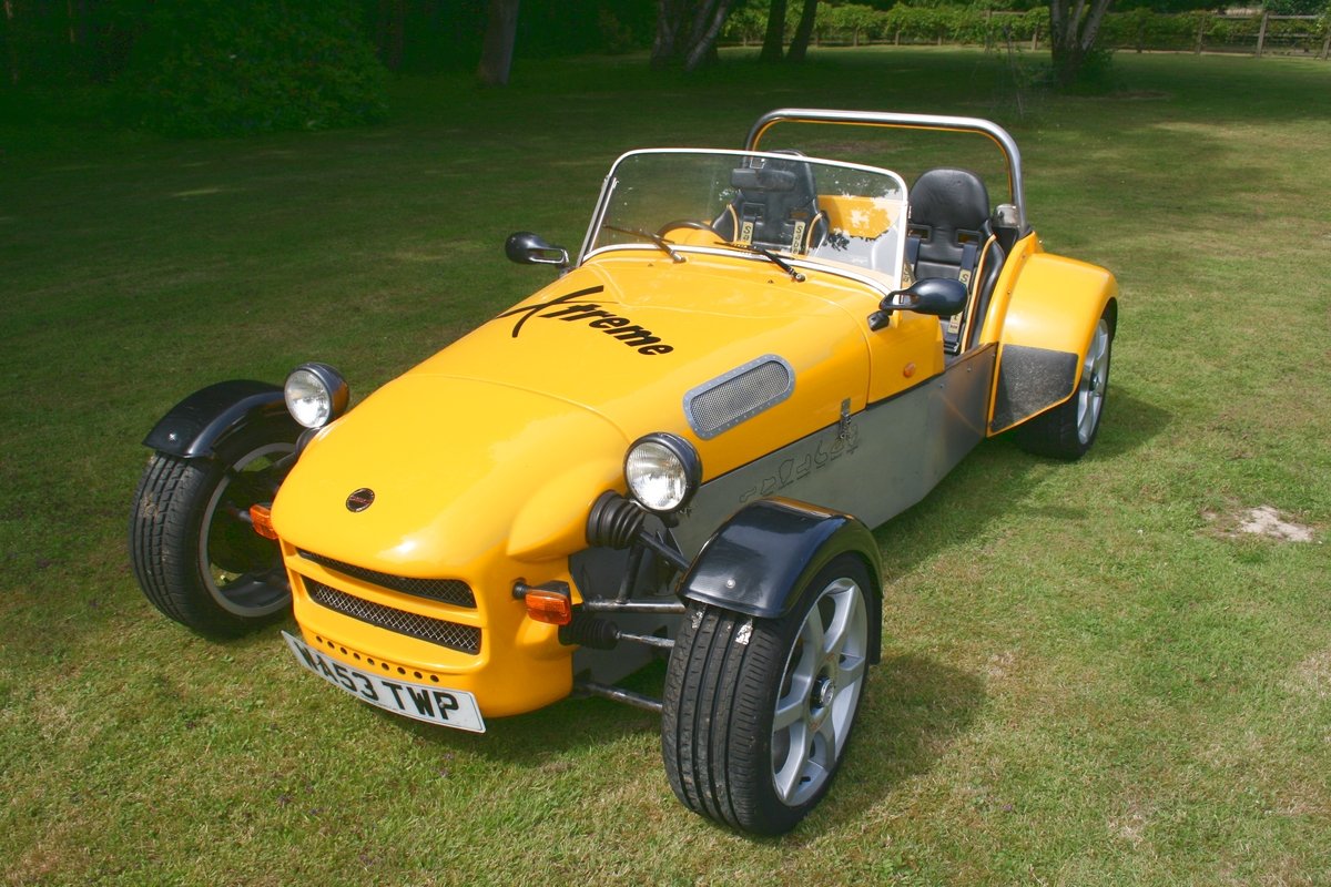

I think I may get the local independent garage, which is a VW group specialist, to do an intermediate oil change for me. I am a bit too old to get underneath cars these days. Even the Quantum Xtreem kit car that I had did not need me to get underneath, though changing its filter required loosening the engine mounts and jacking up the engine!
This is the little beast, which was great fun and very fast.
