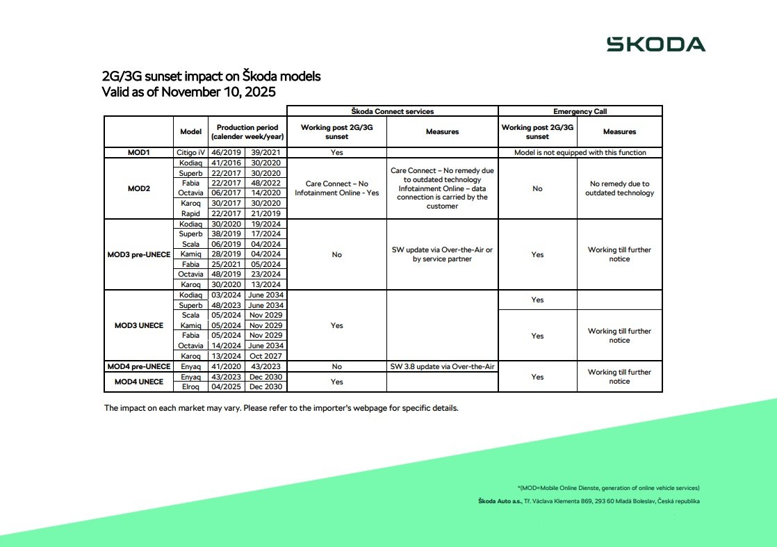

  6. Okay, my dealer don't have any info on it, so the only thing I know about it is the info on Skoda page. 2G, 3G Sunset
  7. I thought this maybe was because of the 2G/3G network closing in near future
