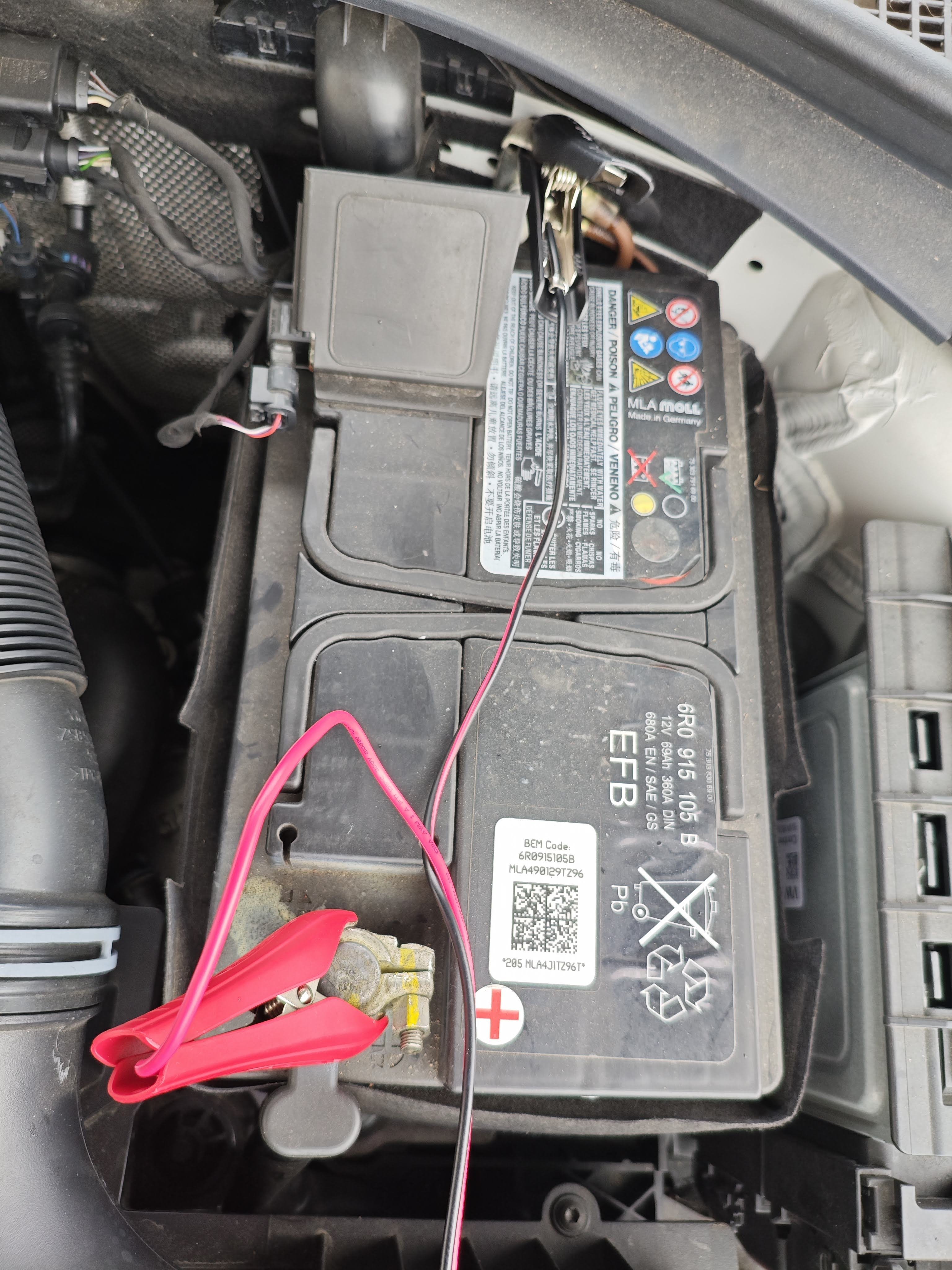

My 6.5yr old battery seems to have given up the ghost after not driving the car for over four weeks. It's an OEM EFB Moll 6R0 915 105 B 12V 69Ah 360A DIN 680A EN / SAE / GS. It was down to 2.5V and is currently on trickle charge with a CTEK MDS 5.0 (in the faint hope it may be recoverable).

It looks like i have a thermal sleeve around the battery - see photo - so i assume i could go AGM. But i know that if i switch to AGM i will need to activate it. For this i would invest in an adapter like the Vgate iCar Pro2S and CarScanner Pro app. That will add another 35£ to the overall cost.
