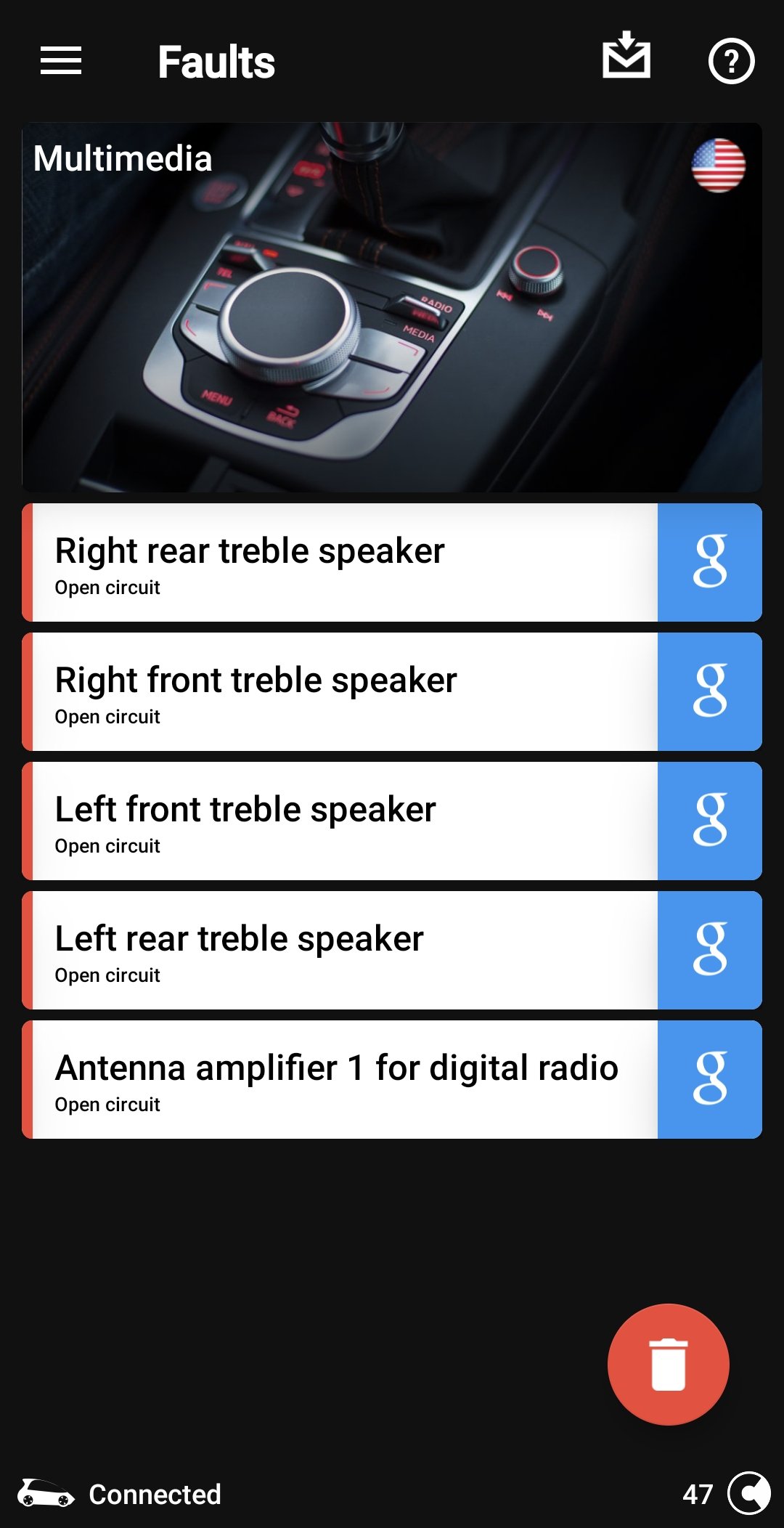

I have a 2014 vrs octavia combi, it has the big screen sat nav radio in it, everything works as it should apart from the sound, the odd time there's a crackle from one or two of the speakers and sometimes the rear passenger side speaker works for a few min, did anyone have this or a similar issue before,
Regards Brian
Should have noted its giving a open circuit fault to all 4 speakers
