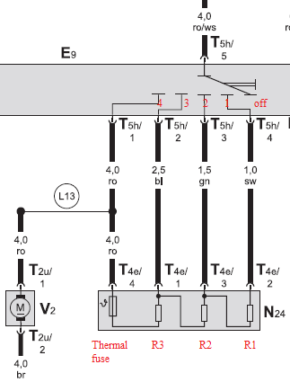

This is mk1 Fabia version, but I doubt they've changed.
N24 is the resistor pack, switch above it, V2 the fan motor:
Three resistors plus a thermal fuse, all in series (actually just 'tappings' off a continuous winding of resistive wire).
R1 section is often the first to fail cos it gets most use, but any of those four bits can fail. If R3 or the thermal fuse fail, only speed 4 will work, cos that's permanently connected even in the absence of N24.
thankyou all for the replys
going to order and fit a 6Q0959263 6Q0959263A pack
hopefully that will sort it
