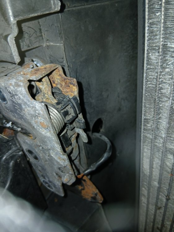

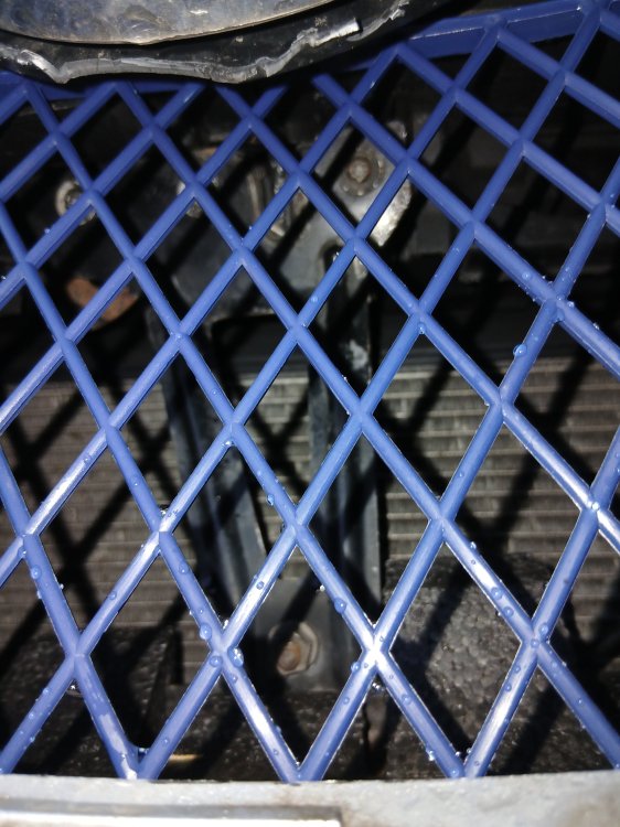

The bonnet will not open, I have a new grill so was able to mutilate the old one to get nearer the locking mechanism.
The cable was still working up to the headlight then nothing. Found the cable coming from the lock, yanked it, cable and half a bit of plastic(sleeve) came away from lock. If there is a tab or spring in the lock and approximate position that I need to pull/press, could anyone let me know please? Or any help at all would be appreciated. Should I buy a new lock and chisel the old one away?
Picture of the bottom of lock and front of car with temp grill on20250912_065521.jpg20250911_104106.jpg
If you can pull the rusty arm with a hole in it at the top of your second picture downwards it should open as I'm pretty certain that's where the cable end was attached after passing round the black plastic guide. Might be worth spraying a bit of lubricant in there first though as it's likely rusted stiff.

Thankyou for replying, I'll spray some wd40 on it a let it fester before I give try it.

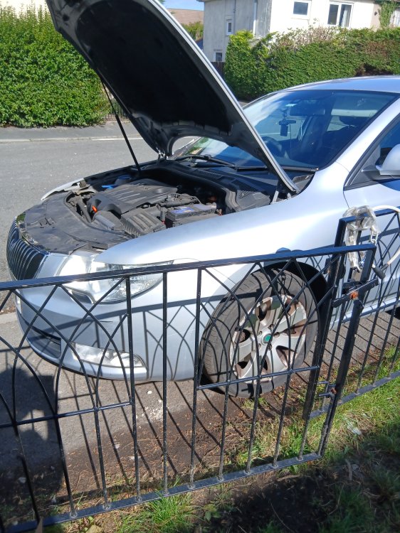

Quick update, it's open! Thanks so much for the help. Going to slather it in lubricant. Seriously thanks, it was driving me crackers.
