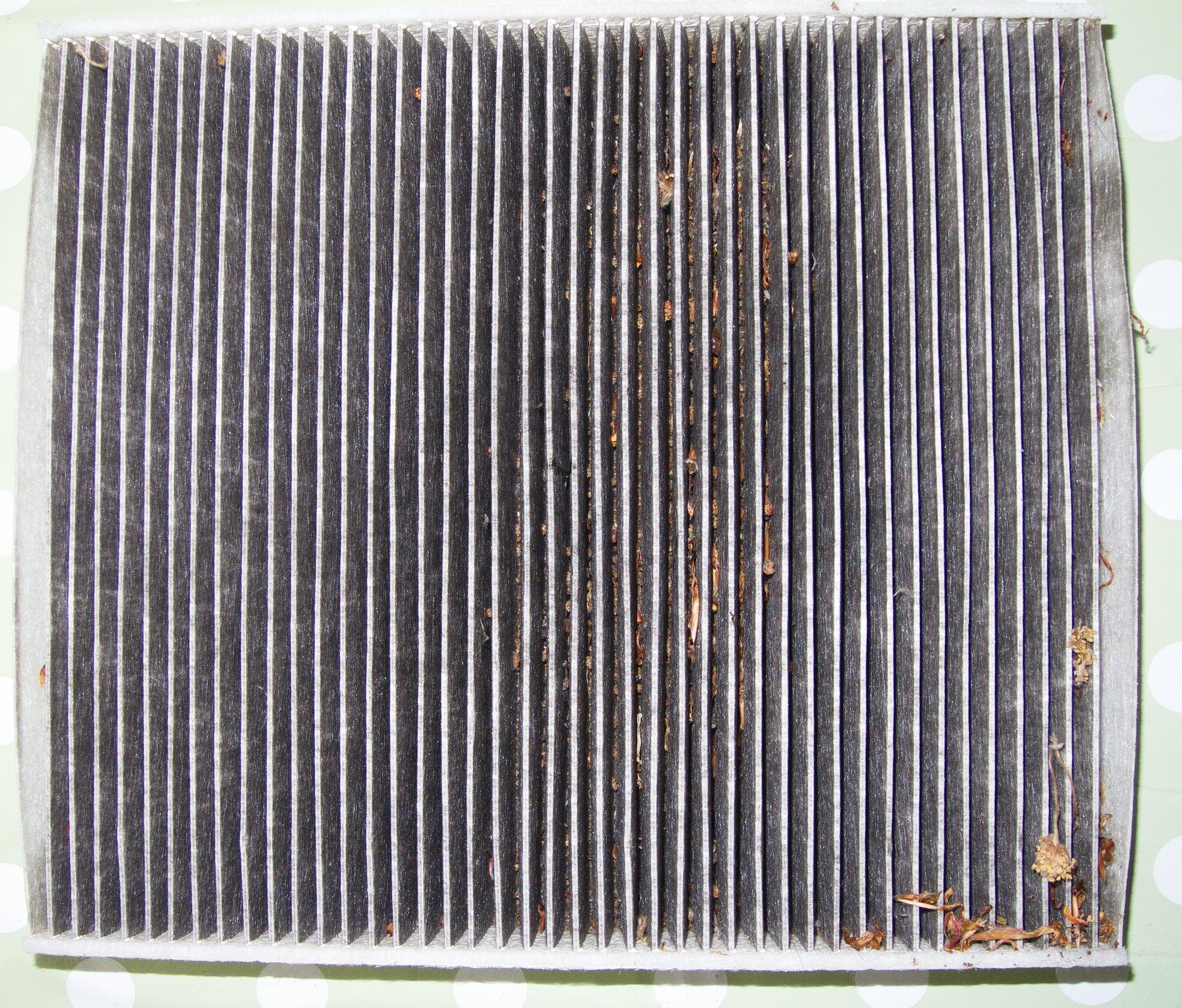

Here is a picture of a pollen filter. 7,000 miles after it was changed by a main dealer. Looks like the original to me - at this point 26K miles and three years. It was absolutely rammed with silver birch seeds - yet the local trees hadn't cast seed in the 7K miles / 8 months since the service. I know what I think.......
Another unfortunate example of things that servicing agents think they can get away with.
They do often start grey like that when brand new because the genuine or quality aftermarket versions are charcoal impregnated. So it's not a smoking gun. :)
The greyness isn't the issue - that's the charcoal adsorbent they come with. It's the shed loads of organic crap in the folds that's the issue.
I was checking because the airflow out of the vents wasn't great. Strange how a new filter fixed that.
I've seen plenty looking similar after a couple of years but if it's blocked it's blocked. If they charged you, vote with your feet and don't go back!
