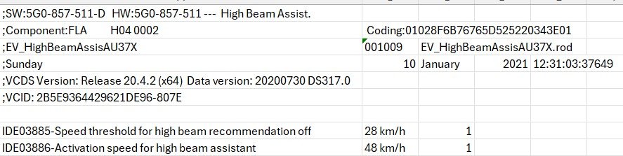

@Warrior193 in my experience (MY16) it actually uses both, and using VCDS software I own, I know there is a speed value in module A5 at which it turns on and off as I've changed it (and back to factory as it was undesirable😀)
It will not put high beams on until approx 40mph. (58km/h).

Just to show you what i see in my software tools, below shows the speed on and off values, these were my modified values which were a bit too low.

This Parameter is for the City detection
Main_Beam_Assist_Urban_Area_Detection
