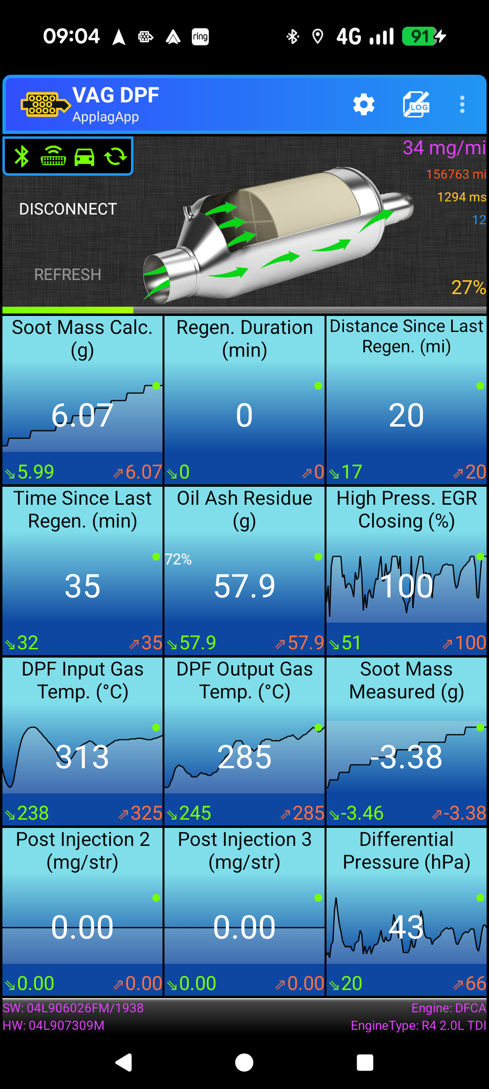

I've attached a photo of my dpf values from recently. I don't think there is anything too much wrong. It regenerates I guess around every 150 miles or so and the ash residue is at 72%.
Im just wondering if somewhere it's a bit clogged up. I'm reluctant to put it into a garage as I can only assume as there are no codes, diagnostics is going to be costly.
