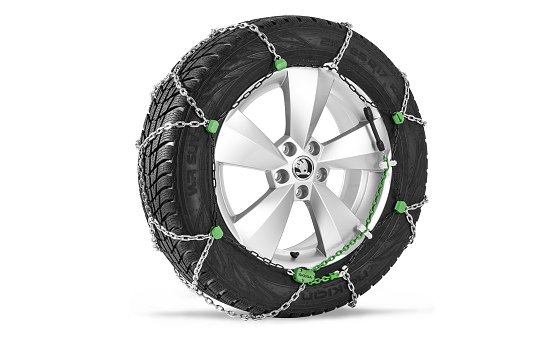

The only wheels that Skoda approve for snow chains on both the Kodiaq MK1 and Kodiaq MK2 is 215/65R17 6.5Jx17 ET38.
Skoda also list a 7Jx17 ET40 rim, but that specification is not approved by Skoda for use with snow chains.
Alcar 9015 6.5Jx17 ET38 5/112 57.1 steel rim (for Kodiaq MK1/MK2)
https://www.mytyres.co.uk/rims/details?vehicleId=672860434273997936&rimCode=ALCAR9021
6.5Jx17 ET38 5/112 57.1 alloy rim NANUQ 565071497 8Z8 (for Kodiaq MK1/MK2)
https://eshop.skoda-auto.cz/cs_CZ/alu-kolo-nanuq-17-kodiaq/p/565071497++8Z8
Snow chains 000091387AS (for Kodiaq MK1/MK2)
https://eshop.skoda-auto.cz/cs_CZ/sada-nerezovych-snehovych-retezu/p/000091387AS
