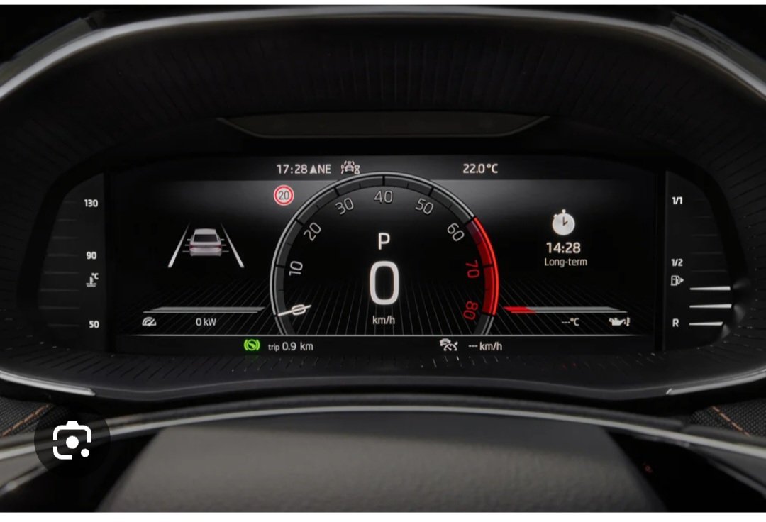

For clarity, what I was hoping for was something classy like this:

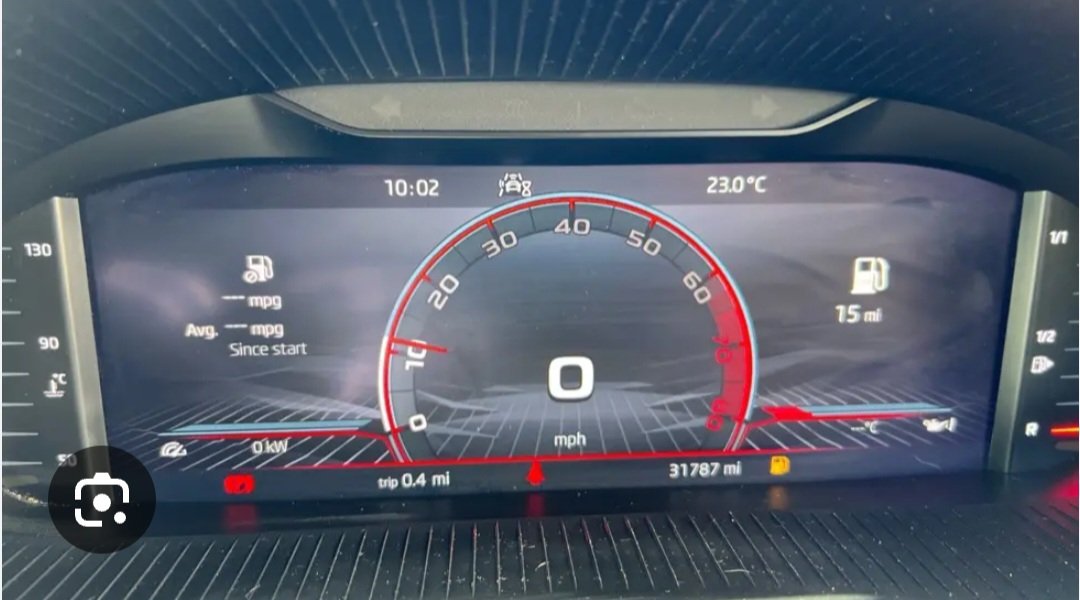

But what I have is something like this:

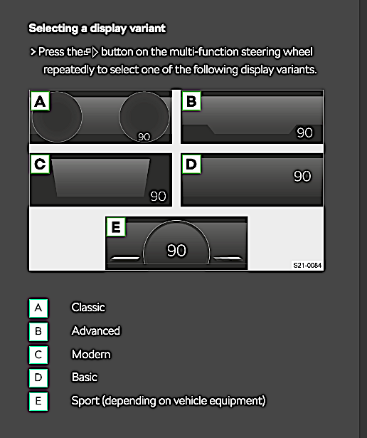

My 2024 Fabia Mk 4 SE L has an analogue instrument-cluster. The information on the alternative Virtual Cockpit provided in the Owner's Manual (hard-copy and soft-copy versions) for my car shows five display variants
but there's no advice on how an owner might change the overall 'colour look' of each display.

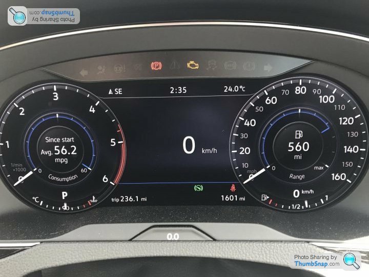

I was genuinely expecting something impressive regarding screen style options and graphics. Something like the VW Golf below and not something that looks like it was designed by a 12 year old !
When adverts for recent Fabia Monte Carlo cars show the Virtual Cockpit (VC) display illuminated, the display's 'look' always seems to be like your 2nd photo.
All current-model Fabias now have the VC, but the Skoda Configurator suggests the Fabia Monte Carlo VC will have red-ring clocks, but other Fabia models will not. It would appear, then, that Skoda may have chosen to set the VC default theme to match the Monte Carlo model's 'boy racer' red accented interior trim.
However much a buyer of a Fabia Monte Carlo might dislike the red accented interior trim and yearn for the more 'mature' restrained interior of other Fabia models, red interior trim appears to be the no-choice standard fit - and that may also be the case with the red-ring-clock VC default theme.
