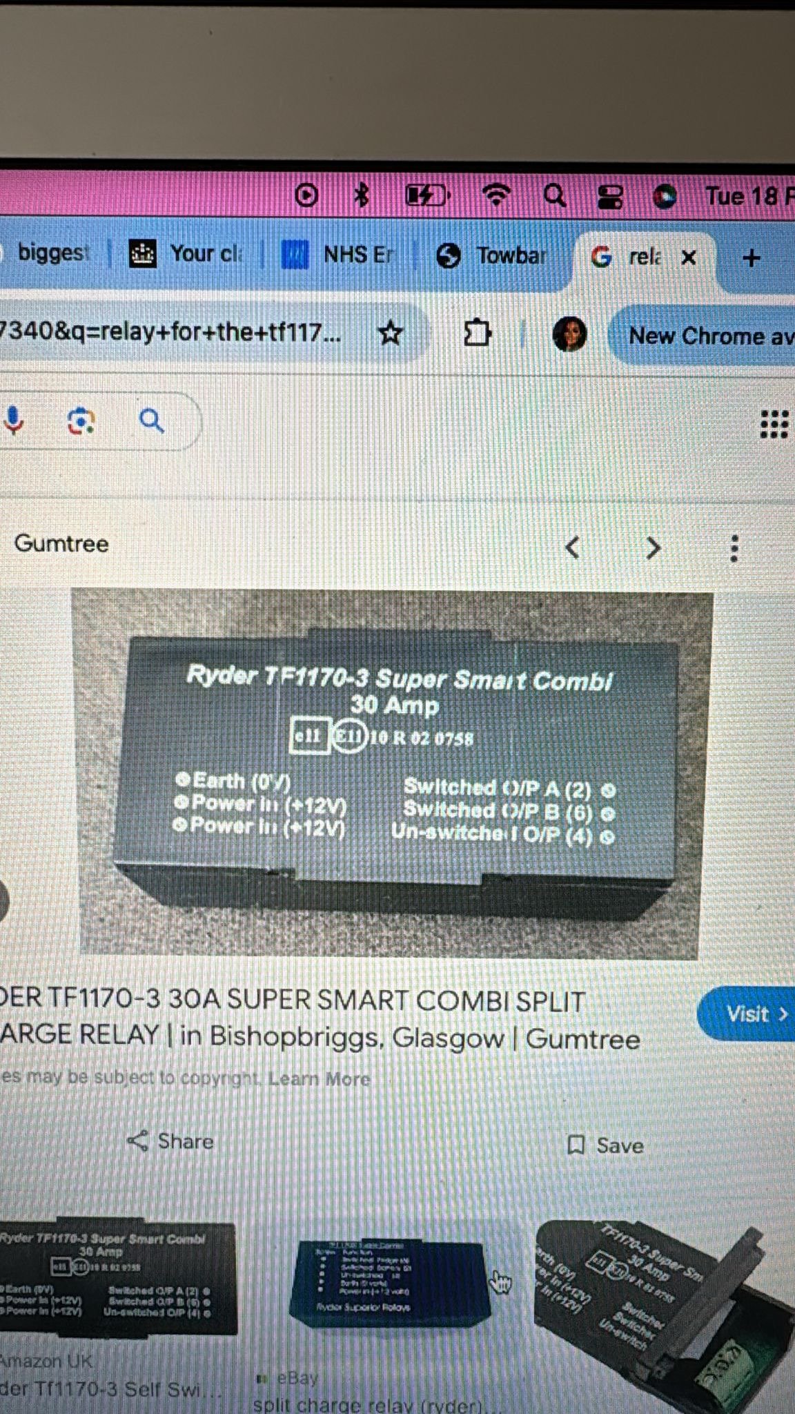

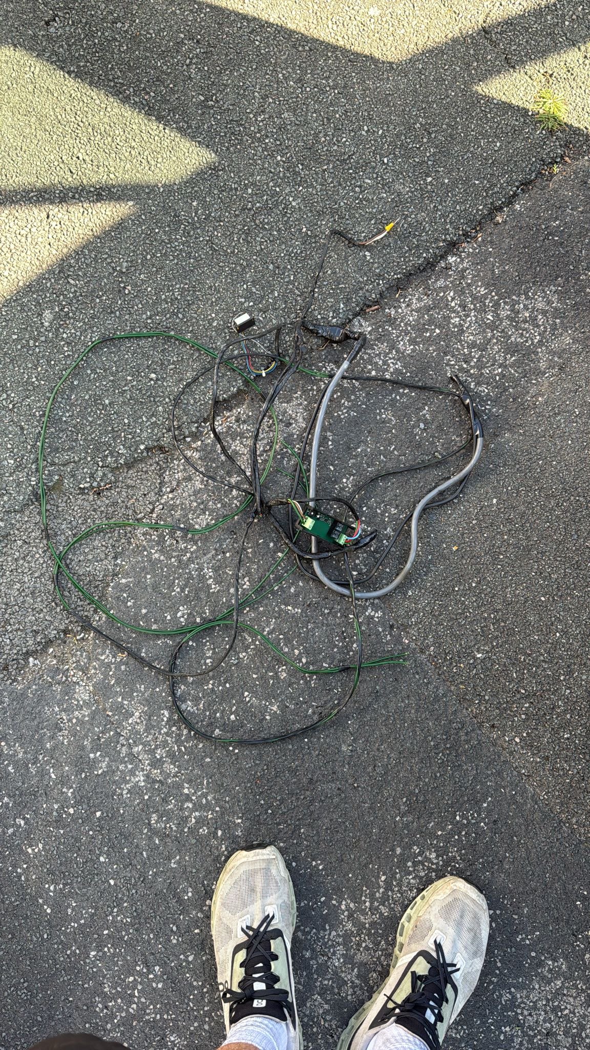

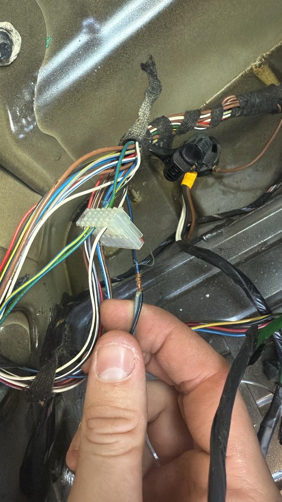

From what I can see no lights or anything is left on. The infotainment system is the original. It had an aftermarket tow bar fitted however I pulled all that out as the relay box all corroded. I have attached photos to what I pulled out.
Hmm, defo not a specialist or dealer install!
