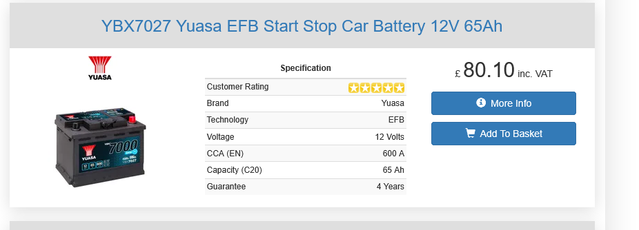

If it's an EFB I would replace it with an EFB no need for the extra expense of an AGM. What you could do if you have low usage case is get a larger capacity for the storage element.
https://www.tayna.co.uk/

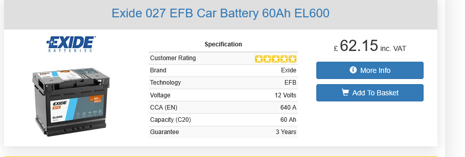

There are cheaper but this is 65ah not 60ah and longer warranty than
