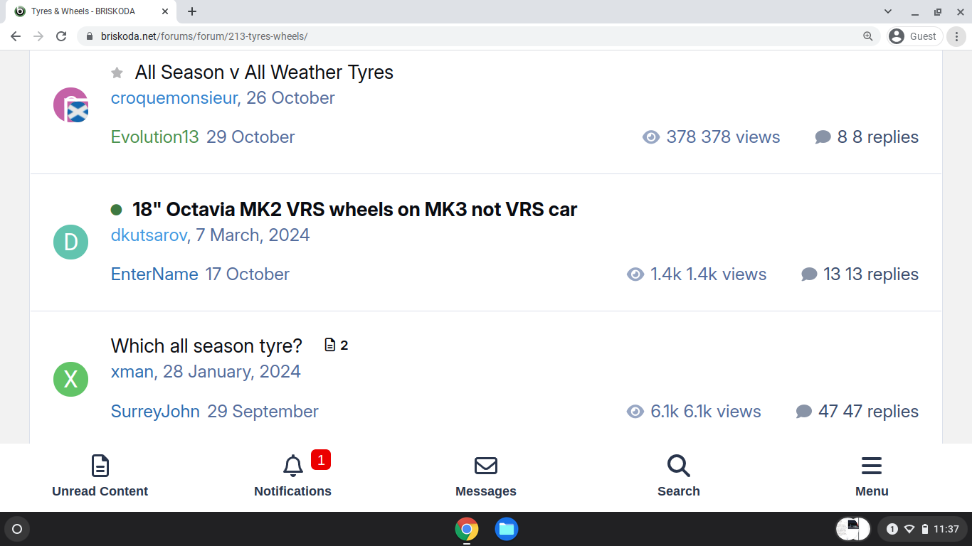

Plenty threads in the Tyre section that might help. I have CrossClimate 3 on my EV. Ok on the snow yesterday. Price on them was very good. I had Maxxis AP3 on my MINI Electric last year, they were great. They went on instead of the Vredstein Quatrac Pro i fitted when i got the car. They were OK, not great in snow though. My 205/ 55 R 16" tyres are V 96 All were good in dry and wet / cold. There are Youtube tyre comparison vids linked in the threads.

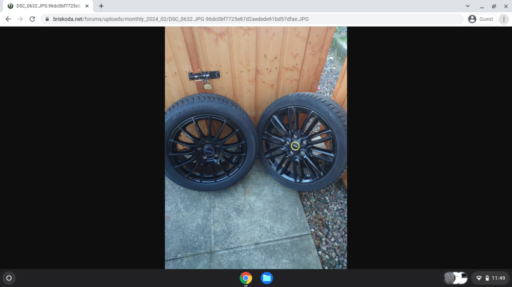

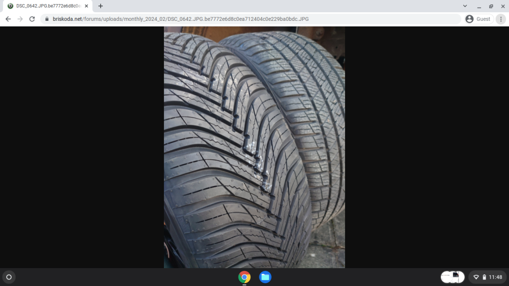

Why not go for 195,s? I had 195/55 R 16,s and 205/45 R 16's. Check out the sizes available on the ASDA Tyre site. CrossClimate 3,s are probably all you need. Plenty choices in All Seasons with higher Load / Speed Ratings. XL sidewalls. ATS Euromaster. Michelin own them. MAXXIS AP3 on left, Vredstein right. Maxxis AP3,s reviewed in the AP2 thread, i had them fitted on a Fabia vRS & a Corsa Electric. Also Michelin Alpin 6 & Tigar Snow tyres.
