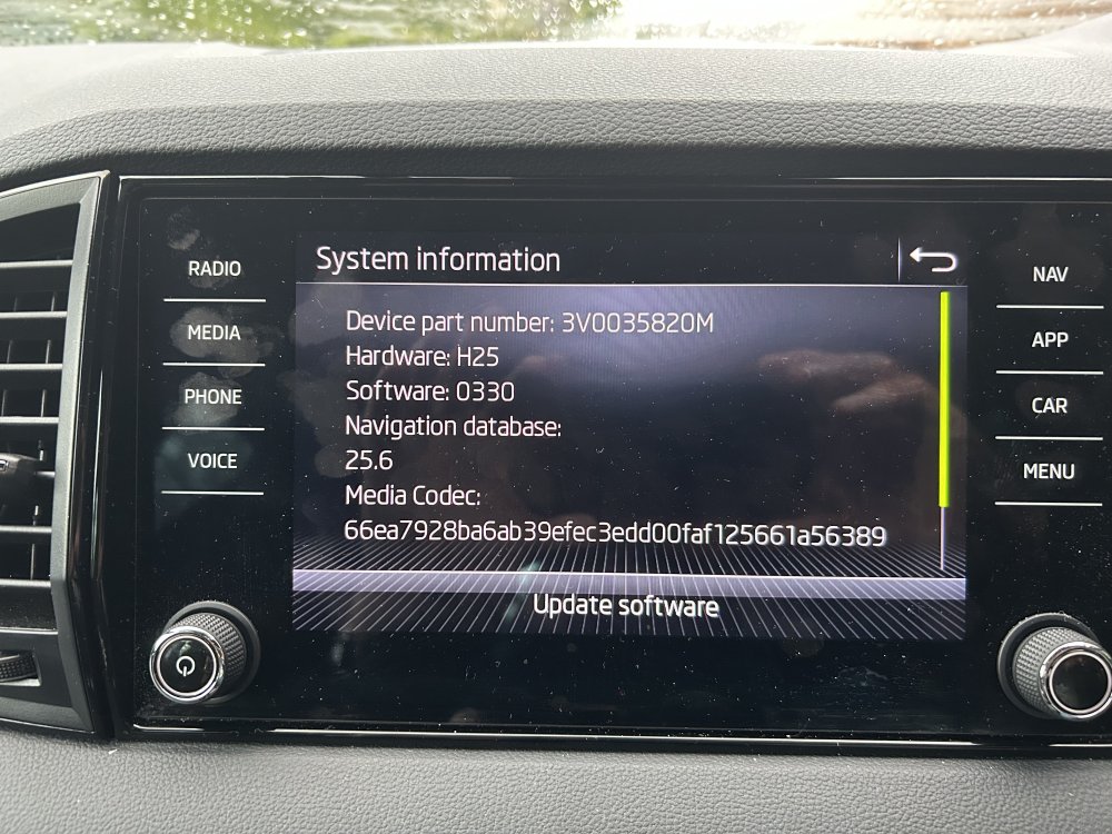

Firstly delete all users, then with BOTH keys in the car start the registration process. From memory it should then display a QR code to use with your phone, scan the QR code to download the Skoda App. That should then sync with the car. I think it’s at this point you can make yourself primary user. This is the system display from my Karoq as of July 2025. Navigation database updated you will only get by paying the annual subscription in the App, I think you may have to buy the remote access subscription to get software updates. I’ve paid for both.

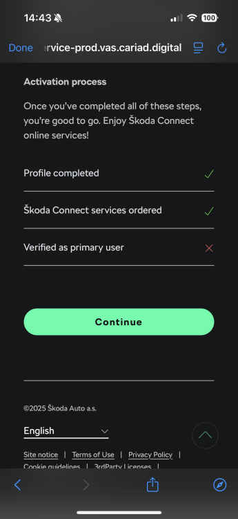

Here's the screenshot on the app - I was able to 'order' Skoda Connect services at £0.00. I don't mind paying for the services if required, but I can't even get to a screen where I can pay for them!

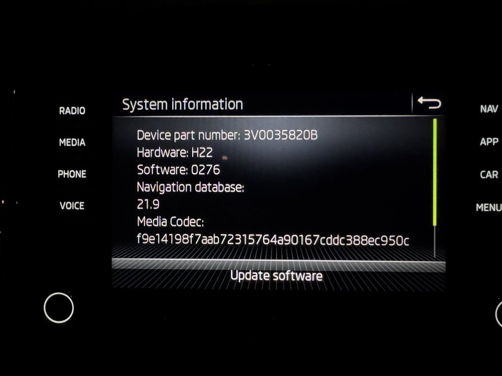

You're on different hardware and firmware to me. I've ordered a USB C flash drive to install the newer firmware manually in case this helps.

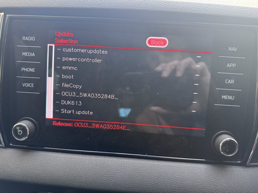

I've updated to 330 OK, but now I'm trying to update the OCU - I think I have the right file but it's greyed out in the update menu:
