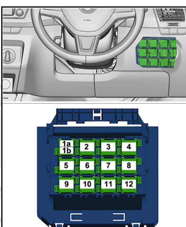

Relay located in position 1A, apparently:

Actually doesn't look that hard.
