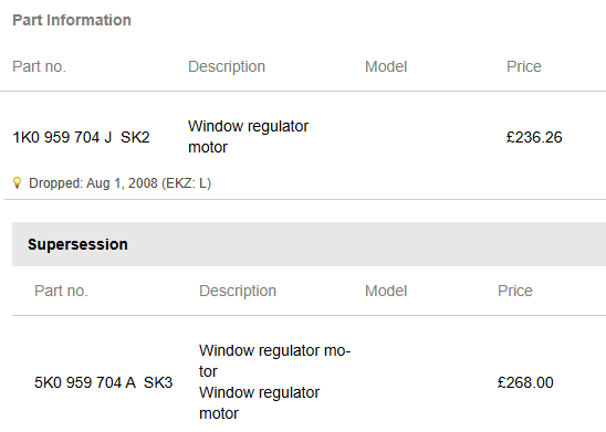

Broken window motor with part number 1K0959704J SK2 - HW 006 SW1201.
Many secondhand ones available but none that match up correctly, how do I know what ones I can use?
Ie. there is one available but the part number is the same but ends SK3 with HW006 SW1301, would this be ok?
I reckon the part number is 1K0959704J SK2 and the rest of the characters are maybe production codes/marks. I googled the above and LLL parts say its been replaced by 1K0959704JSK3 then replaced by another that they dont reckognise with SK1?
Tried skodaparts.com and when entering the SK2 part number it came back with
Škoda part number:
  • 5K0 959 704 A SK3
  • 1K0 959 704 AK SK1
  • 1K0 959 704 AK SK3
  • 1K0 959 704 J 002
  • 1K0 959 704 J SK1
  • 1K0 959 704 J SK2
  • 1K0 959 704 J SK3
  • They say its for rear right skoda octavia mk2
Prices are before VAT, RRP at Skoda.
