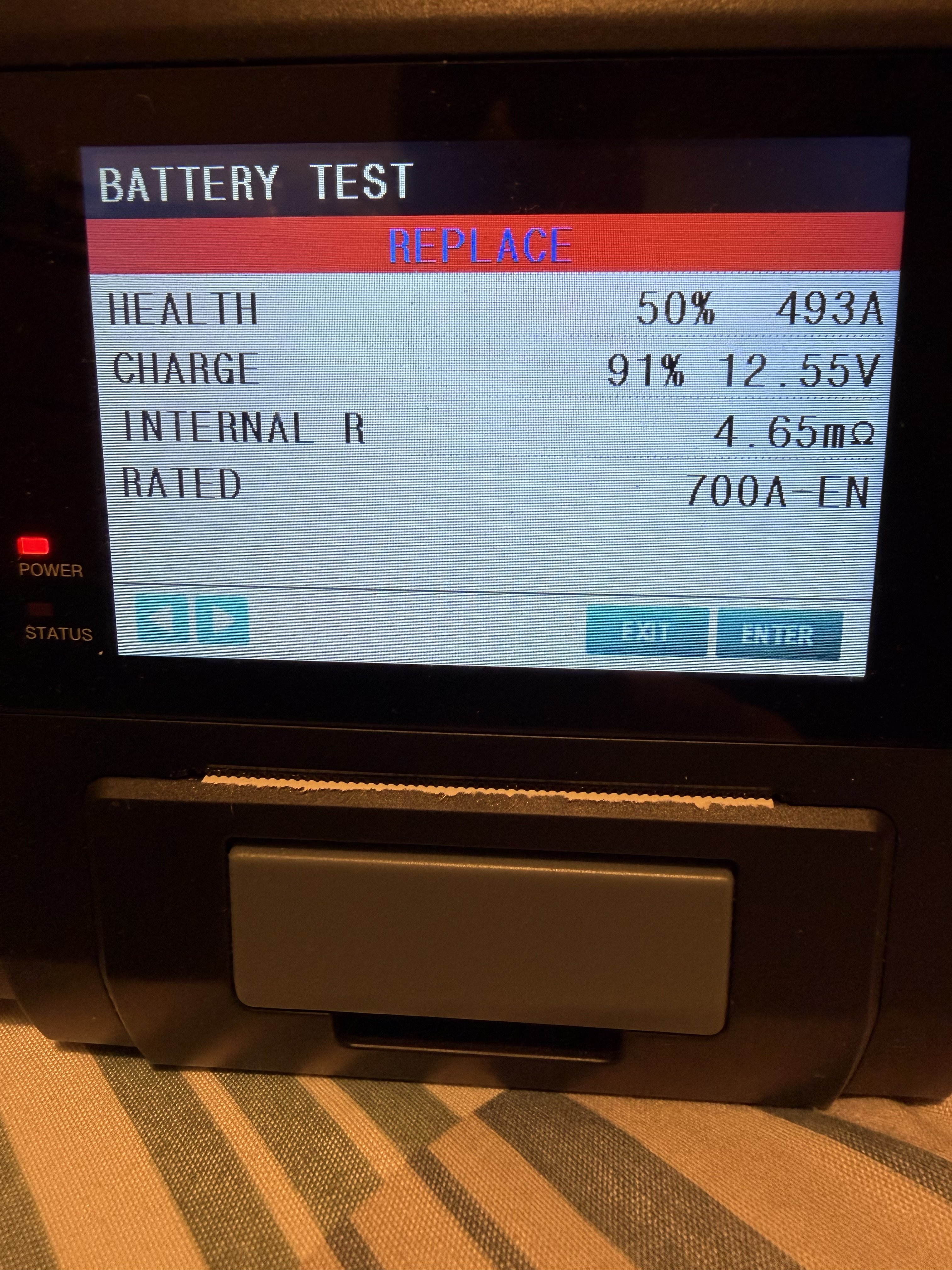

Interestingly my Topdon battery tester keeps telling me to “replace “my 18 month old battery . But it cranks fast, starts instantly and the start stop works flawlessly.

Battery reading after a test. Funny thing is it cranks good and the stop start works flawlessly.
Mine cranked fine too.
