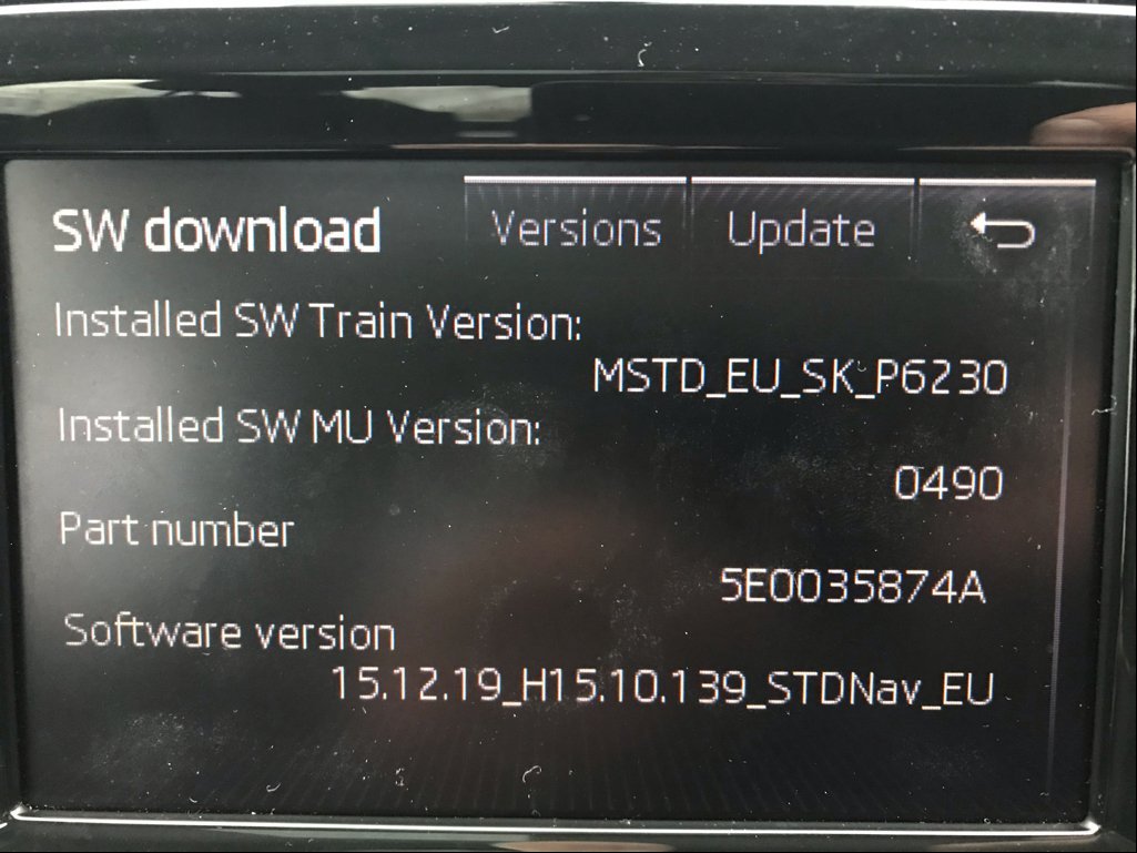

I did flash the firmware once ages ago think my post on here may have some screen grabs on it....
Let me see if i can dig it out...
Attached is an image of the head unit post FW update

But does anyone have a link to the exact part required..?
