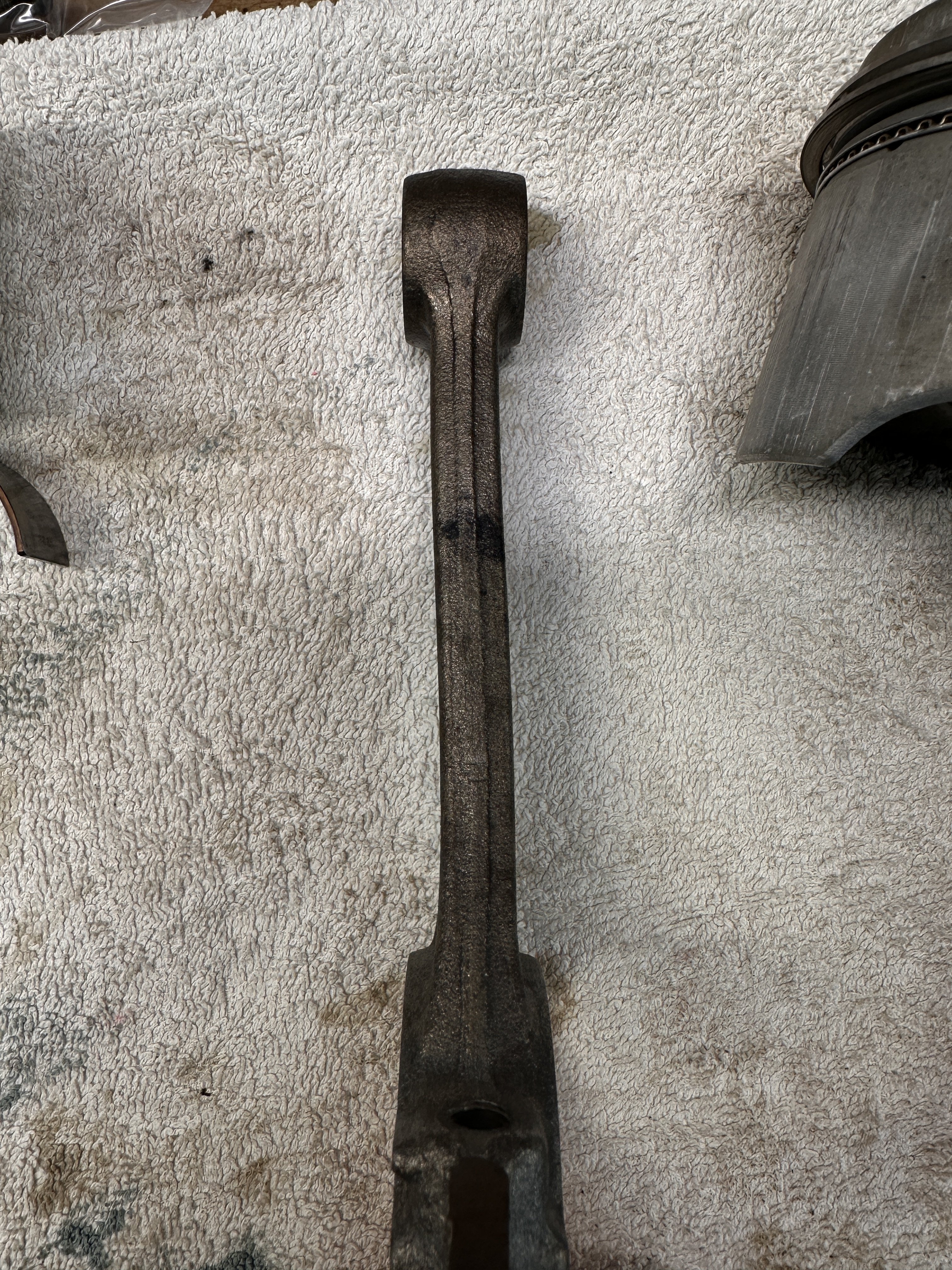

I’m rebuilding my 1.6 pick up with a 1.6 EEA engine and while doing the strip I’ve noticed that I have a slightly bend con rod.
Does anyone have a con rod with the marking 032D for sale?

Ah okay, if I were in your position, I would do the same. Straighten it, and it's gonna be okay
I’ve had a go at straightening the con rod a feel like I was getting somewhere but though I got it straight(ish) from the front from the side it still had a buckle. I’ve found a 036198401G for sale at £40 which I’m going to buy for the piece of mind it gives.

ah damn it its bent buckled and most likely twisted, you cannot really align it, although they seem on the same pane so it could be serviceable, I'm sorry man
Hence my angle of the dangle test suggestion, looking at photos only gets you so far.
This could be tried just for practice once the new part has been fitted and working as it doesn't matter if successful and how successful or not, and it's still learning.

Yeah, sadly a multi bent con rod is very hard to align without speciality equipment if it were mine and I knew it hadn't come from a hydrolock, then a single buckle I would try to straighten but this multi pane its impossible without a jig.
@Rsedmonds in my opinion made the right decision to go for a new rod given the circumstances
A well made new rod would always/usually be preferable. You also bring up another point which I might have missed the explanation to, the cause of these bend(s), buckle(s) and twist.
