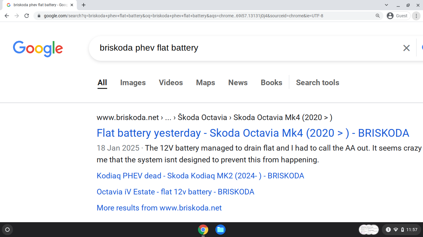

@Genesis32 There are plenty that have had issues with the 12v battery & PHEV,s. Warranty replacements of the battery. Flat batteries. Just a bit of a search will show this. Is this the first issue with your car.
