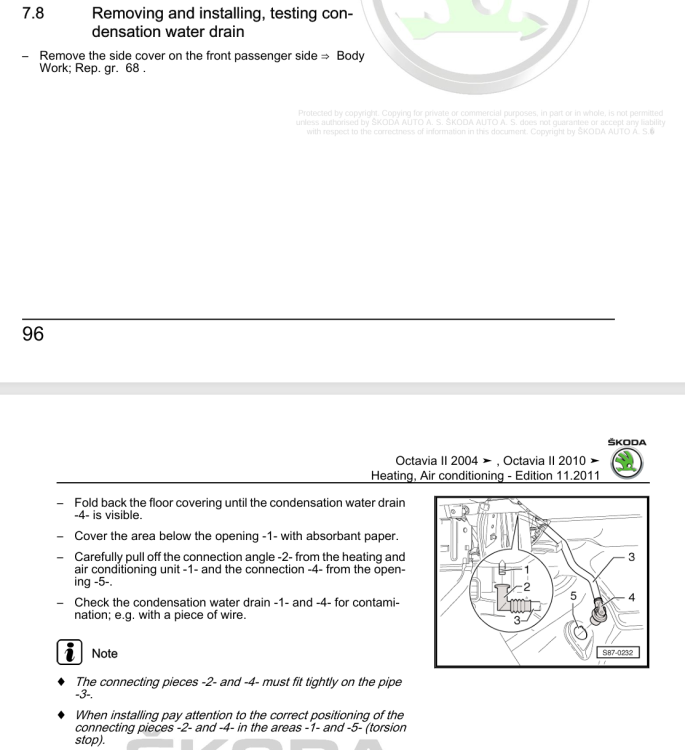

Instructions for checking internal hose below. Passenger side. (LHD shown, I expect, though diagram makes little sense to me as a non-owner). Mirror everything.
