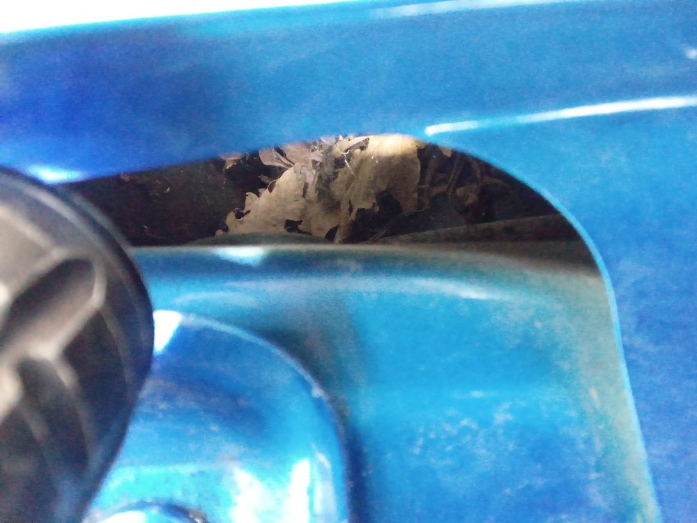

I do see leaves on the inside edge of the wing where the large vertical foam insert is and there is stuff in the plenum chamber but really hard to see much.
Could probably attempt to vacuum out the leaves in the wing part, will need a long big of hose on the end to get down in there being they left a gapping hole....

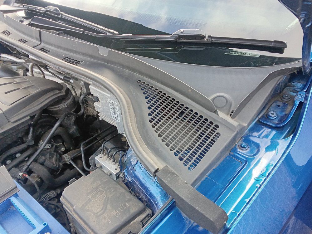

You don't need to fully remove it to get your hand under, just pull off the rubber trim at the bottom edge and lift up the cover from the corner. The rubber trim holds the cover and metalwork to each other. Another thing you definitely should do is clear out any crap behind the front wheel arch liners (the side behind the wheel, nearest the doors). Only a couple of torx screws to remove. I bet there's a ton of rotting material in there, holding moisture. There was on ours.
Just to add to your other post, there's no grille/filter on the intake opening as standard. If you saw a cover, you may have had the AC set to recirculate which physically closes the hole off. I think it's a bit ridiculous for the intake to be completely open so I bought a VW grille, same part fits various models and it just clips into the opening. Part number is 5Z0819044.

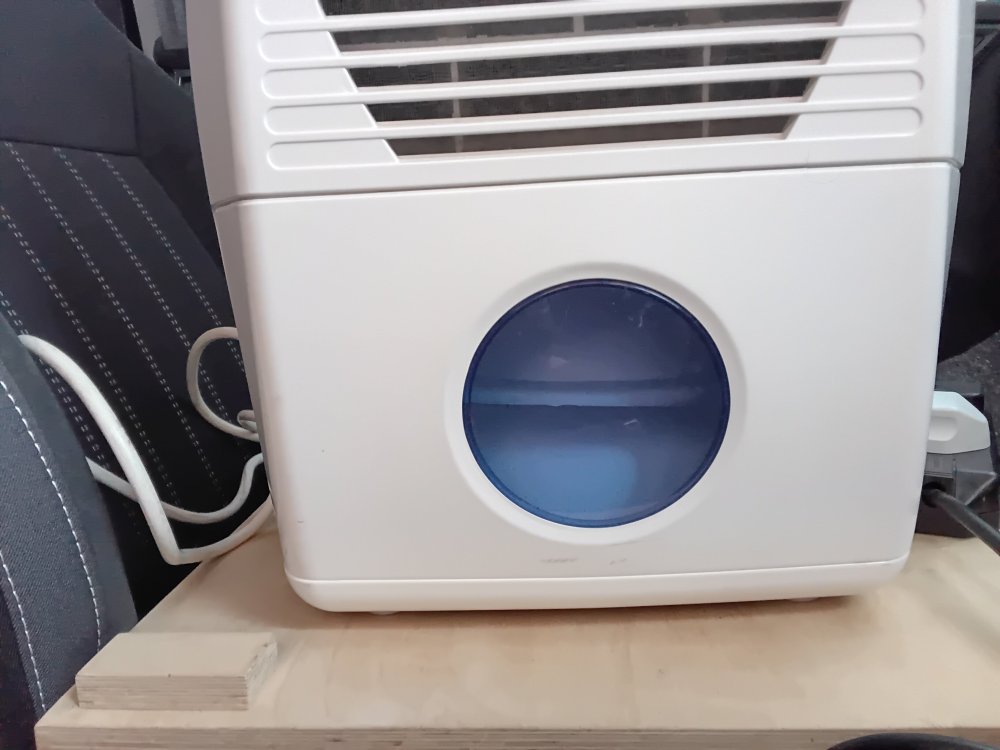

I've had a dehumidifier running all day yesterday for like 12 hours. It had pulled a fair bit out but the tank wasn't even half full.
I went out to check things and to turn it off for the night, though the carpet felt dry to touch, a bit of pressure on it and its soaked up more water. Gutted...
I just left the dehumidifier running overnight. Then around 8.20am this morning the car alarm got triggered. I had been turning off internal monitoring but it had got enabled again at some point.

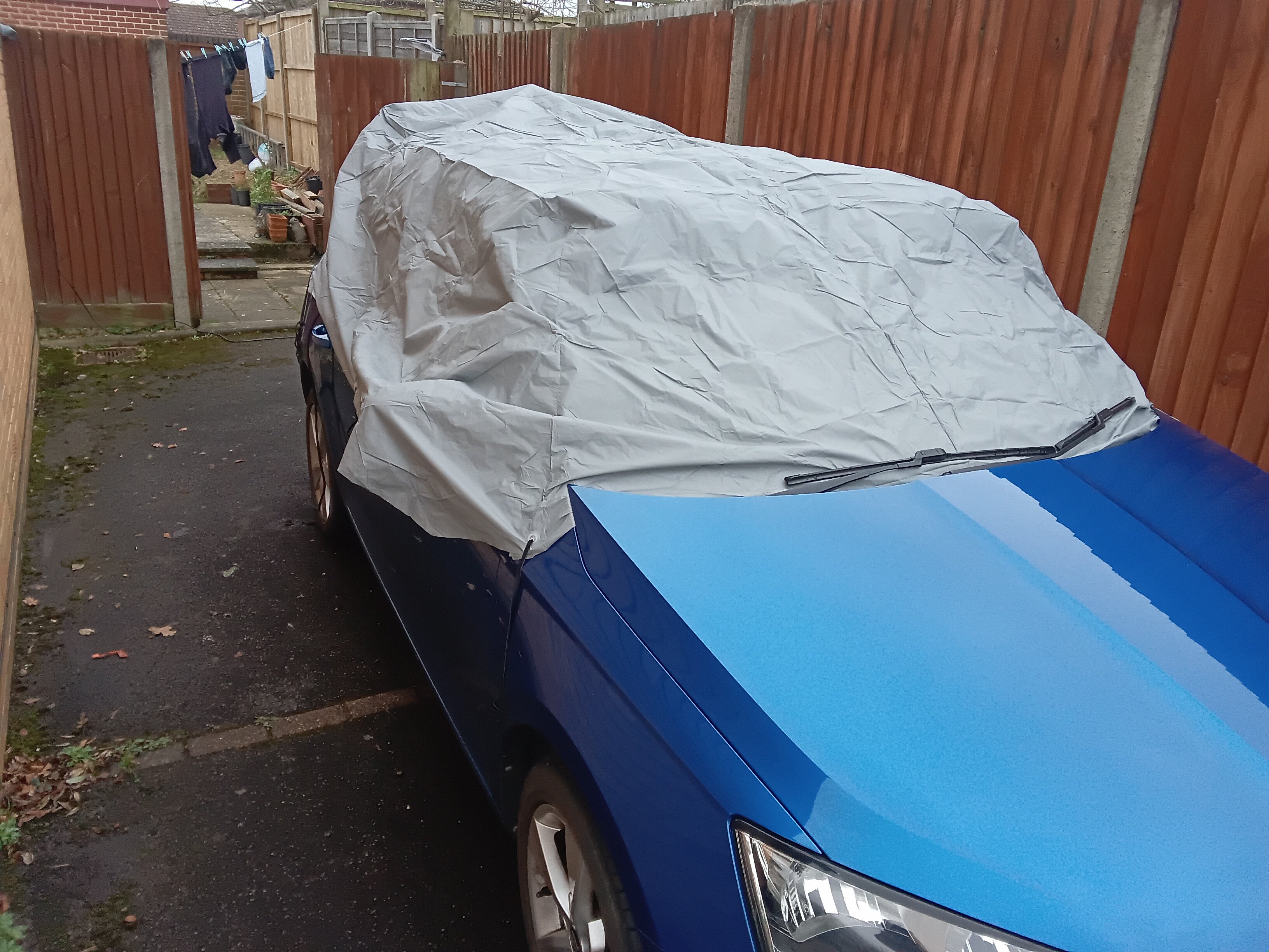

There's even more heavier rain coming in over the next few days. I do have a half cover that i could try and put on just to cover the windows just in case the windscreen is leaking.
And maybe a tarp under that over the front of the car.

On mine there is a grill on the front of the inlet, i was surprised to see it as like you say people say there isn't one. I'll try and get a pic. Mines the facelift 2019 model with the slightly different body contours. I wonder if its the same grill you mention. Its all dry in the cabin filter area anyway, so maybe the drains are working.

Also there's a load of leaves in the cavity behind the wing where the bonnet hinges sit into when closed. Will have to try and hoover that out, not going to be easy as deep down. Those look dry though.

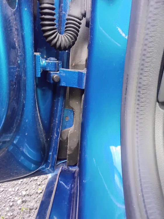

I'll try and have a look at the wheel arch liners tomorrow, not many tools here and hard to work on the car. My back usually gives out..
I might have some torx bits here but they might not be large enough. I have a bigger set a work but not back there until Wed.
Do you know where the plenum chamber drains are and where they appear under the arch?

Ah maybe the facelift has the grille as standard, ours is a 2016. 👍
The scuttle cover is fixed into a channel at the bottom of the windscreen, just lift/bend it up rather than trying to remove it from that channel. As far as I'm aware the drains just go straight down into each wheel arch, easy enough to test by using the front washer and watching it dump all over the floor. 🤣

On my wife's Mk3 the plastic black cover lifts as whitedot has described but the right hand side (UK driver's side) is very restricted by the wiper arm, whether it's easier with wipers in the "service position" I don't know. - ETA: in your photo of the left hand side (viewed from rear of car) black plastic cover thing it looks the same as on my wife's 2016.

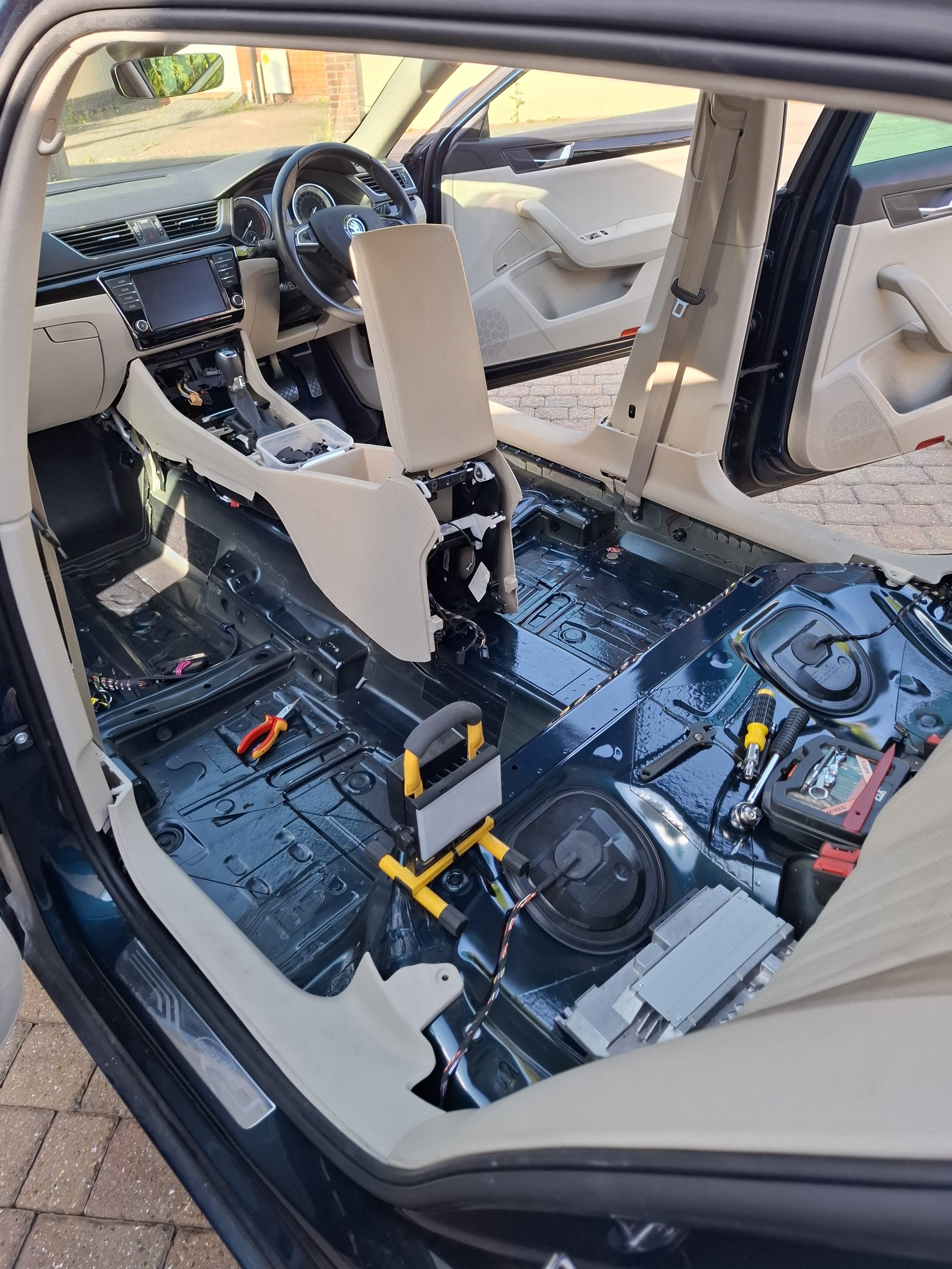

Don't have a Fabia, but this happened on my Superb due to a blocked sunroof drainage channel.
Your alarm problems are likely due to water getting at connectors/computer module under the passenger seat.
Like you, I read that it might be water ingress around the scuttle/pollen filter so:
  • Windscreen wiper arm removal - back off the nuts at least a couple of turns, and then it's just a push-fit into the spines on the fitting - use a coin and a mole grip to push them off (add a couple of drops of penetrating oil/WD40/whatever and leave for 30 mins if this proves difficult)
  • Scuttle cover removal - obvious fasteners on the front, but it's just a tight push-fit into the channel by the windscreen, so you can lift it. May be quite hard to lift an initial corner, but it will go. Pick whichever side is easiest to start with and work inwards from that. Mine was also a bit brittle from UV exposure as it's lived outside for ten years; take care you don't tear the plastic.
  • Cleaned it all out as there was some blockage, but nothing sufficiently incriminating, though.
  • Figured out it was the sunroof drains, so pulled the A-pillar trim off, disconnected at the scuttle end, cleaned them both out properly and reassembled.
Drying it out:
  • Unlikely to need to remove door seals; the plastic sill trim may sit just under the lip of them, but you can pull it off from the lower interior side of it. It's just clipped in, except perhaps around the seatbeat anchor where you may need to unclip the two sections - elsewhere just yank it pretty much straight up and it'll click out; the clips are pretty robust.
  • You can then peel up the edge of the carpet enough to get under it properly, at which point you will discover the soundproofing under it is extremely wet, and decide you need to invest in a wet & dry vac (e.g. from Screwfix) so you can pull out what will be a proper puddle of water from underneath it all.
  • You will then decide that no dehumidifier/vac is ever going to be able to dry out what is essentially a sponge, under a carpet, in a drainage-less tray of wetness. :-/
  • You will then decide you need to remove the carpet and sound-deadening underneath it and dry it all out properly
  • So I ended up:
    • Removing both front seats and computer under the passenger one (this will be what's causing your alarm problems, probably) - needed to buy a dedicated triple-square (XZN) bit to do this (amazon)
    • Removed rear seat squab (mostly just clips in, need to push hard downwards to disconnect the hooks under the back of it)
    • Detached and lifted the center console, so I could get the entire carpet and sound-proofing matting out to dry them out. This took the most time by far.
    • All in, took a whole afternoon to figure out how to get it all apart without breaking any clips or connectors, although it went back together easily enough.
    • Shampooing the carpet and hanging it and the soundproofing mat over a climbing frame in the summer for a few days to dry it out properly.
The soundproofing matting was utterly sodden and very heavy - literally litres of water poured out of the corners when I hung it up. I am certain it would never have dried out in the car in UK weather even at the height of summer, let alone this time of year.

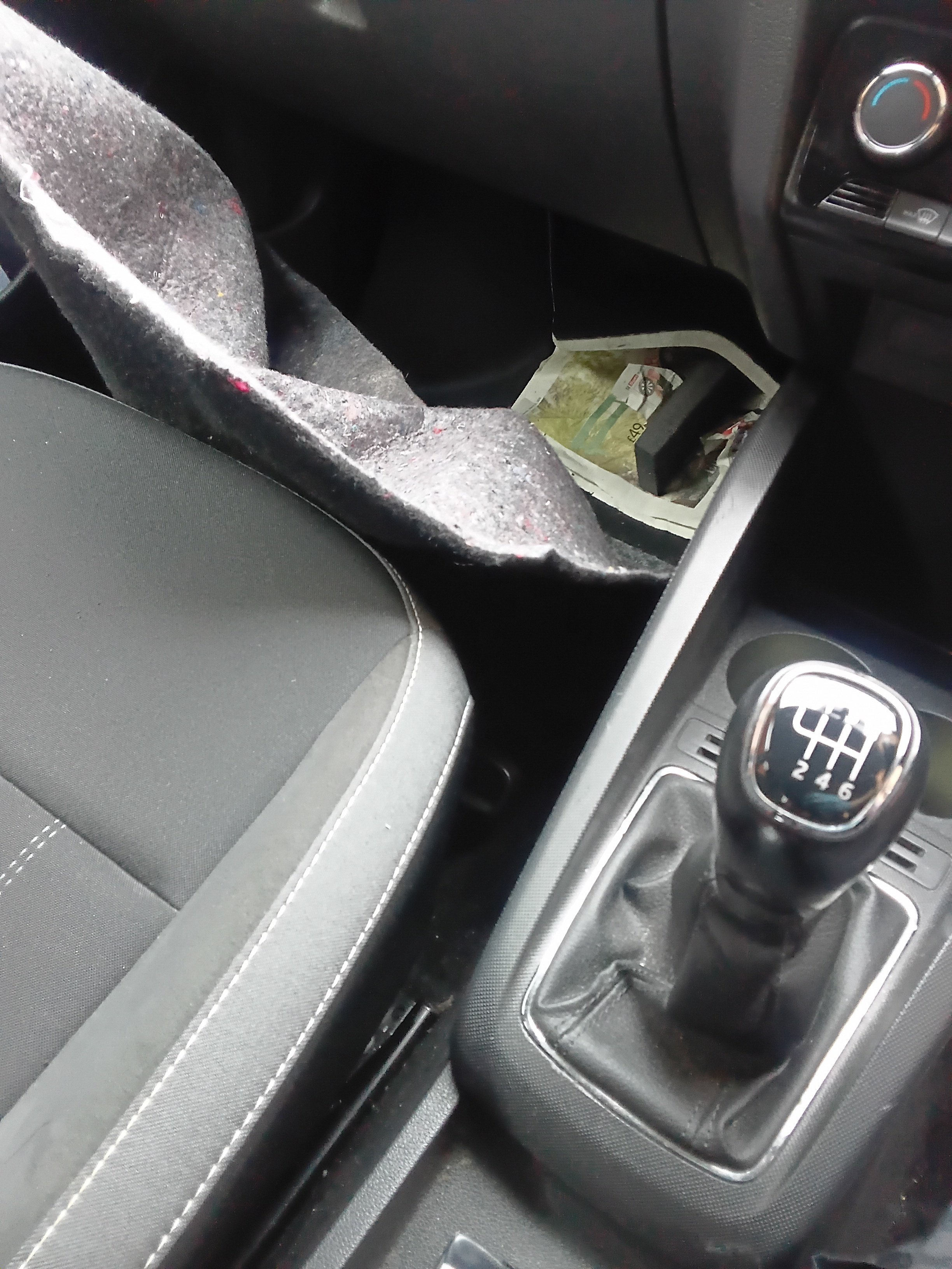

I managed to pull back the carpet enough from the centre console.

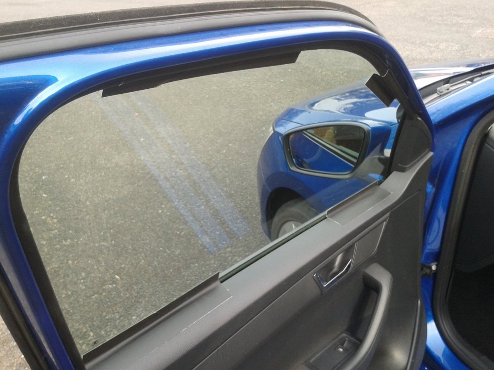

Looked at removing the door trim but it looks like its the whole length of the car and a section above between the doors.
Its completely soaked under there. All I've been able to do is direct a fan under there and run the dehumidifier again. I ran a fan heater at it for a while as well to try and speed it up initially.

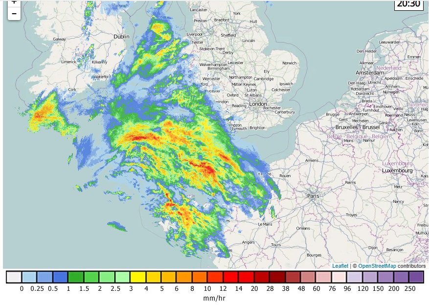

There's a big storm passing through tonight into tomorrow just to add to the problem, loads of rain....
I've made use of the half car cover i had, hopefully that will keep the worst of it off. Unless the wind has other ideas...

If it's a really storm you might need a net over the top cover to hold it on. Other side of the coin if some air gets under the cover it might lift some water off the cover and less wicking through perhaps (depending on cover material).

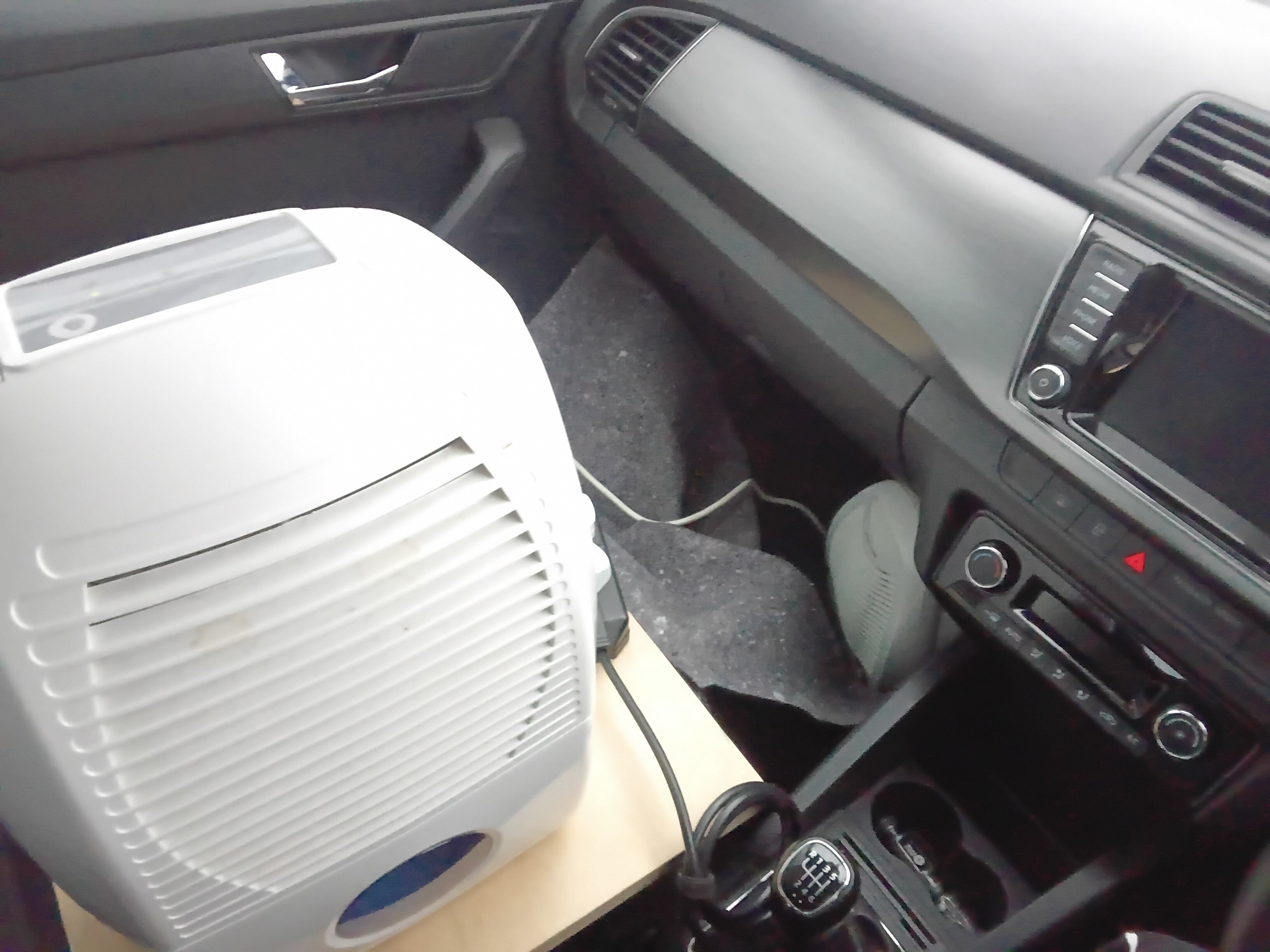

You have the room there in the photo to do the work but not the weather.

Though not ideal way of attacking the problem the dehumidifier is helping to pull moisture out. I poured quite a lot out of it on Sat / Sun.

In coming storm pic, hopefully be more on the edge of it here as seems to be tracking north. I'm in the middle southcoast. Not much better tomorrow either last look...

Dehumidifier has pulled a fair amount out in the last 24hrs, the front section of the passenger footwell seems dry now. The extra fan will of helped getting air movement around down there under the carpet. There's another bit which i can't pull away up top so that could still be wet. I've been stuffing chunks of foam under anything that moves to create air gaps.
I just blasted it again with a small fan heater under the seat area / up under the dashboard to get the temperature right up in there and set it off again.

Hard to say if anything has got in over night, plan is to get some newspapers up under the bulkhead where the foam was soaking wet. Then see if anything shows up.
Also hopefully it will soak up anything that comes in and not undo the drying out down lower.

I've had the cover over the whole top of the car so all the glass is covered, just leaves the plenum chamber area exposed.
We had a lot of rain over night, people up the road have woken up to flooded houses and people trashed their cars trying to drive through the adjacent flooded road.
Got the car booked in for next Tuesday which is better then Feb 17th they told me yesterday...
I'm really limited in what i can do here and its really not the weather to be pulling the car apart outside. On top of that i have nowhere to store and dry out the carpets / sound proofing that's not outside.
I will do the easier jobs on the car but once it gets more involved i just have to give it to someone to deal with it these days.

I'm still finding wet foam sound proofing, just been trying to get fresh air around it when possible, been at work this end of the week.
I had the brain wave to line the footwell under the now much dryer carpet and sound proofing with some thick like plastic rubble bags and then lined out under that with news paper. Then can check where its going. Still got the half cover over it and also covering the plenum chamber area now.
No idea what's happened on the drivers side as not lift the carpet.

Cars been into the dealers this morning, for 1 hr so they have done nothing... I told them it was a water leak at point of contact so seems like it was booked in wrong.
All they did was get it up on a lift for a vehicle health check, give me a list of things that need sorting. Including a passenger side window regulator!
So back in it goes next Thurs for what should of really happened today.
All the interiour is coming out and they will do a leak test (£624). Then the costs to fix whatever they find on top. 3 or 4 days with them i guess.
Hopefully the window regulator will be covered under the extended warranty i took out, they said its noisy and likely to fail soon. Can't say i noticed that one.
I have no choice but to let them get on with it, i can't really deal with it here and nobody else locally would take it on. Which i totally understand.

Had some news back from the dealers yesterday.
They found a seam was leaking and resealed with some gunk.
Might get to see some pictures as i think some got taken.
Hopefully they can sort the window regulator out under the extended warranty, i can't believe those are still an issue. Even going back to when i had a VW Bora, they failed on that.
Just got the car back, £624 later....
Time will tell if they've fixed the leak, a load of rain coming in later for the next few days so find out sooner than later i guess.

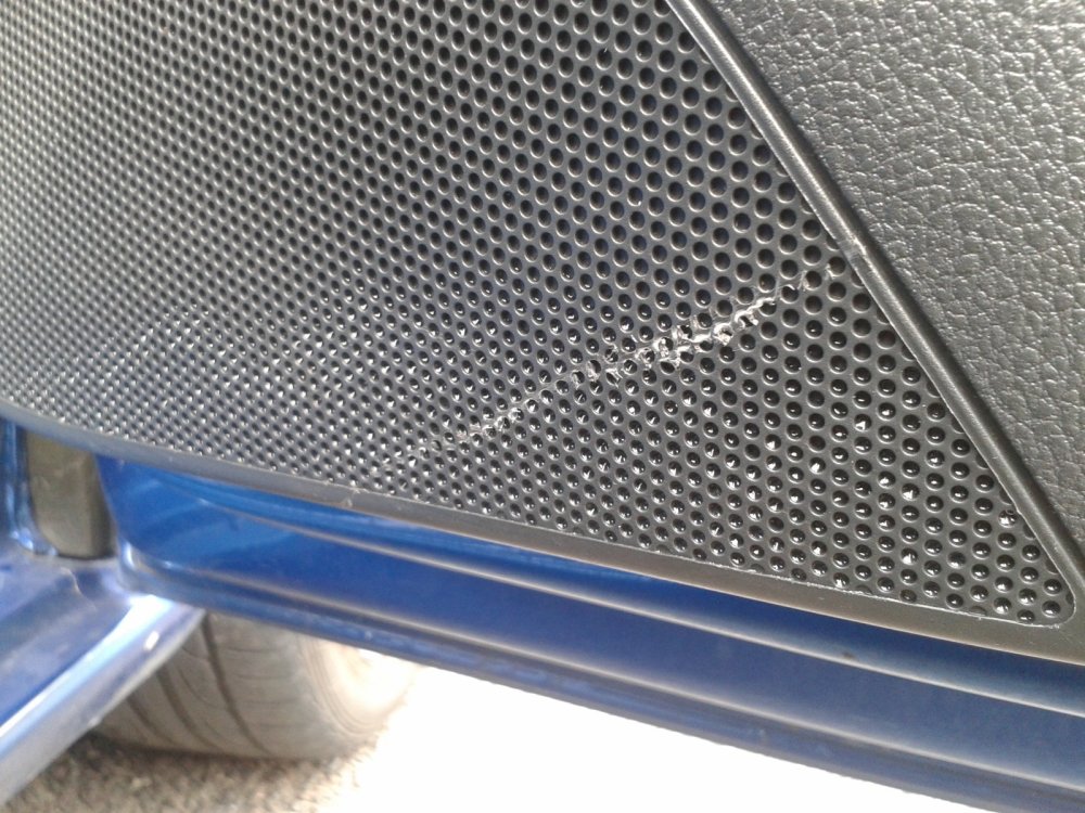

So they intially flagged the passenger window regulator being noisy but didn't end up replacing as they felt it wasn't bad enough for a warranty claim (taken out extended warranty...)
I get home and think I'd ought to just try it as wasn't aware it was a problem. Straight away as it moves lots of horrible grinding noises and the window only moves on one side. Something went ping as well.. Managed to get the window back up and taped it just in case it drops.
They also managed to get the drivers side footwell rubber mat and door seal along with the door speaker grill soaking wet after washing it. Bearing it mind all the interor has just been removed and dried out...

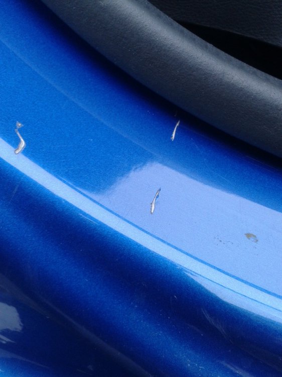

While clearing the water up i notice fresh paint damage and a dent on the door sill. Also the speaker grill has a long deep scuff across it.
I guess the paint damage is where they removed the seats.
So now its going back in next Monday FFS.
Really not a good look or experiance from the dealer, been going there for years and never had a problem in the past...
Edited by Gonzini
We all make mistakes and have accidents but to just not mention these and ignore them just shows a lack of pride or acceptance of lower standards, it's not like you weren't going to see them when you got the car back. Perhaps they contracted the job out, to some ex-delivery drivers!
This was unexpected to me but unfortunately not a surprise. I feel for you as I've had similar poor quality work before, more than once but that doesn't help you.
