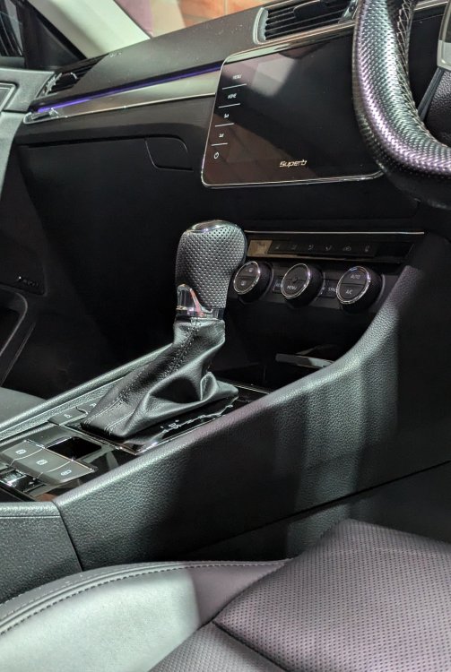

VAG DSG gear knob swap
Just wondering if it’s possible to swap the current Skoda DSG gear know with a Mk7 and equivalent DSG gear know which is slimmer and seem to be in the other VAG cars and not Skoda
6 speed version to 6 speed
Don’t think it’s speed-dependant.
@JR RS has done it. Check out his project thread. Not sure if it was just Superb specific but I’ll bet my wisdom tooth they mostly if not all switch between. It was a thing to switch to a Kodiaq one too I think

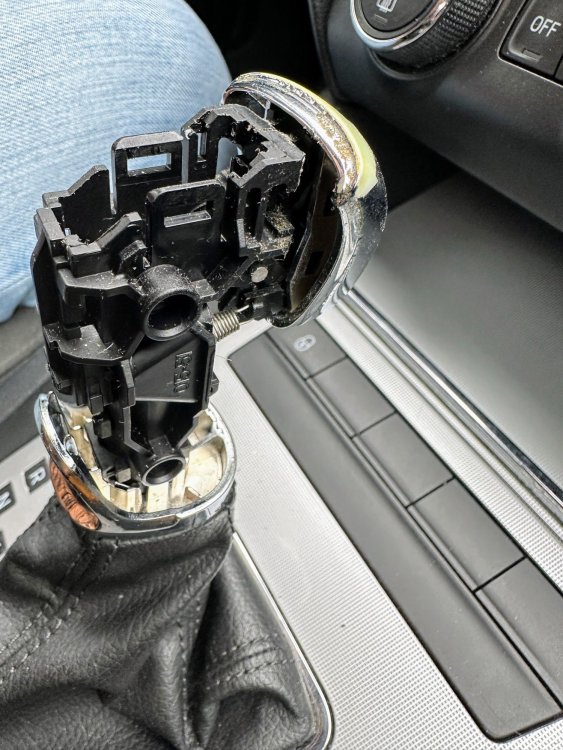

Just wanting to know if I need to pop the top of the gear know to disconnect a link inside it

@tombee - yes, u do need to to pop the top cover off if u plan to remove the entire shifter. it makes it easier to unhook the shifter linkage.
there quite a few vids on youtube showing how to remove the DSG shifter. i watched a couple of different ones before i pulled my apart.

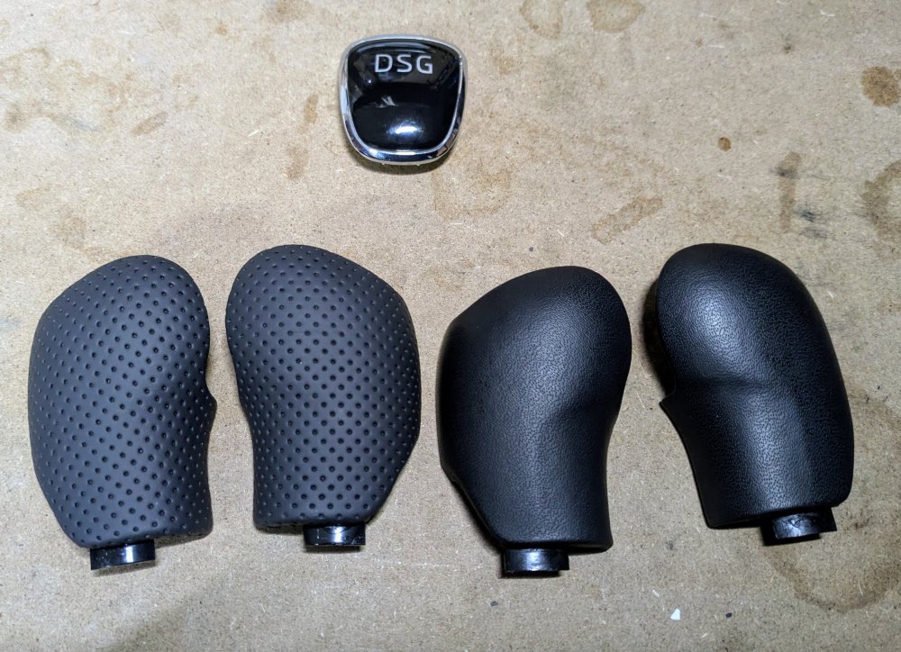

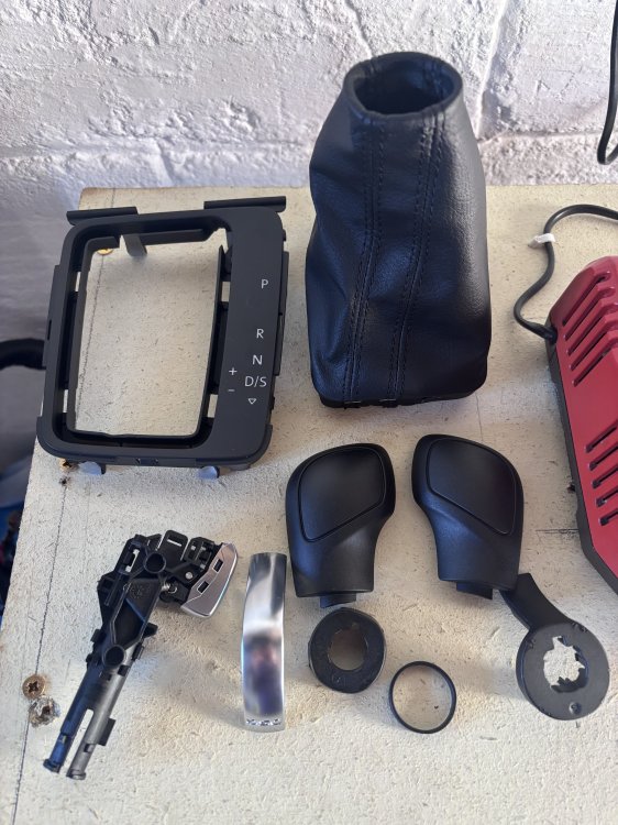

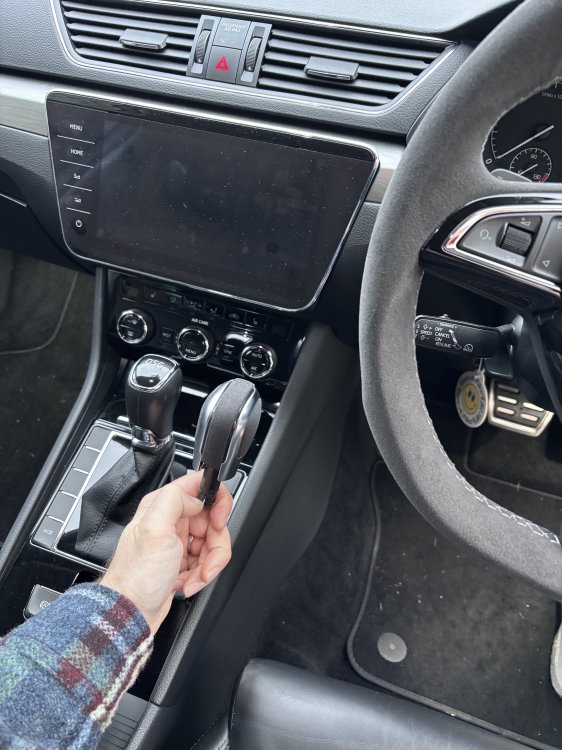

Some of the parts have arrived, gotten a new MK7 shifter knob and leather gaiter, so have removed them from each other now.
Just waiting on the gaiter and gear know insert, but now I am wondering about changing the sides of the gear knob like you have done @JR RS but for the Mk7 shifter knob

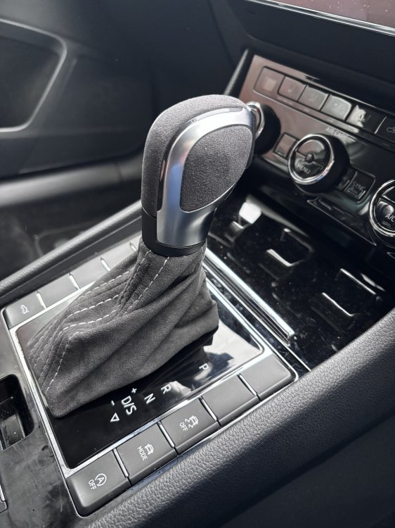

The Alcantara side and top items for the gear knob have arrived, just got to wait for the Alcantara gaiter to arrive
But I am happy how the colour matches the steering wheel.

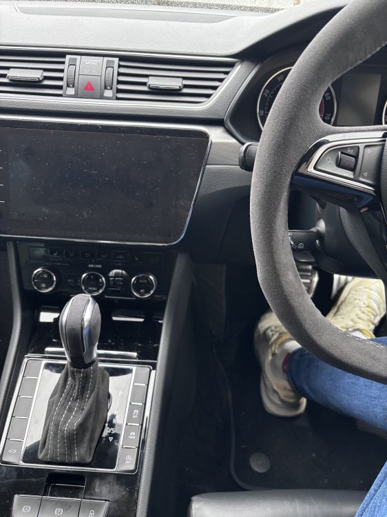

The gaiter arrived this morning and had the Skoda gear knob off earlier, was a lot easier than I had thought, thanks to @Binx1310 for the manual to confirm.
Had to trim the new gaiter as for a mk7, with then gluing on the new to existing Skoda surround to then mount in the DSG panel.
Fitting the new gear knob was easy also and it came with a new metal clamp ring also.
I am very happy with the results of these bits matching the steering wheel.
Looks good. I found with mine i got a bit of whitening of the gloss black around the gaiter from the superglue fumes. I think I was a bit impatient putting it all back together!
WD40 on a cotton bud cleans it off though so all good now.
