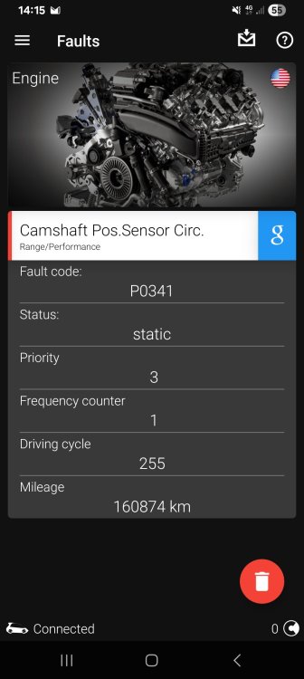

I have diagnostics again never had P0341 before on my first diagnostic, MAF is above the level. I have cleaned. Need new MAF and cambelt sensor.
I would change cam sensor first and see if the MAF sensor calms down before replacing both.

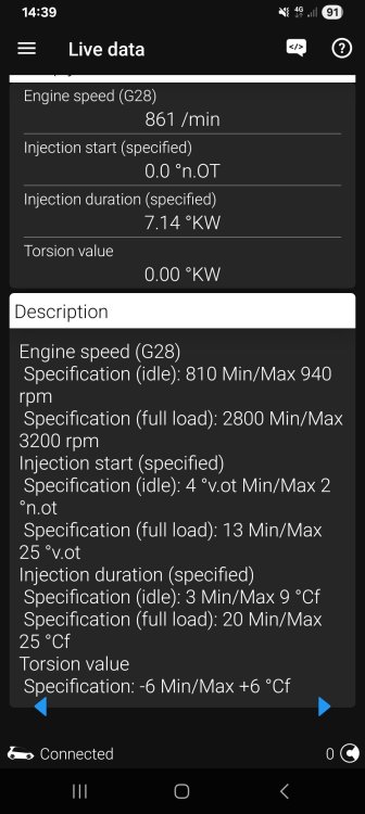

I have fitted the cam sensor, no error. I have adjust torsion value at zero if that's correct?

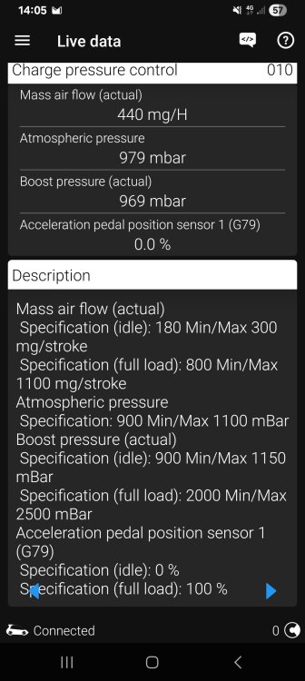

But the air mass was 477 mg/stroke over the limit of 380.
So I have bought OEM MAF rather than Chinese.
Now it reads 556 mg/stroke.
But the car runs lovely plenty of torque under 1,800 rpm.
Anything to worry?

I mean over limit of 300 mg/stroke not 380.
