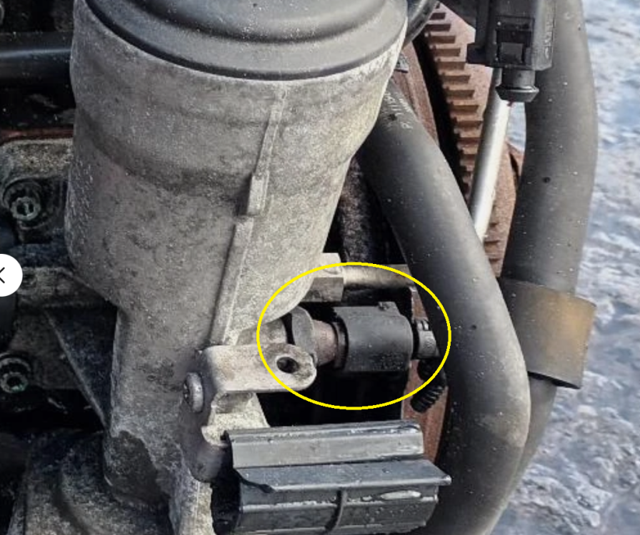

Where do I find the oil pressure sensor on a 1.9tdi pd? (BKC build fyi)
Tom
  • Sponsor
Down between dipstick tube and oil filter housing, I think
  • Sponsor
This must be it:
