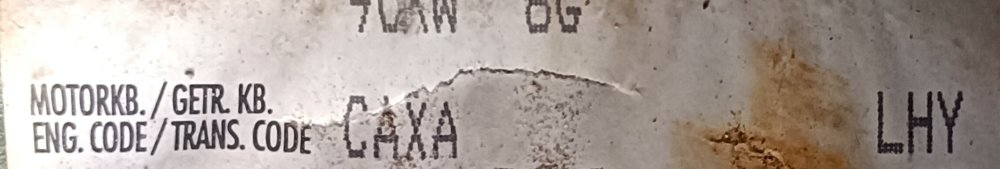

IMG_20260513_214310.jpgHi all,
Noticed a slow oil leak a few weeks ago. Oil level seemed fine so I ignored it, like an idiot.
It seemed to get worse (oil leak, car still drove fine) so took it to my mechanic. He seemed to think the gearbox gaskets and sump plug needed changing. Plus a gearbox oil change. £300 lighter we collected the car. 2 days later and it's still leaking.
Took it back and now he thinks the gearbox has been run with oil level too low so it'll die soon. Dunno how he didn't notice that last time. He suggested I 'nurse it's for now' and look to get a new gearbox. No charge for this diagnosis.
Car seems to run and drive fine.
So I've got to find a decent used gearbox and he'll charge me £300 to fit it.
Provided I match the engine code and gearbox code (and model/mark, engine capacity etc...) can I just buy one off eBay?
According to the sticker on the boot floor I've got a CAXA engine with an LHY gearbox. Presumably any gearbox with these codes should fit, right? Of course I've no real idea of the condition of the used gearbox but presumably it'd be better than mine.
