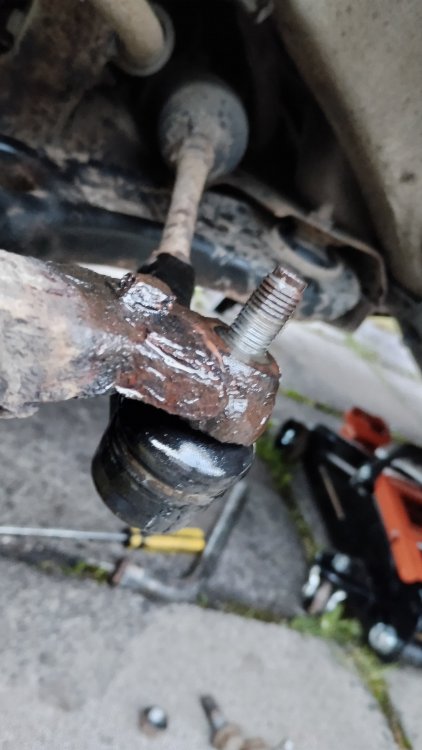

1: Getting the spindle out of the track rod end. It won't budge, even with heat, penetrating oil and some serious hammer blows.

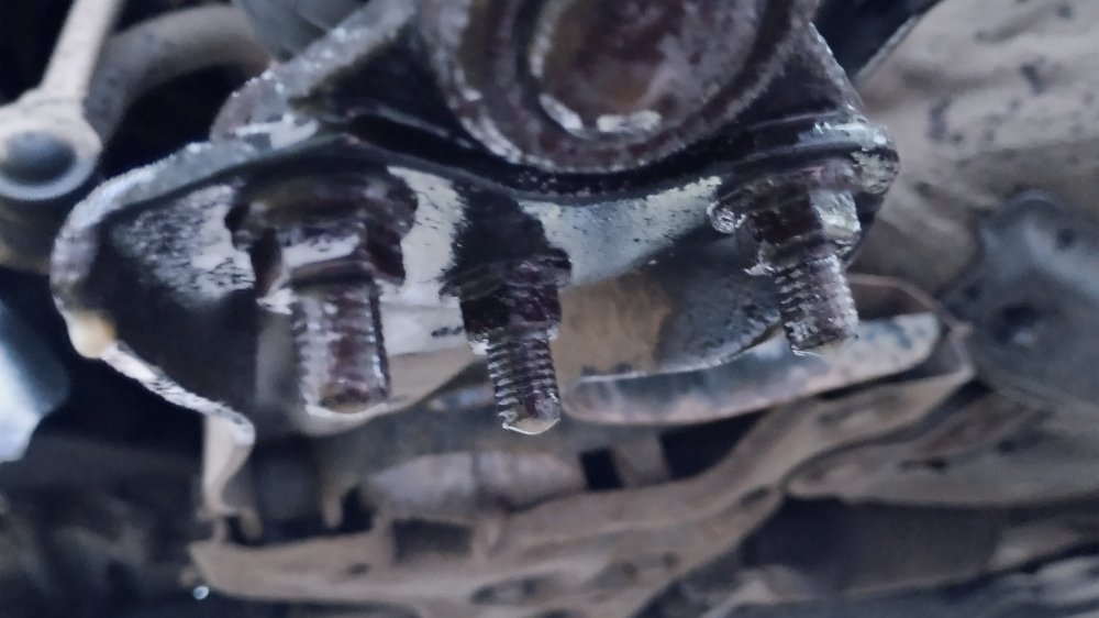

2: Removing the 3 bolts from the control arm to loosen off the hub. These bad boys won't budge.

The 2 hammer method should be safe to use and shock that taper free, failing that refit the nut upside down and use a ball joint separator - the scissors type and not the “pickle fork” if you want to reuse the TRE.
