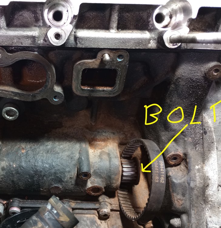

My 1.8tsi Octavia scout coolant pump was leaking via the impeller. I'd like to change the small belt (not the big timing belt!) that spins the impeller as well as the pump etc but the left handed bolt is stuck. I've not tried too much force as the captive gear it holds moves when I try and I'm concerned that I might break something internally. Would anybody have any experience removing this bolt or known methods of doing so?
The photo shows the gear and the bolt I'm refering to is holding this gear and is just out of sight.
Thanks

I have not removed one but if you are saying the pulley turns and this the engine turns when you try to undo the bolt, maybe try locking the engine up.
If manual try in gear with handbrake on.
If auto or dsg need to use a breaker bar on the crank pulley
On 08/06/2026 at 12:53, Flyinghigh said:
My 1.8 TSI Octavia SCOUT coolant pump was leaking via the impeller.
I'd like to change the small belt that spins the impeller as well as the pump etc but the bolt is stuck.
Would anybody have any experience removing this bolt or known methods of doing so ?
The photo shows the gear and the bolt I'm refering to.
⚠️ That bolt is LEFT-hand threaded ! ⚠️
You can't break anything internally.
You must hold/lock the pump gear when attempting to loosen the screw by turning it clockwise.
