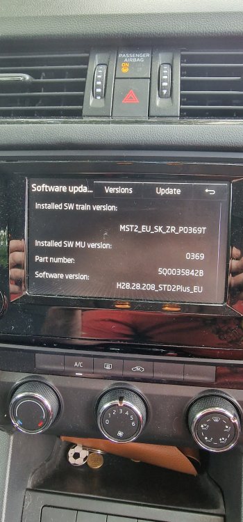

Which unit is installed ?
Here is a picture of the version and part number
You have a unit only with 1 SD Slot.
Patch only works direct on emmc with QNX
Yeah I had to post if off to get the smart link for Android Auto activation.
If I could do the same for that I would or I was thinking of buying the glovebox unit as well as the screen which would be on the right version but the problem is the CP on the 2nd hand unit.
