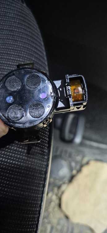

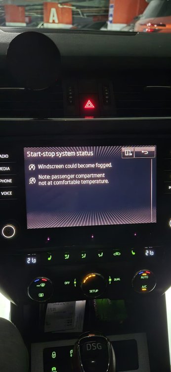

My air conditioner isn't performing well and is showing these errors on the display. The windshield was replaced a few weeks ago; could the sensor be the cause? When I checked the sensor, it looked like this.

The two messages are simply showing the reason why Stop/Start (idle stop) is being inhibited - not for A/C errors.
You will need to get any fault codes (DTCs) read to find why your A/C is not performing correctly - it may be short of refrigerant.

I changed the sensor and all problems gone.
