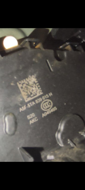

Hi, I have a problem with my rear passenger side latch not locking. I removed the door panel and took a photo of the part and the number seems to be A5F 5TA839015H.
Any recommendations on where can I buy this from? I had a quick search but I wasn't able to find the exact match. Are there any compatible variants for this?

Photo of the part attached Screenshot_2026-07-05-13-43-47-385_com.miui.gallery.jpg

Skoda parts list two superseding part numbers, with latest being suffix-T by the looks of it:
https://www.skoda-parts.com/spare-part/5ta839015t-door-lock-rear-left-skoda-44668.html
