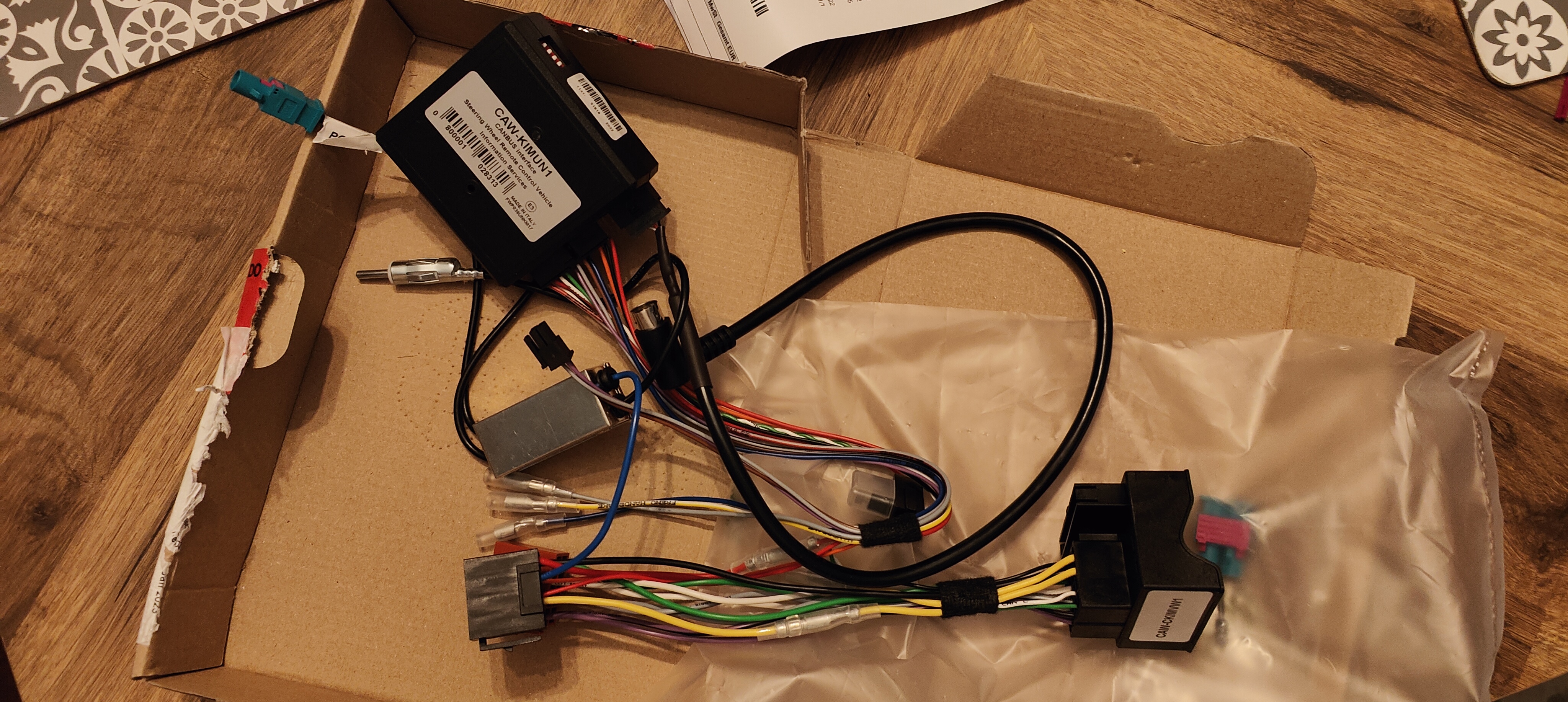

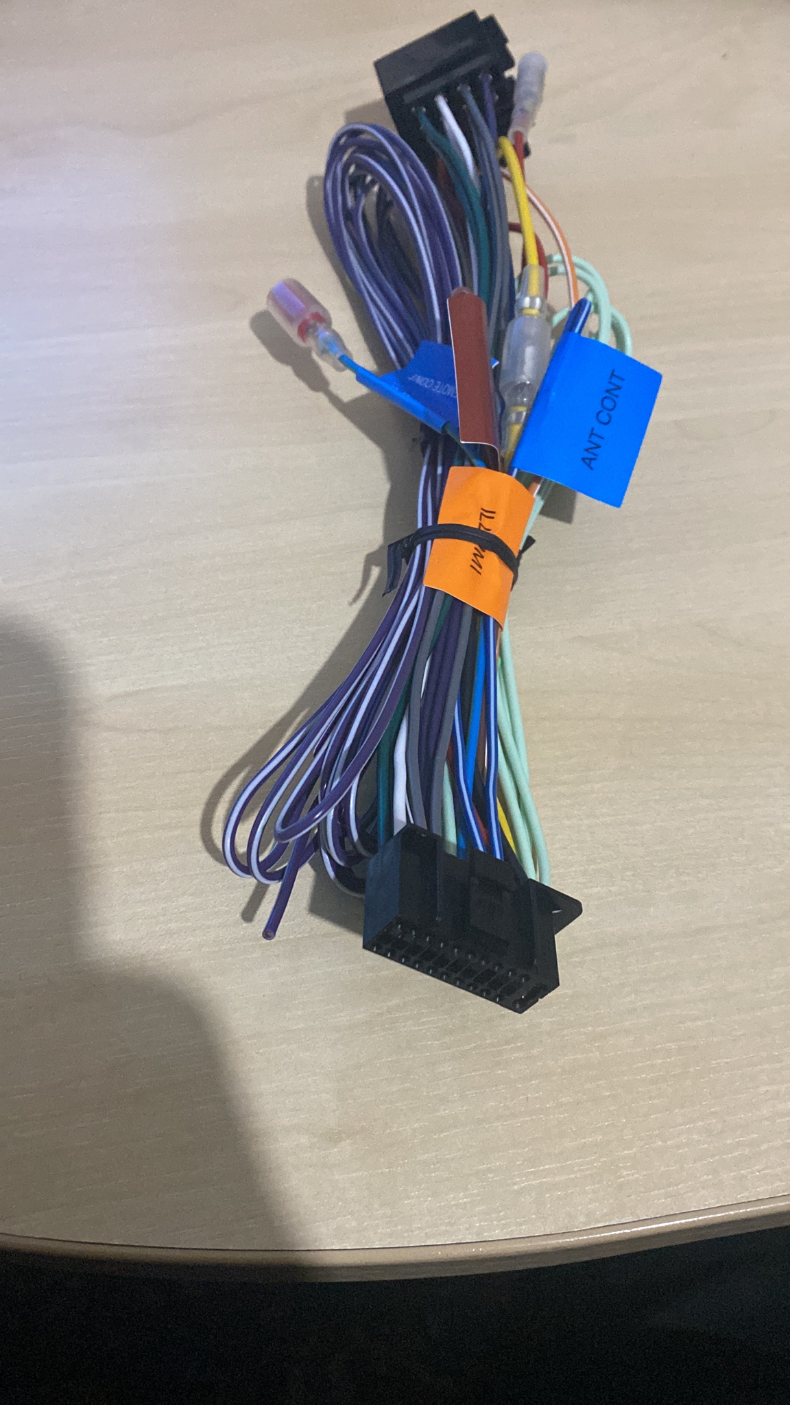

  5. So am update on this old thread I started a while back in case someone else finds it useful, I have managed to get steering while control functions (all be it minus phone answer button) climatronic display and park pilot display. I installed the Kenwood CAW-KIMUN1 canbus interface, which I got on eBay, which is also available online but I only found them in Europe. This interface comes with only one 7pin plug that goes into the head unit, which I assume provides all canbus related info for the head unit. You also need the adaptor harness for this which connects to the cars quad lock stereo connector part number CAW-CKIMVW1. Now in the picture I saw it showed it fitted with Kenwood's stereo adaptor but it came with standard iso plugs. So I then had to get a Kenwood power harness, from eBay, it came with a few extra cables for parking and reverse signal. I didn't bother wiring them in but I have no reverse camera and not bothered about watching DVDs. It's worth noting that connects2 do a info adaptor for this unit as well but I wanted genuine Kenwood. Kenwood advised not using the canbus adaptor and harness due to incomparability ( 2012 on) but I have updated my canbus controller and fitted the facelift steering wheel and wiring to it, so it worked fine (pre FL) may need earlier Kenwood interface. This info might be old news or irrelevant to most folk due to newer Kenwood head units not needing canbus module, I only went down this route due to the ridiculously cheap price I paid for the head unit, I did end up paying for the harnesses and canbus but it didn't bother me, still paid less than getting a boxed unit with all accessories going off what the prices were doing on eBay at the time. I hope this info helps anyone in a similar situation, when I did searches on the topic I was still left with questions mainly with comparability with MK2 octy, and dnx521dab.

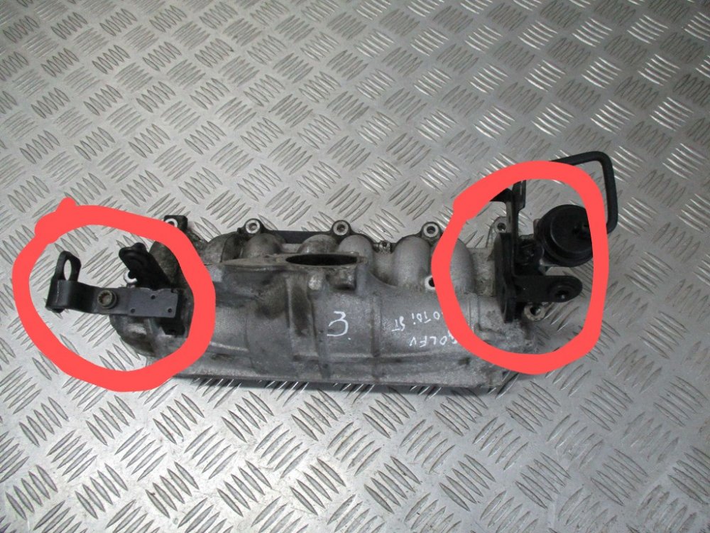

  8. Hi had a faff trying to find correct brackets (which cover clips to) for inlet manifold 03G129713h which is the alloy one with swirl flaps. if anyone is interested the part number are 03G103941S (drivers side) and 03G103941R (passenger side) these brackets should fit non swirl flaps alloy inlet manifolds too for those who wish to keep engine cover on after plastic to alloy inlet swap.

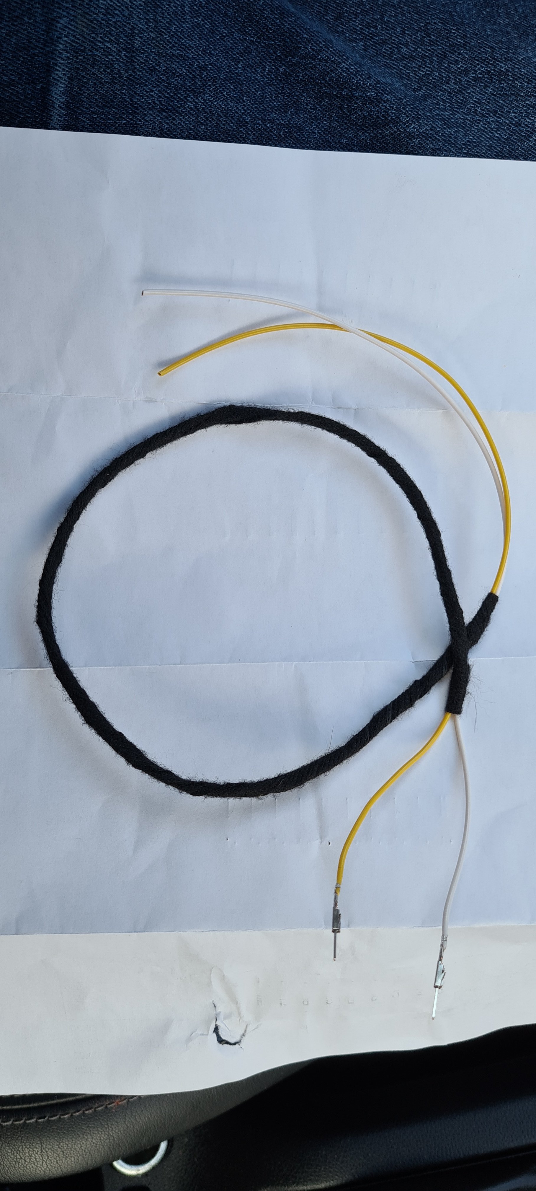

  9. Bit more info, the 2 pin connectors required for wing mirror to A pillar is 1J0973332, you can get that plug with pins or get one from breakers. Just so happens its used on drivers side door to power the little LED for alarm. I found a couple and spliced repair wire in to make the loom.

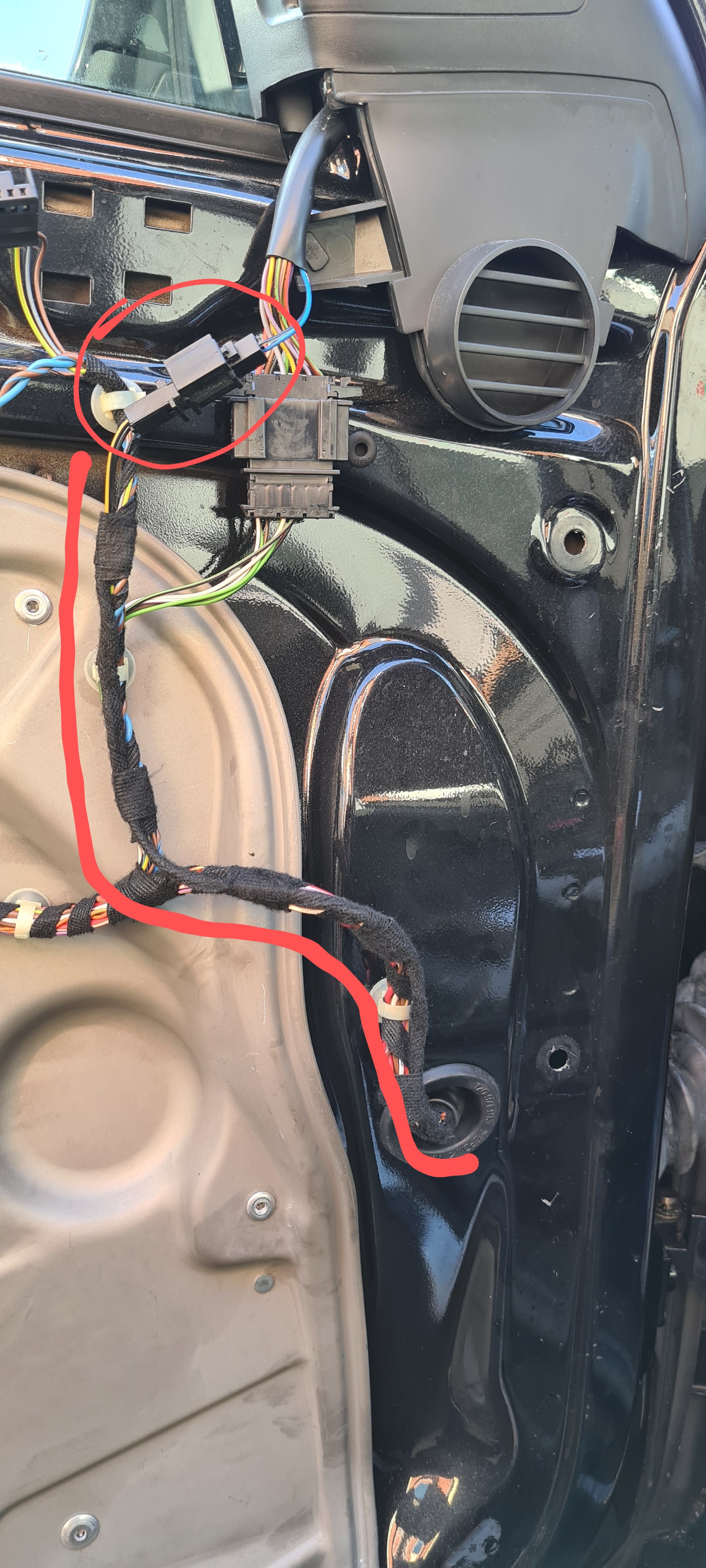

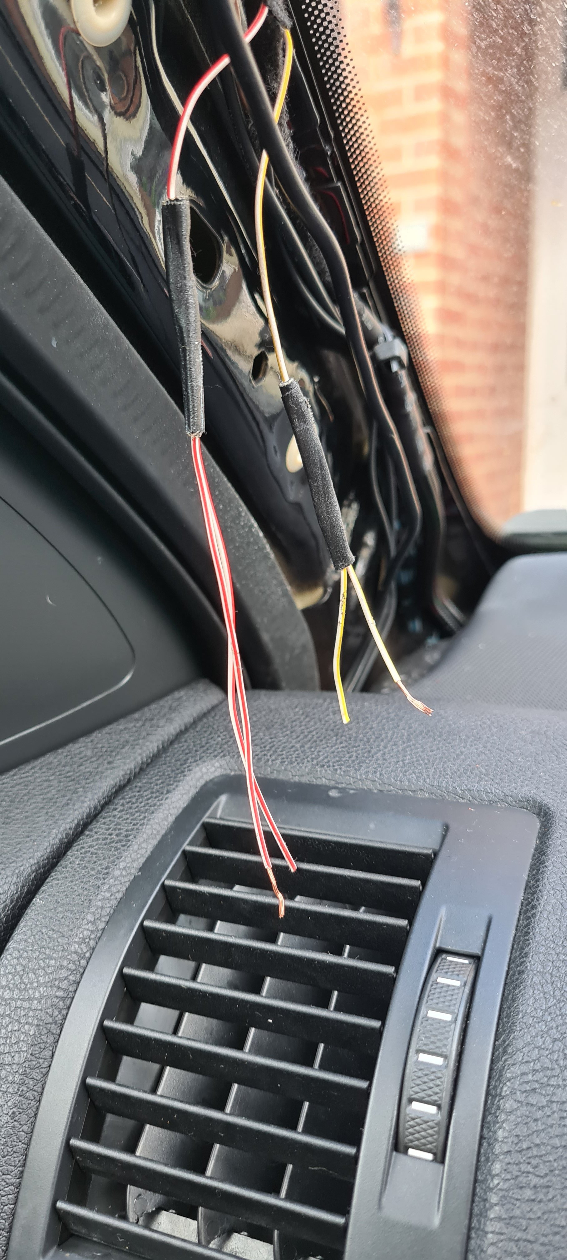

  11. Update on the auto dim wing mirrors, all fitted and working, couldn't run the wiring through the door controller as it didn't have the pin outs in the module so bypassed. Attached a few pics of the wiring in case it helps anyone else who wants to fit auto dimm mirrors. I didn't fancy laying another loom in the guts of the wiring behind the dash so ran the right hand side down right A pillar. Door connectors were easy as the pull out door side giving easy access to plug for wiring up signal wires from rear view mirror to A pillar door wiring connecter.

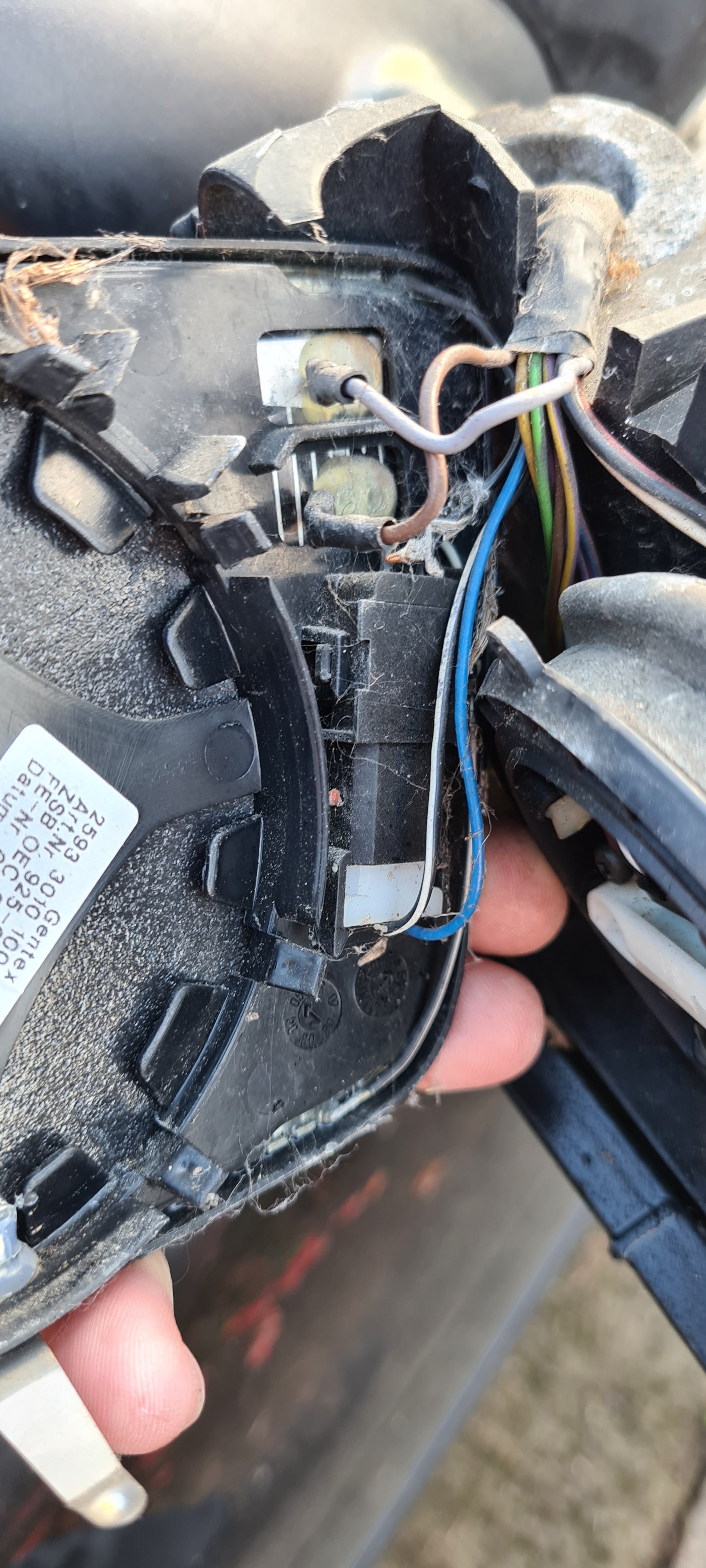

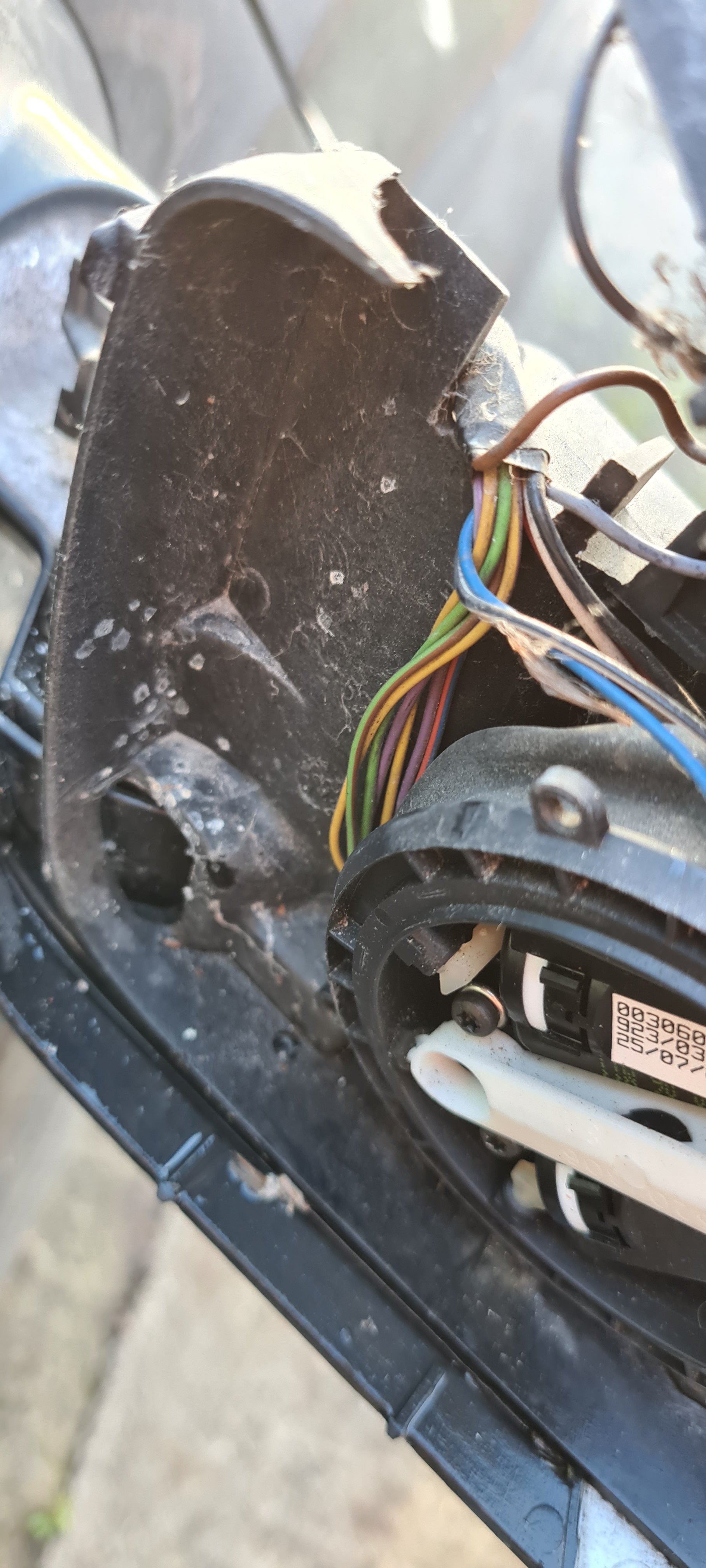

  12. Decided to take apart the mirror to check wiring, looks like the 2 pin connector is for auto dim, all the extra wiring appears to be for the mirror motor/memory function i presume, i can't see any folding motors in there, unless its well hidden, luckily the puddle light wiring was already installed, just vcds coding required. I'm only really interested in getting auto dim functionality so getting that working should be pretty straight forward from here, apart from routing the bloody loom that is!

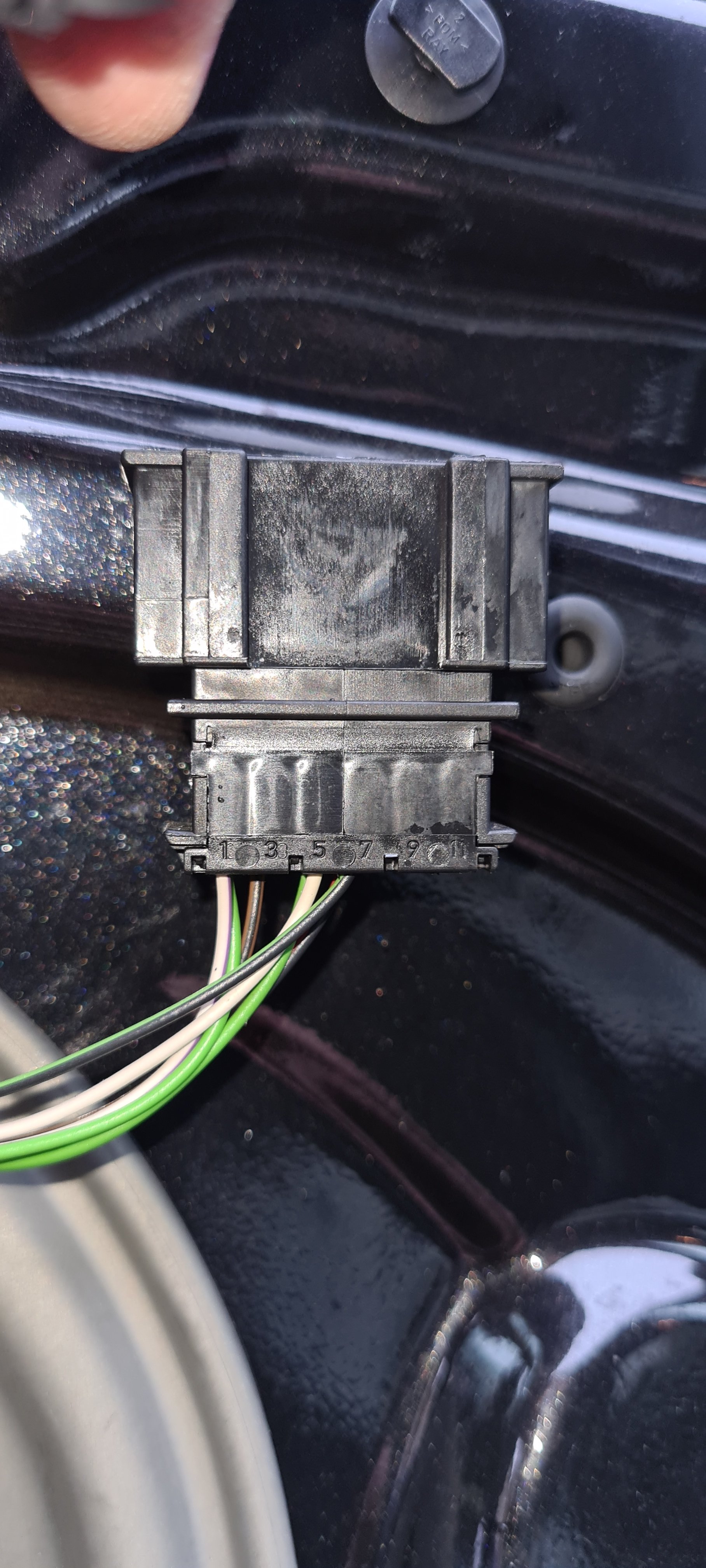

  14. Meh easy come easy go, I've only written off one wing mirror in 20 years so hopefully I will avoid that issue 😆🤑🤑🤑. Pretty much all of the pin positions on the plug are filled, with the addition of the extra 2 pin plug, only things I can see extra over my old mirrors are puddle lights and auto dim. Alot of extra wires just for those two added features. Attached is my door to mirror plug 7 of the 12 pins are used compared to 11 of the auto dim mirrors.
