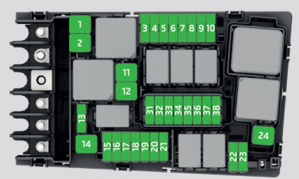

Could someone also threw some pictures of the fuse box in the engine bay? I lost one fuse and I can't remember what Amps it was.
The most power drop was on the 646 relay, left one, near fuse #21 when looking at the fuse box in the engine bay.

If you  leave the 646 relay in but remove fuses 22 and 23, one at a time, see which one, if either, reduces the current the same as removing the relay.
