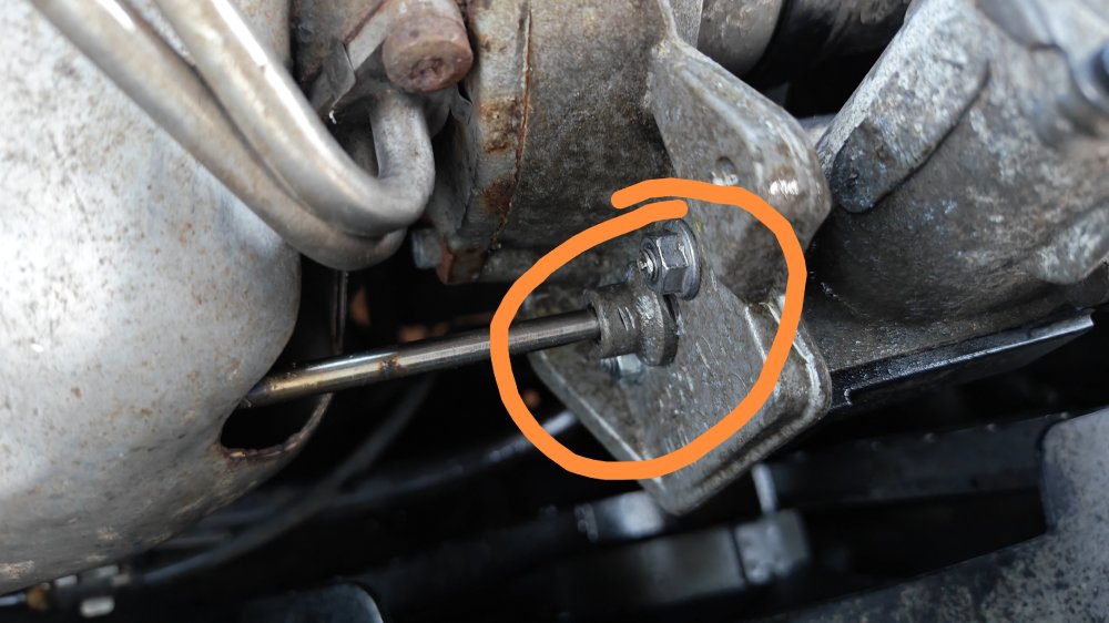

Hello peeps, had a few issues with my actuator lately (suprise suprise) seems to be extremely common.
EPC Engine light every now and then and slight missfire when engine is under boost.
Car in question:
2012 Skoda fabia 1.2 tsi.
Anyway,

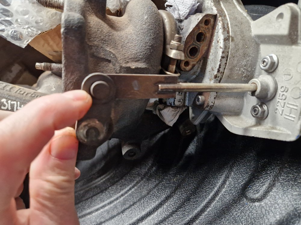

I noticed there are 2 sizes actuator arms
110 and 116mm (116 seemingly being most common)
So I thought I would take mine off to measure it to avoid having to send one back, how ever, the housing seems stuck?!
So my question is does the bit (circled in orange) come away with the actuator? Or is that cast of the turbo housing? Absolutely won't budge (tried lots of tapping and twisting)
If so what am I missing? Looks to me like the whole thing should slide out?
If it's rusted in I'll give it a more of a going over but thought I'd make sure it actually does come out first before going to town in it.

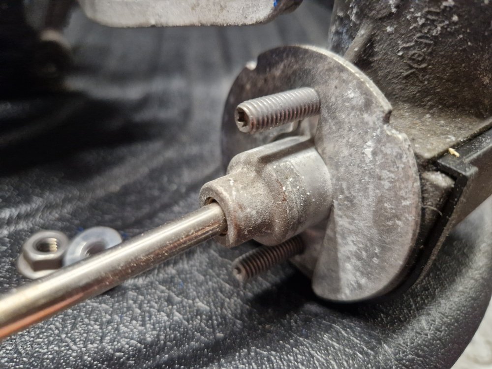

The issue is the actuators flared end won't fit through it and there for is stuck in.
Ps... Yes I had removed the nuts first 😆

It's a yes.
Not clear from your pic, but presumably you have undone this end? -20260920_203821.jpg
Yes mate that's how I knew it wouldn't slide through it..
Looks all ally to me as it's gone that white sort of rust you get on it so prob sized and a bit soft to wack properly
I'll try and get it out properly with a punch.
Just making sure before I put a hole in the housing trying to remove something that can't be removed and end up needing new turbo hahah
Edited by V8Sam
  • Sponsor
Loosen the nuts enough that they cover the ends of the studs, then give each a 'pop' with a little hammer.
