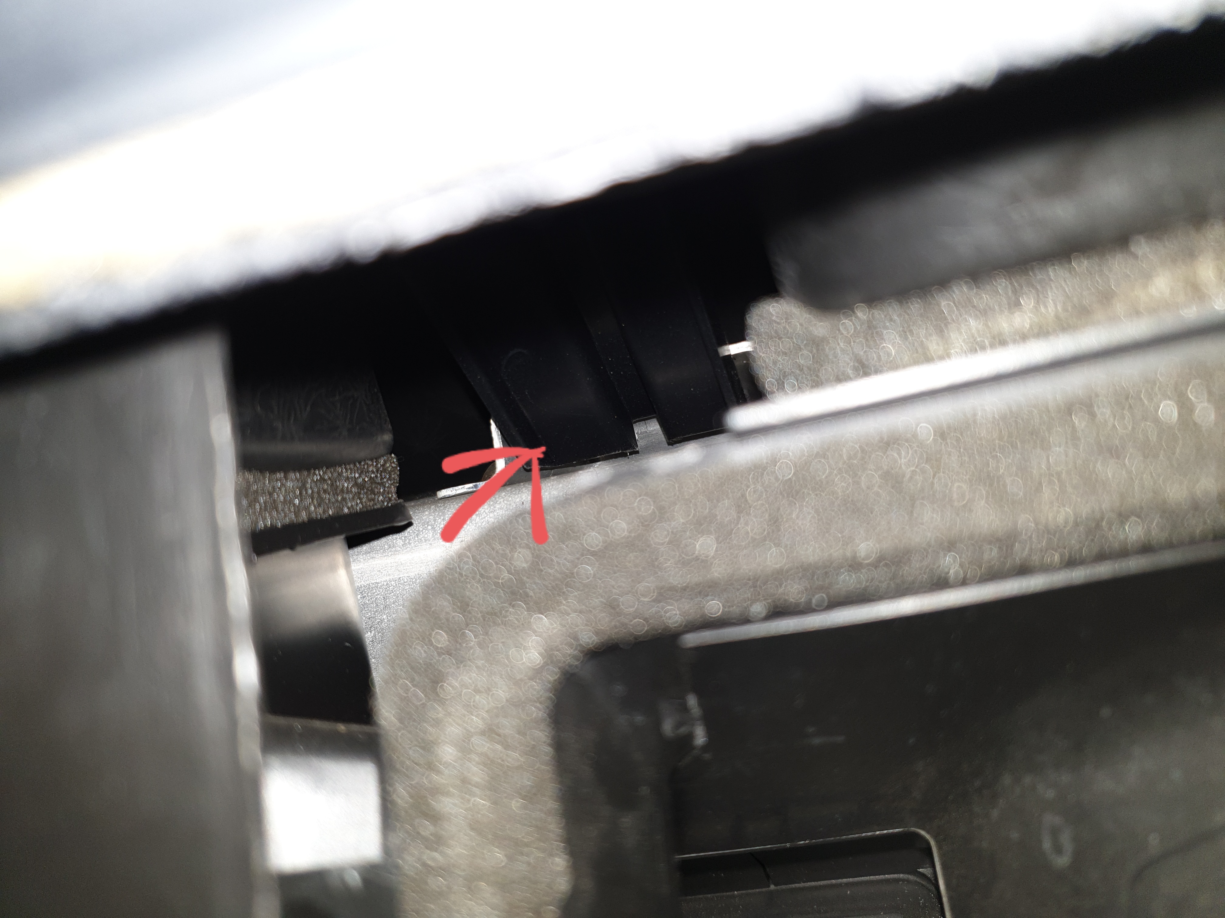

Sorry to resurrect such an old post but I just can't find the top hat piece. Is it the black plastic part pointed at by the arrow?
