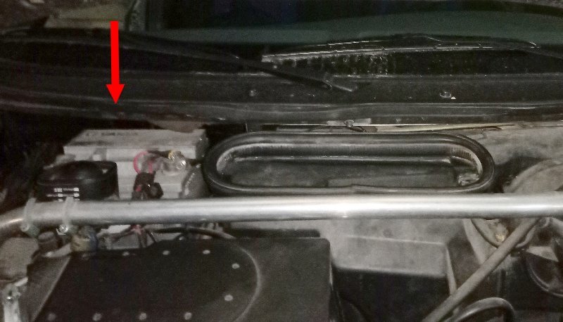

Things are easy when there is no alarm unit and not strut brace, if those 2 exist then it's a nightmare.
I face the same situation every time a change the battery, the strut brace makes me to bent the battery end pull it out forcing a bit the black plastic cover of the wind shield wipers (red arrow).

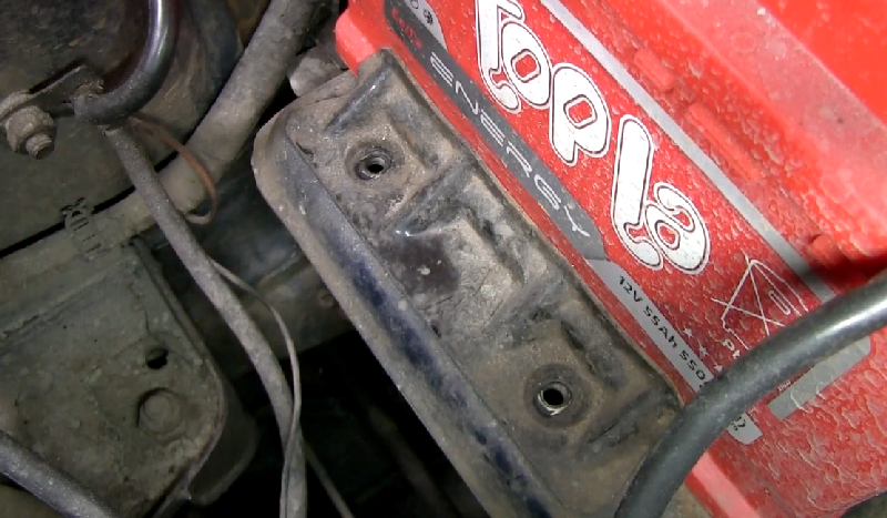

Another 2 issues are:
1) The battery is not very stable and has some mm tolerance of moving that's why i put a piece of adhesive hard felt for furniture (yellow arrow) long as the battery and in the spot that the battery ''sits'' on it's place and then i tighten the bolts.
Screenshot 2026-06-16 at 10-56-11 1997 Skoda Felicia LXi 1.3L 4 Cyl._Battery Replace.mp4.png
Then the bracket holds the battery more steady.
2) After so many screw-unscrew efforts the thread starts showing signs of wear (blue arrow) so in the next time i had to make a small repair on this.
